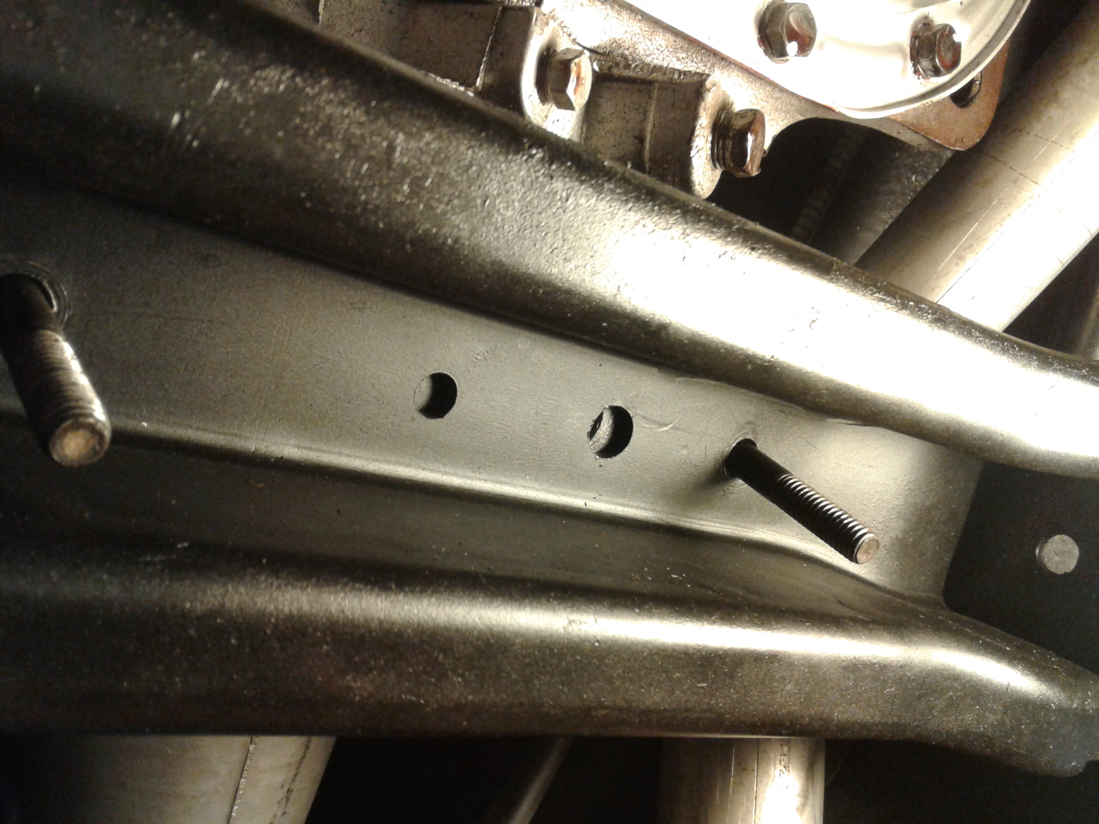

Some tips when it's necessary to replace your oil pump without pulling the engine. READ THE SERVICE MANUAL AND PAY ATTENTION TO WHAT IT SAYS. I glanced thru it and then did it my way. (Wrong) I took the front u joint off but I don't think it's necessary. Remove the two bolts on the transmission mount and insert two long 3" bolts in the holes to keep it from moving to far back or forward. Take exhaust flange nuts off the manifold studs, take the nuts and washers off the motor mounts. I removed the radiator so l could get the fan off. The fan was so close to the radiator it would have hit the radiator when l raised the front of the engine. Drop the steering link. I did this on my lift so I used my tall screw jack with a 6" long piece of 4 x 4 placed under the crank pulley to lift the front of the engine. You can rent one or buy one at Harbour Freight, Lift the engine enough to get the rubber mounts out of the housings then place 2 inch, l said 2" thick wood blocks between the round metal mount housing and the bracket on the engine then lower the engine. That gives you ample clearance to get the pan off. When installing the new pump make sure the collar at the base of the pump shaft is seated all the way into the hole in the main bearing cap. Refer to utube. I made a pump priming tool out of a 3/8 x 16" ratchet extension that I can power with Yvonne's new drill motor l got her for Christmas. More to follow.

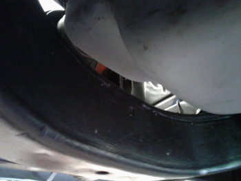

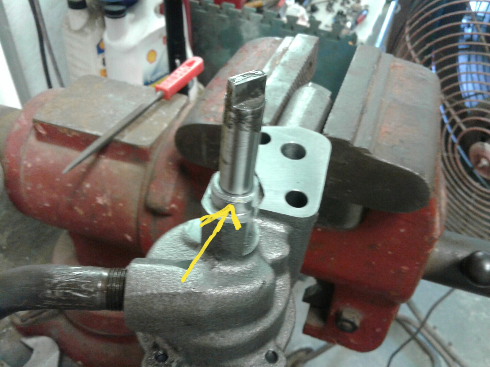

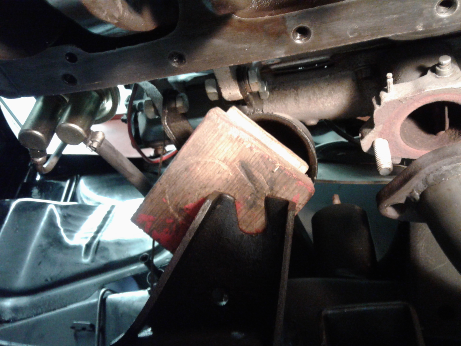

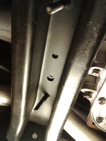

All the pictures have comments. Before installing the pump l inserted the pump drive and distributor to make sure everything stayed in place when l installed the pump. I was concerned because the previous pump failure was caused by the drive end of the shaft wearing/breaking on the top half of the oil pump shaft male flat only. Then l installed the pump and the pan. Next l will fill the pan with oil remove the pump drive, distributor and valve covers then using my home made priming tool and Yvonne's drill motor to pump oil throughout the engine. Next l will lower the engine in place, button everything up and give it a go.
This I'd the collar that fits in the hole in the main bearing cap. I had to file and sand it to fit in the hole.

2" wood block inserted in motor mount bracket. Same on other side.
Two long bolts in transmission mount to keep the whole mess in place.
Plenty of clearance to get the pan out and in.
Another view of the clearance.
