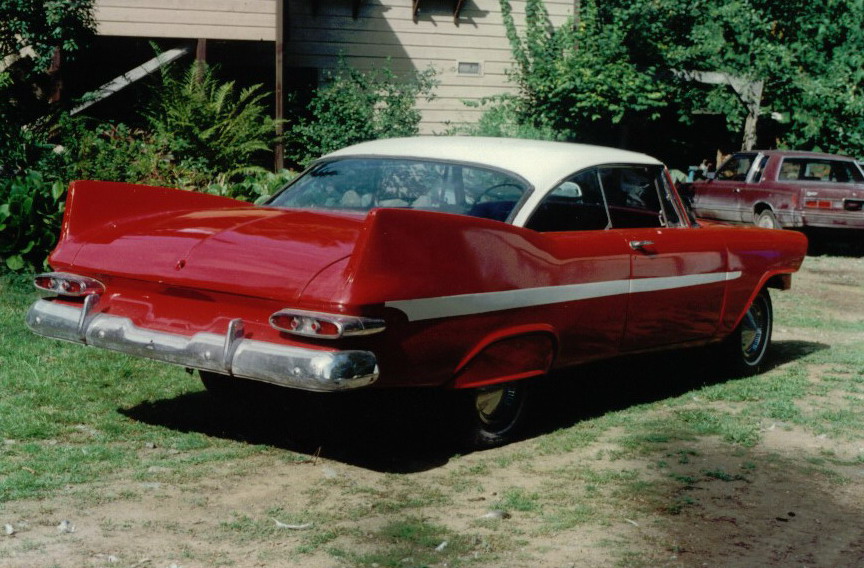

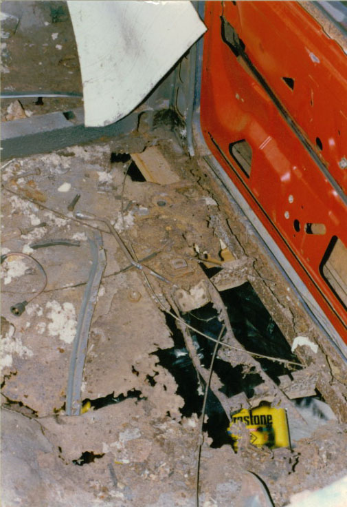

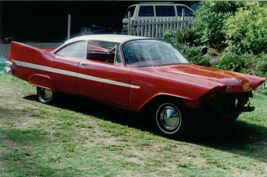

Here is what she looked like when I got her,minus the inch of needles from one end to the other...
Not particularily looking for a project, while mucking through a local junkyard a friend of mine told me to go over to the fence and look at the neat old car in the guy's yard. Well the guy's yard happened to be the local drive in. After finding the owner of the property and having a look over the car I asked him how much he wanted for it (sound familiar?!). He told me that if I wanted it I had to take the whole thing, not just pieces off it. Need I say more...
He was using it for a dog house, there were no seats, no floors, but the rest of it was still pretty solid, and it still had 4 original hubcaps on it.
I stored the old buggy away and started keeping my eyes open for parts... Surprise, surprise -- easier said than done. The original drive train was a seized up L head and 3 speed column, that had to go. As luck would have it, I found a 57 plymouth that was to be scrapped and it had a worthy drivetrain -- 318, torqueflite tranny and another frame so I didn't have to mess around with welding motor mounts in. I'm still in need of a better front window, better fenders and gas tank.

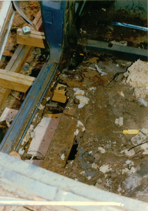

I did up most of the body work many years ago but now I have had more experience in body work. I am redoing things to make them better. I have no regrets of doing this, it has probably held the old buggy together this long.

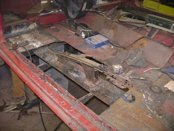

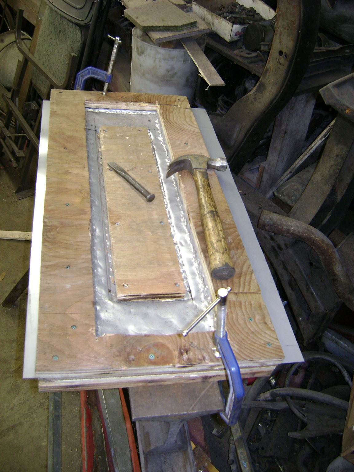

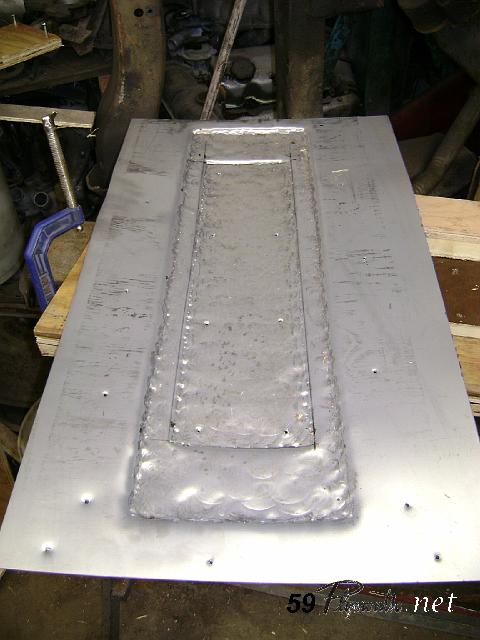

I constructed a home made jig for floor pans,excellent way to vent frustrations.
First, sandwich a piece of metal between boards then beat the $#!! out of it. Place piece of metal back on anvil to iron out any other lumps.

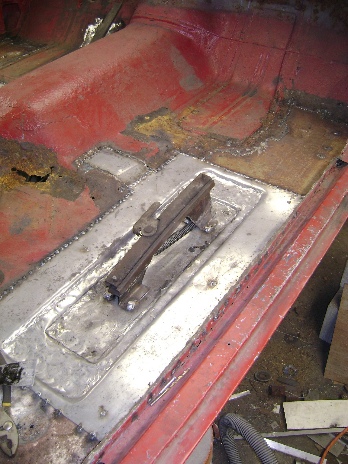

The floors are almost done on the top side -- progress, finally.

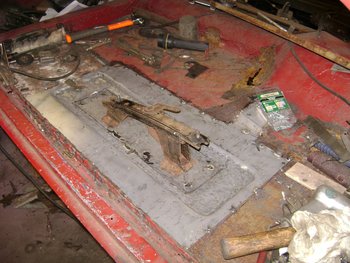

Getting closer to start under coating. Hooray!
Done with floors! All handcrafted -- now it doesn't feel like something Fred Flintstone would own.
