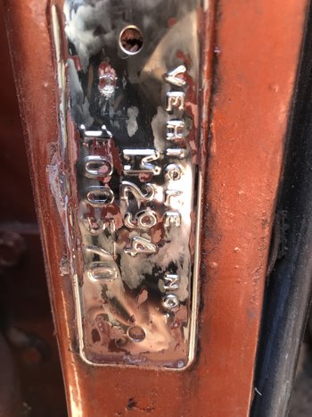

Door Jam Plate: M294 100570 M = 1959/ 2 = Plymouth/ 9 = Sport Fury/ 4 = Los Angeles/ 100570 = Sequential production serial number #570 car built in the L.A. plant for ’59.

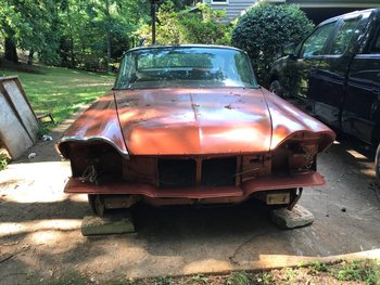

Dan, thanks for posting! I am sure Matthew Keij will have plenty to add when he sees this post (he's 6 hours ahead of us in the Netherlands). Your Sport Fury seems to be in reasonable shape, apart from a few dings here and there - how's the paint? Please post more pix! And, welcome to the Forum.

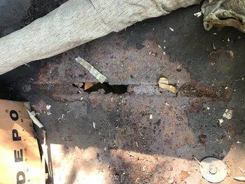

The body and frame of the car appear to be essentially rust free (except for the trunk - a pretty good size hole) and there are no major bashes to any of the body panels. In the pictures the body looks dinged up, but that is just crud falling from the oak tree its parked under. The junk falls faster than I can wash it off. The paint is pretty bad. Not that the paint has runs in it, but overspray on all sorts areas and not very glossy. I think wet sanding with 1500 or 2000 grit would help. I would have thought it was a home job, but I have a bill where somebody paid 5K for this pitiful work. The good news is the engine runs very strong and most of the bright-work has been re-chromed. When I bought the car it was already in this disassembled state. The tires were rotten and the engine would not turn over with the electric starter (I could rotate the engine with a wrench with the spark plugs out). Now it runs and drives... kinda-sorta. That's where 59Plymouths comes in. Like everybody with an old car, I wanted to see if the engine was original. If it had casting numbers showing it was from another year it wouldn't have mattered to me. Since all the casting and stamped numbers corresponded to a 59, I was curious if there was a way to verify if it was original or if it just happened to come from another 59 vehicle.

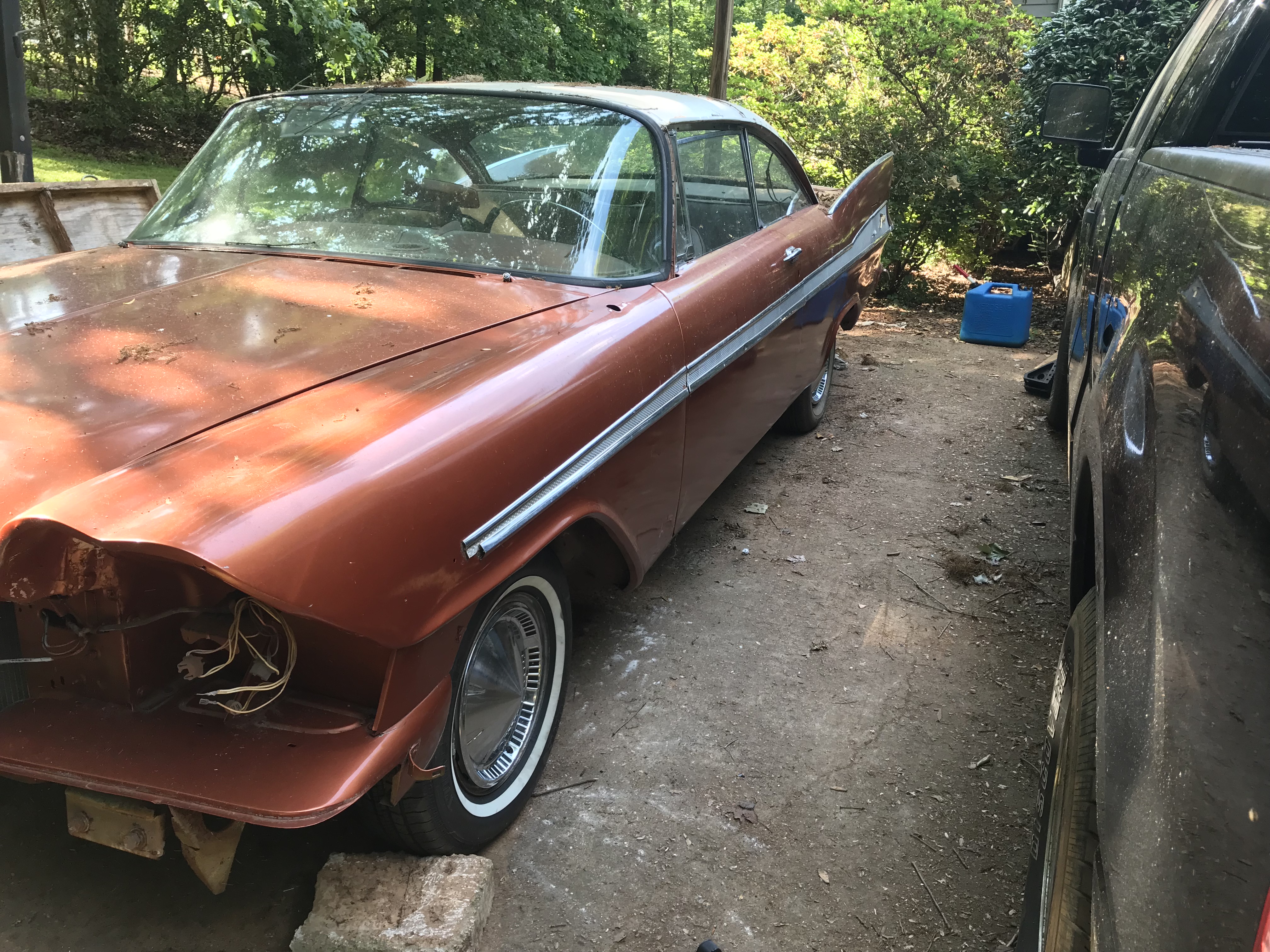

I spy a deluxe drivers side mirror, does it have the matching passenger side mirror?
Also I see it has a radio which was an option, even on the Sport Fury

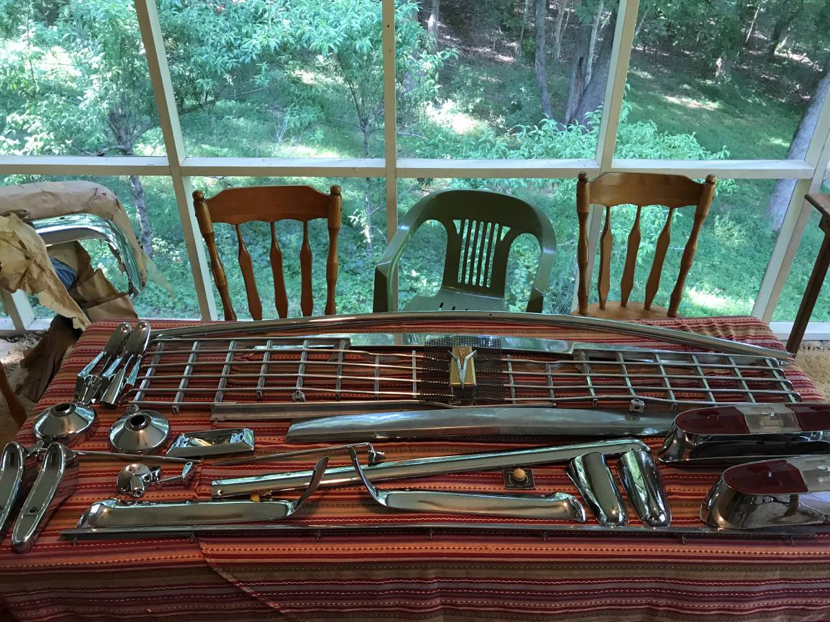

Yep, I does have the dual mirrors. You can see the re-chromed components in the table picture showing the grill.

Attached is the number and build plate. I also attached a picture of the head casting number (under the valve cover) just for reference. I look through the forum and did not see where anyone had posted a head casting number or a picture of one for the 59. Maybe it will help someone confirm/compare sometime in the future.
