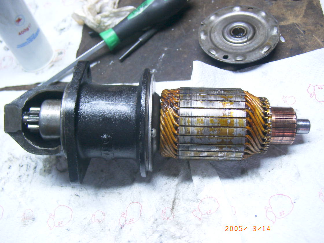

The housing is removed and the spindle slips out.

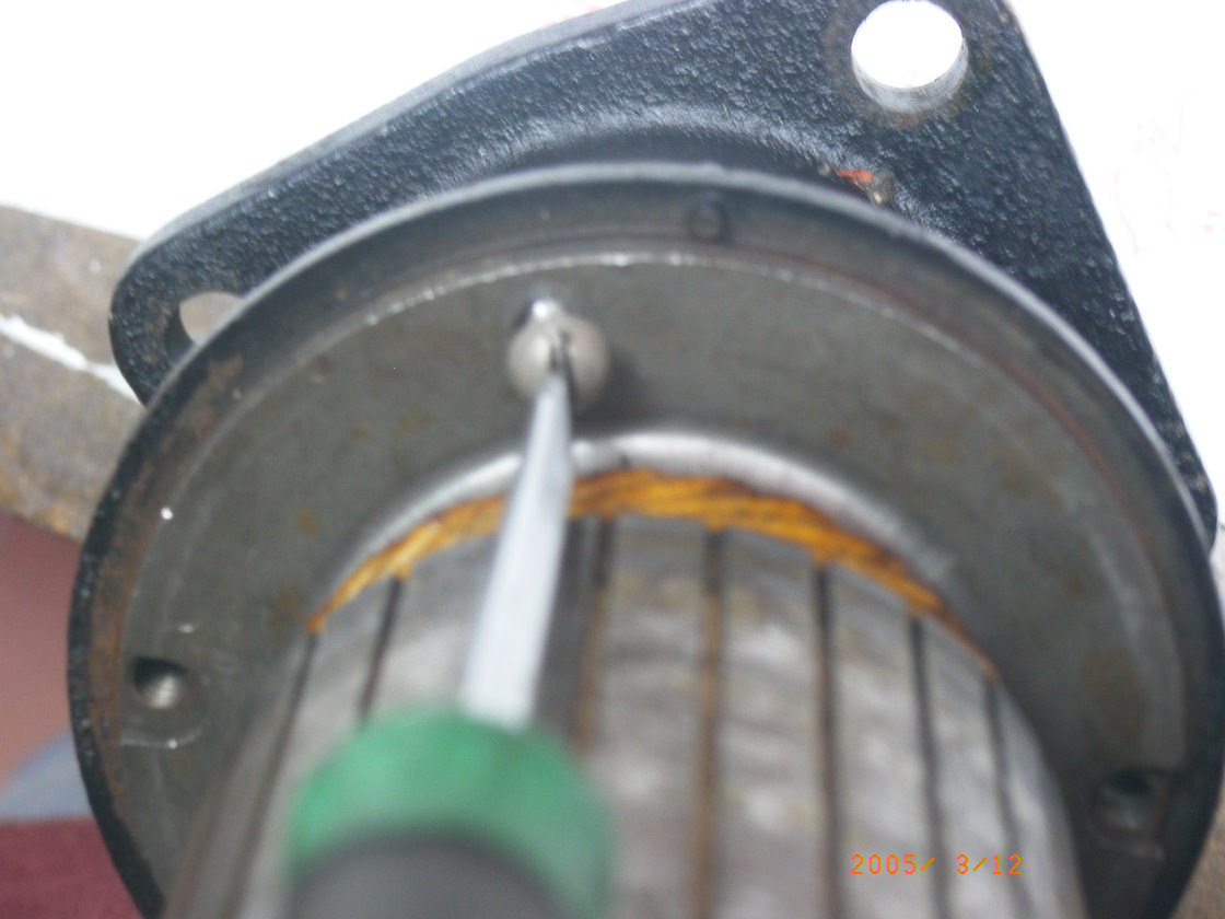

To disassemble the bendix from the head two screws have to be removed…
... then the bendix is free.

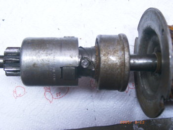

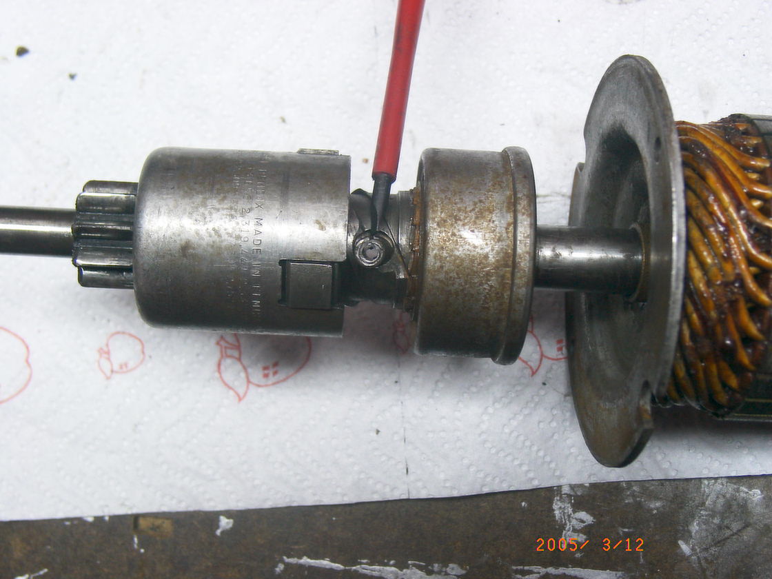

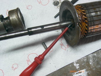

The splint can easily driven out with a punch. Then the bendix unit can be removed from the rod.

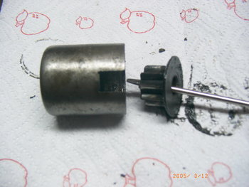

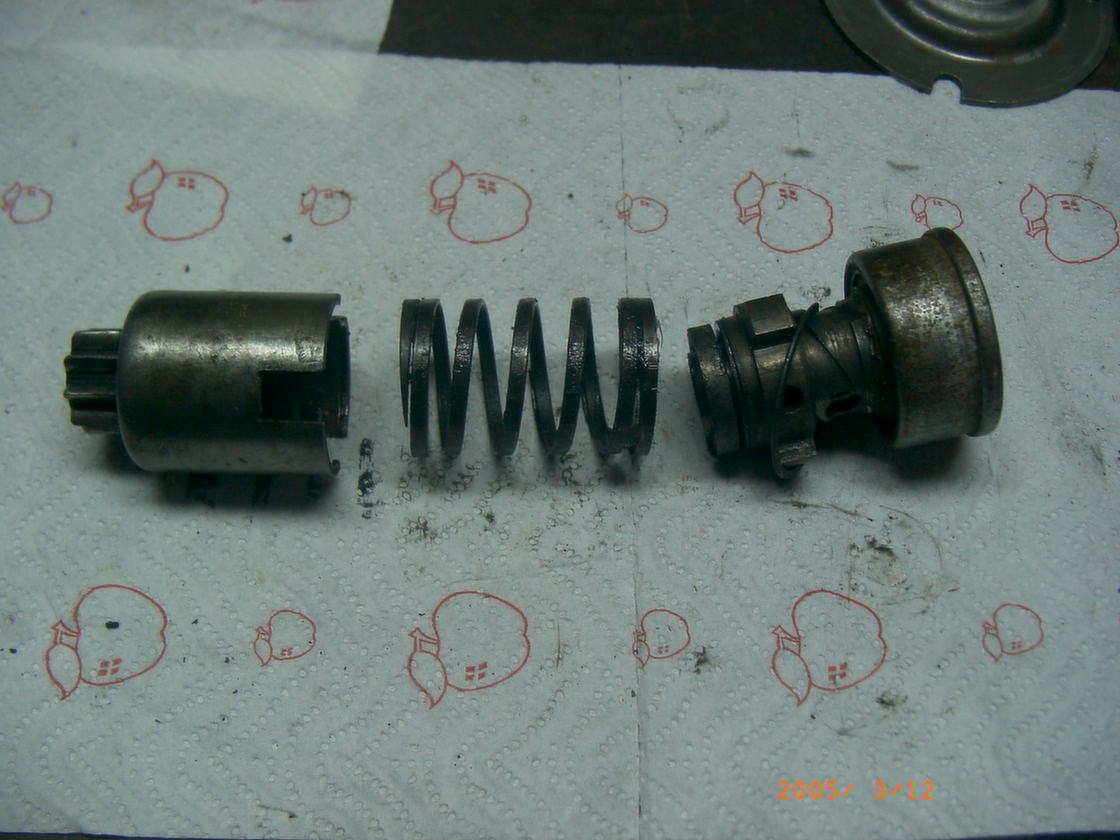

The rear clamp must be pulled back and …

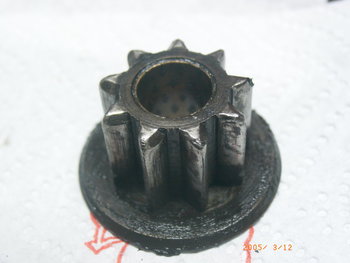

... the starter drive comes out. Check the drive for bad teeth! When reassembling the spring should be greased.
If this disc has a gap, then the bearing is worn out.

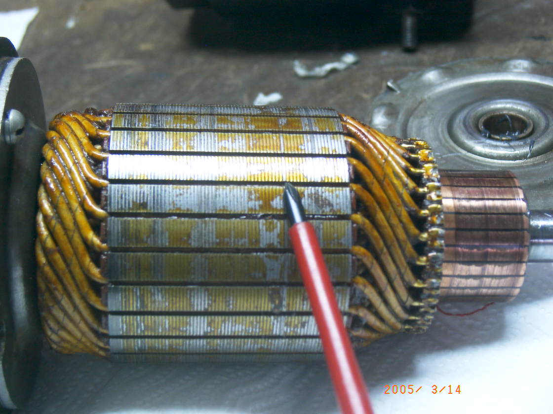

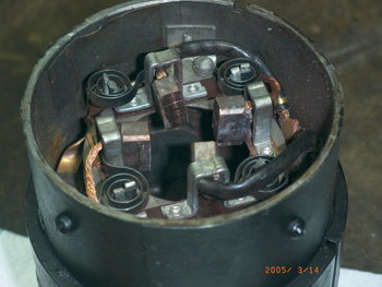

Check the brushes. If necessary, now’s a good time to replace them.
Four screw drivers hold the brushes in position – just another way to assemble the unit with two hands only.

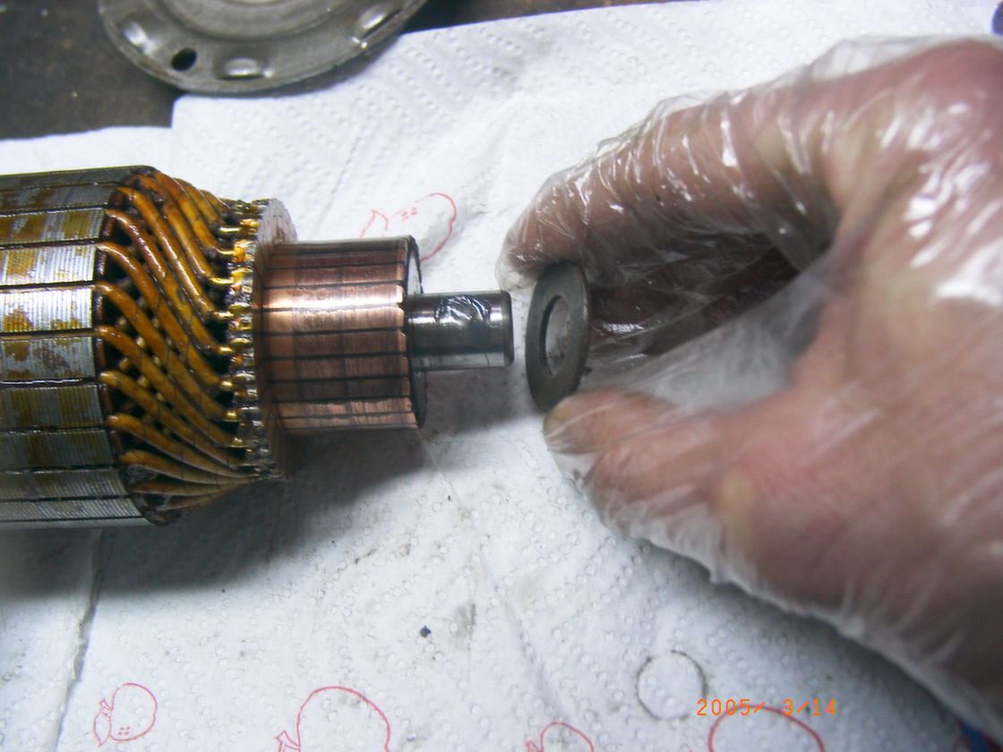

Don’t forget the shim!

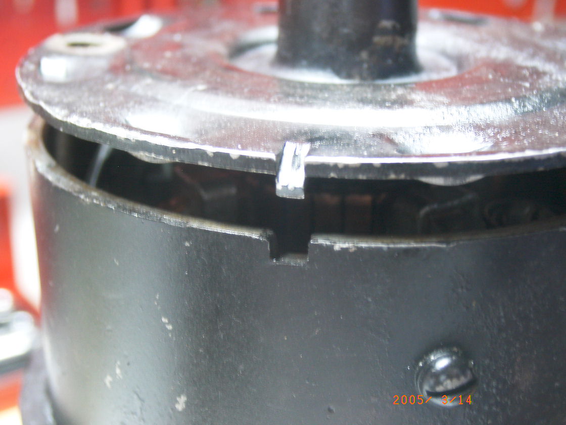

The front of the starter housing slips into a rod on the head ...
... while the backing plate slips into the slot on the housing – no way to fail.
