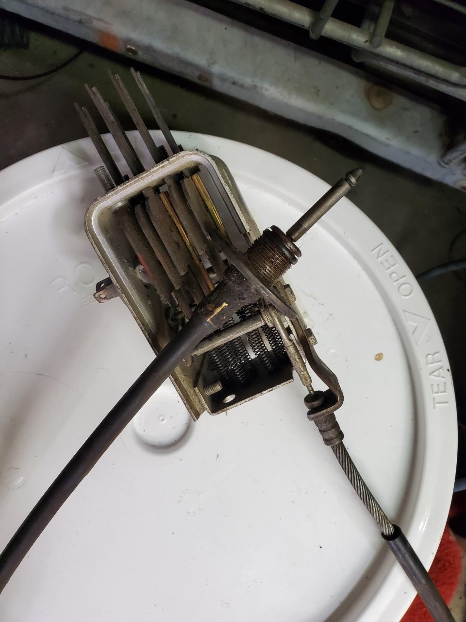

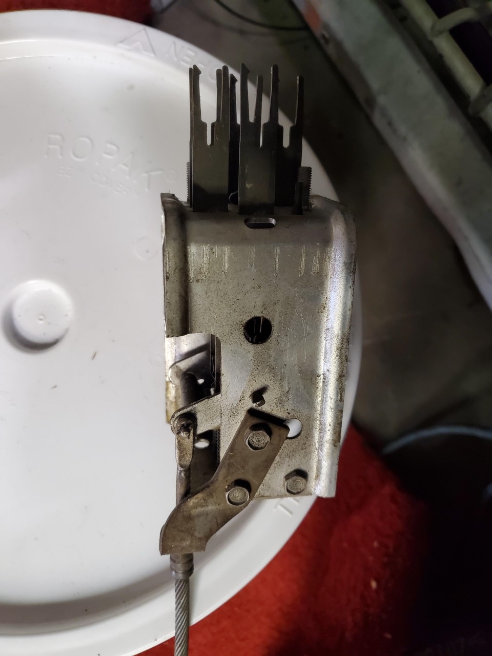

I feel the cable some how came has come loose from one end or the other. I just worked on a pushbutton controlled Torqueflite last Thursday and the cable came loose from the bracket that holds the cable to the selector control box. Just years of use had worn the end of the steel bracket. Crimped it back onto the cable and it operated correctly again. There is also a little E clip on the pin. Of what you referred to as a plate.
Pictures of selector just like yours.
