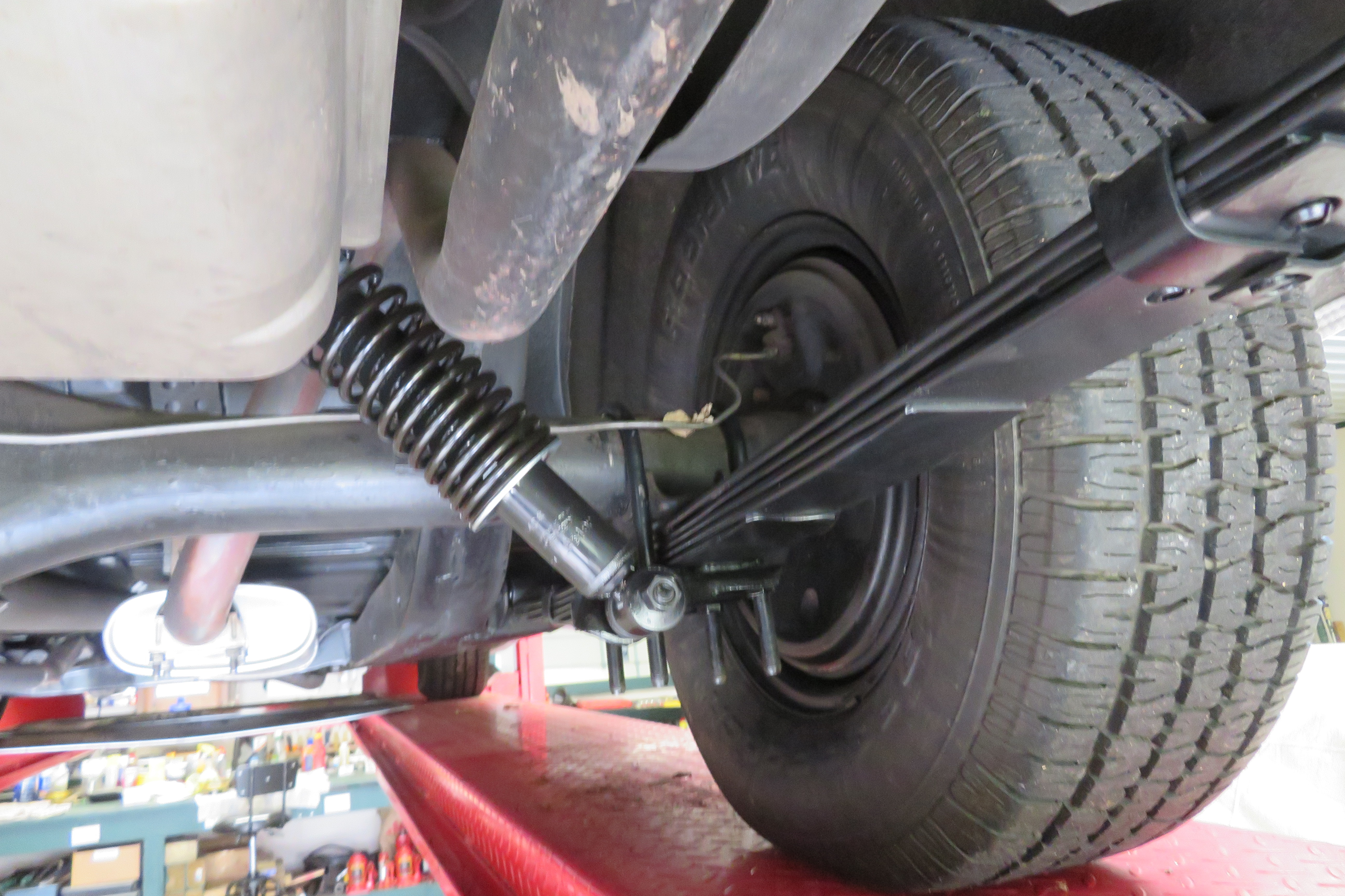

Schlaag, Regarding your original shocks w/o helper springs, you can buy a helper spring kit from NAPA or any parts house and install them on your shocks. I did that on my 60 Desotos original shocks and it made a huge difference. It would bottom out with two passengers in the rear but not anymore.
Posts: 2218
Re: Ride height
60 Desoto with helper spring kit installed on shocks.
