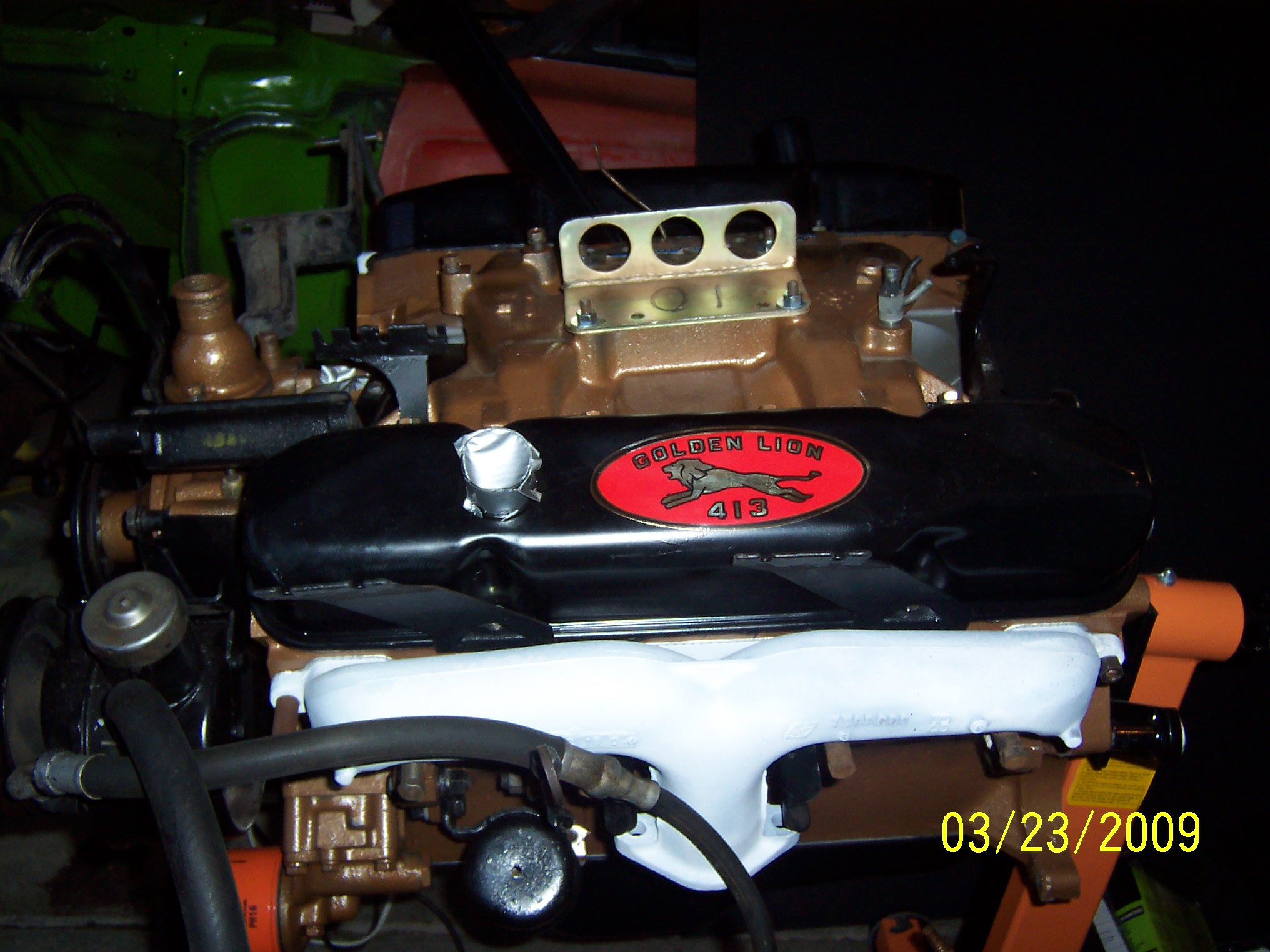

Guys, here is a couple dark pictures of my 413-4bbl RB I am detailing right now, hard part is trying to remember where the brackets go and such, then I can clean them up, paint them and install. Still have a few more to do. The brackets still show some of Mother Mopars part numbers stenciled on them while others are cast in to the piece. These brackets came on my 1960 motor and was an earlier model year car. Later versions had to AC unit above the Power Steering pump.
No diagrams available on the unique AC bracket arrangement in the manual and somehow the pictures I took before disassembly have disappeared. With the AC compressor way off to the area where the Generator/Alt usually goes, I don't need a 90 degree themostate housing to kick it over to the passenger side and then forward to the radiator area. I can use this straight up style or the 45 degree version. Will decide when I get the radiatior hose to see what fits best.
Hope the pictures are not to dark for all to see. I should have taken some in the daylight this past weekend when it was warm out. If I can get home earlier on Tuesday, I will take some in the sunlight.
Don't worry about the white exhaust manifolds, they are in a rust preventive primer till I paint them in a Eastwood high temp cast iron color. The passenger side exhaust maniford had the extension cut off (factory done)to allow the AC unit to ride in that area. I will run the underdash unit for now, but hope to upgrade all parts to Factory Heater/AC box look with proper controls.

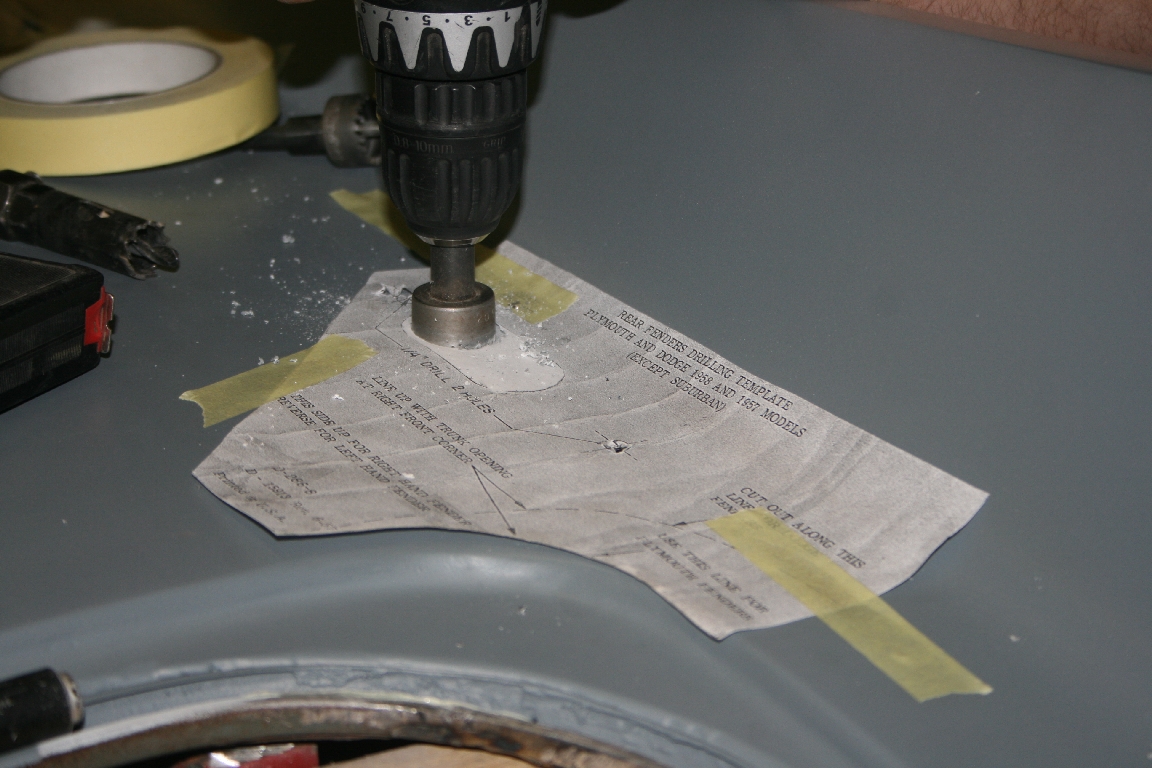

Good work Ron! I follow your work in progress, but still it hurts to see the guy drilling a hole in the metal. I also have this template taped on my trunk but didn’t find the courage to drill – yet. I’d like to see pictures when the antennas are installed.

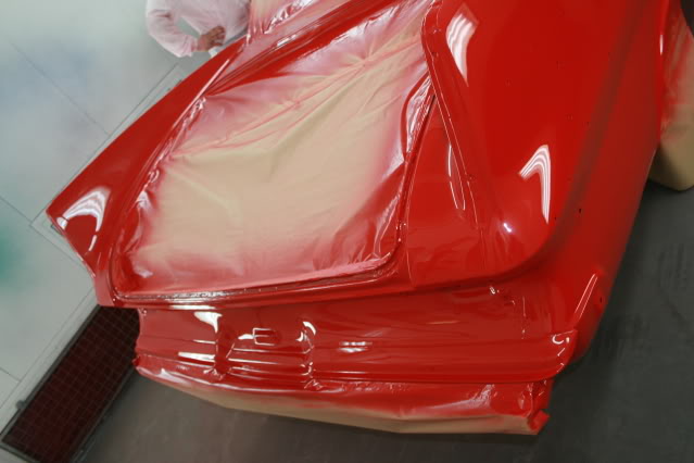

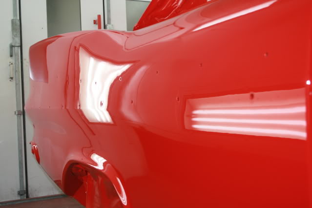

The 2 are from 2 days ago, the rocker mouldings were placed correctly this time.
