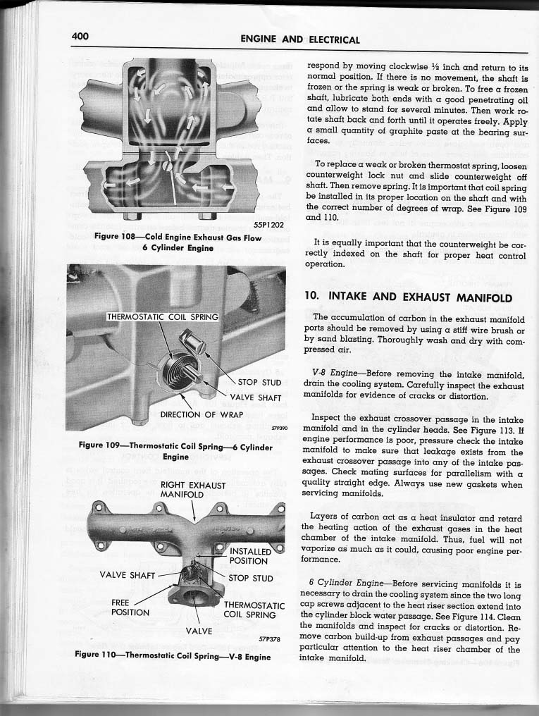

Roger points out this page from the shop manual, regarding the utility of the cross-over for preheating the fuel...
Shop Manual wrote:Layers of carbon act as a heat insulator and retard the heating action of the exhaust gases in the heat chamber of the intake manifold. Thus, fuel will not vaporize as much as it could, causing poor engine performance.

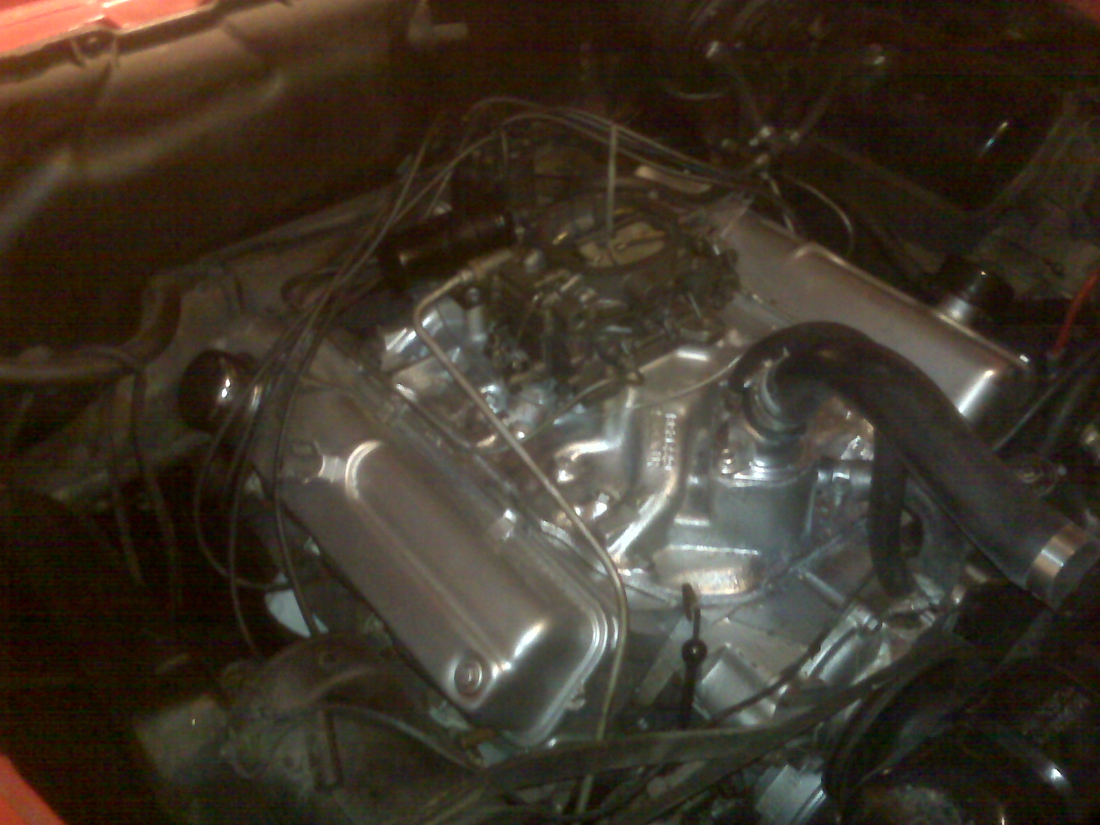

Re: Replacing intake manifold gaskets
All back together! Not that I'm not dripping in sweat... But all the hoses are reconnected, the carb and distributor locked down, the manifold paint touched up. Ready to fire up some night this week!
Remarkable, though, that in the week's time of just sitting there, many of the bolts needed retorqueing. If these composite gaskets don't leak -- I will sing their praises! But they do require attention -- and I will give it to them, until we're all burned in.
I fired up Faulkner tonight -- let the 318 get good and warm, and then let it cool down. Ran smooth as silk! Best part...
...no leaks! And, not the least sign of antifreeze on the dipstick.
Now, to torque-test the bolts again this weekend, and take Faulkner out for a road test; check the bolts one more time, and we'll be road worthy! Thanks, Ed Eckerson, for your brilliant suggestions.
It's sweltering here in Philly, and Faulkner got nice and warmed up, cruising the environs in University City.
...and with no leaks!
Thus ends the saga.
