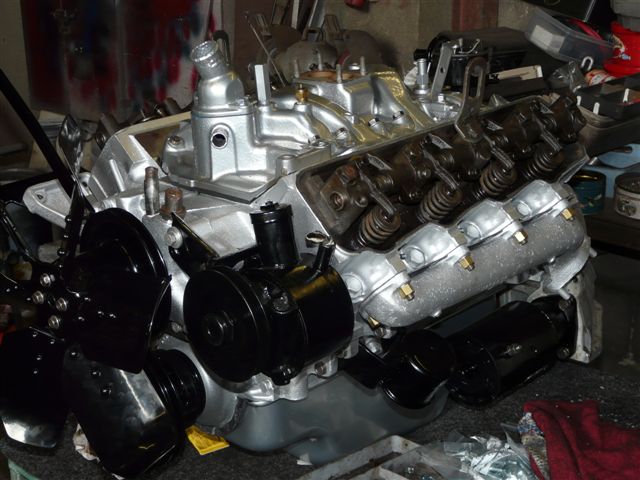

Thought I'd share this with the forum. My cry for help in a previous posting was referred to. This is as far as I've got. For info I've cleaned the transmission and bell housing and leaving them with the metal finish - no paint. My engine (318) started out blue, I'm pleased with the result so far. Valve covers not yet fitted but are the same silver as the sump. Guy

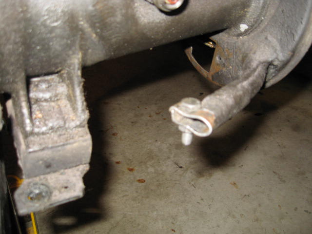

Wow!! Looks great!!!!! I can see what mine will look like.Is the oil pan and valve covers the silver argent? I have alot of the engine area cleaned up and am going to paint that as well [black] after I re-do the suspension and steering components.I was also going to leave the tranny as is,got it all cleaned up and is getting rebuilt,has the usual,bad bands,clutches,shaft o rings[petrified].Thanks for the pic!!!!!!!!! p.s. I am still confused about a possible missing part that I think goes into the e-brake cable entrance, I was cleaning it up and a small tubular piece of rubber came out. THANKS MARK

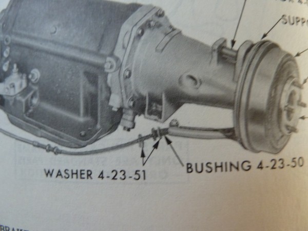

I believe the picture out of the Parts Book is the one I sent you.
Yes, you are missing that threaded tube w/ nut, which can take up some slack in the cable sheathing.

Thanks Roger; I am having trouble finding one,I'll probably make one,3 or 4 inches long? Mark

Hi Mark - You may be able to find the parts you need at: Len Dawson Deception Pass Auto Parts. www.dpmotorparts.com. I needed a special bolt for my tranmission that broke off during the rebuild and he had it. In your picture above it's that bolt you see all by it's lonesome just above the long ridge, the tranny takes two of them. It's amazing the parts he has for our cars. You can do a part number search and have your answer immediatly.

Hi again- I studied Dick's reply for a while- I think he is saying there are two adjusters, one nestles (into a rubber sleeve,as I recall, but maybe just a rubber"stop"), part-way into the clamping tube protruding from the e-brake, and then there's one in-line, back up the cable a ways.The latter came as part of the factory cable. Have you contacted John Fowlie in California concerning these parts? He is reachable by phone and e-mail.
Unless things have changed, Len Dawson does not take phone calls or do e-mail. He DOES have an huge collection of NOS parts (I saw his warehouse here in Washington State).
Correct me if I'm wrong; Len requires you to send a SASE w/ Mopar part # needed-if he has it, he will mail you back a reply w/ price, if he DOESNT have it, he will not reply.
If you need the part number for this adjuster, let us know...we will look up the part number for you. (Somewhere on-line is the entire Parts Book , but I can't remember where to find it).
Sure, you could make the part...maybe try a threaded tube sold as a household lamp part? (although the diameter will be larger than the opening it's supposed to nestle into).

Mark - You need: 1406964, 1406975, 1406976. I checked Len Dawson site and he has the 1406964 at $5.00.
