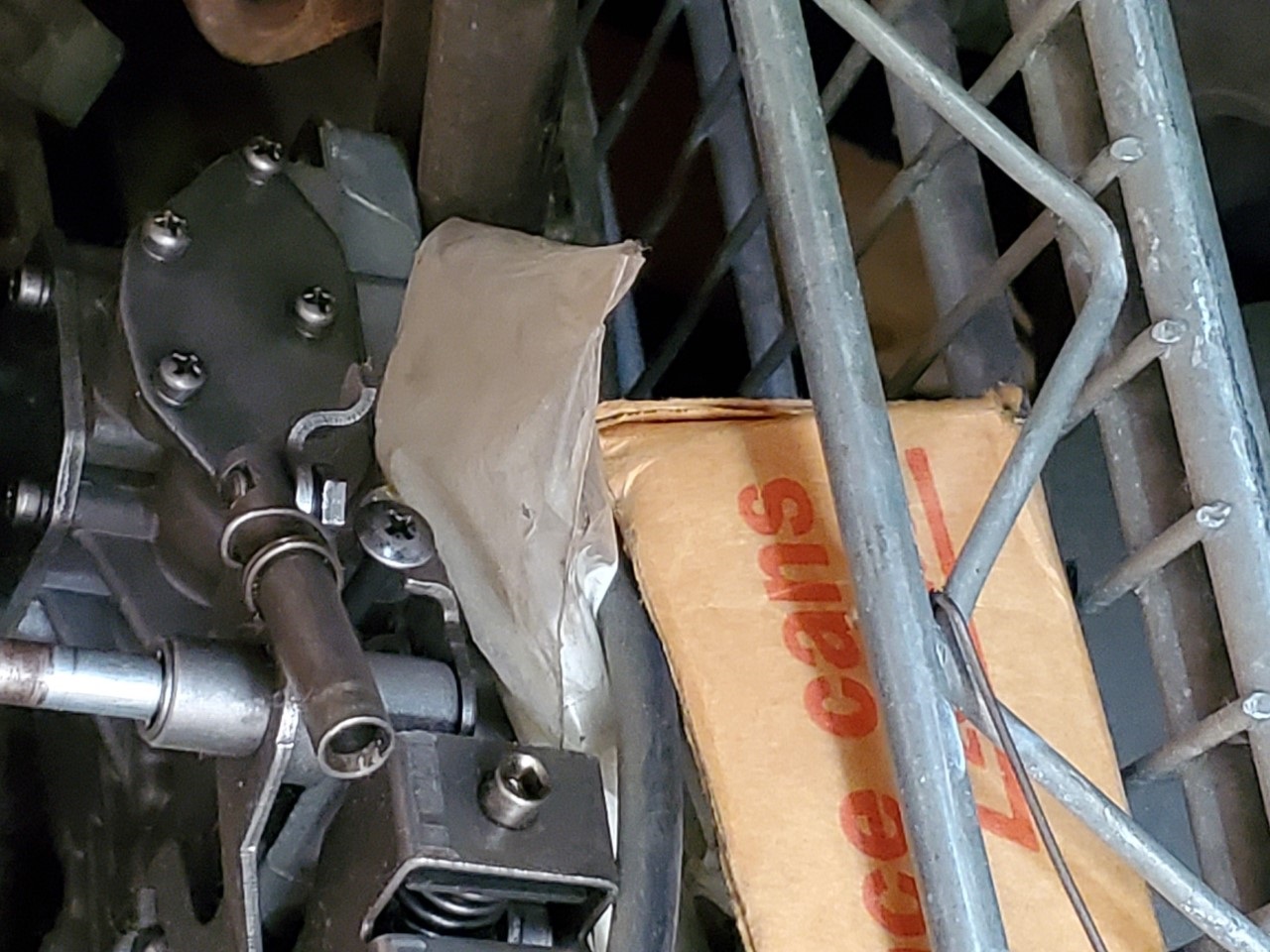

The cable connection was used from 1956 to 1965. I used a pocket screw driver to unclip the 'Hairpin' on the connector to release the 'Shift Cable'.top two are 1956 powerflite but the connection is the same 'Hairpin spring wire'. last picture is 1962 to 1965 showing virtually the same connection.

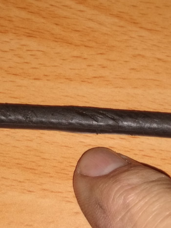

Update: Sheath scarred and cable deformed inside. Looks harmless / prevents changing gears from shifter.
Bizarre failure. Ordering new cable. Epic learning experience since first time inside a tranny although I have installed a couple.

The problem was a pinched cable. She's back on the road tonight! Your help was key. Thank you for the pictures and explanations.

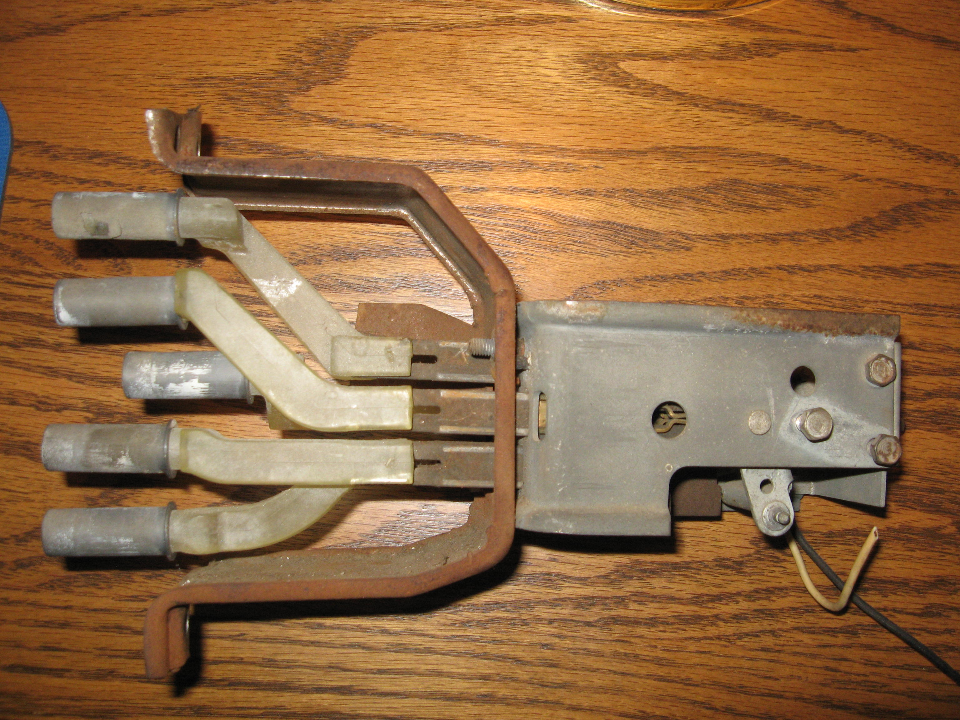

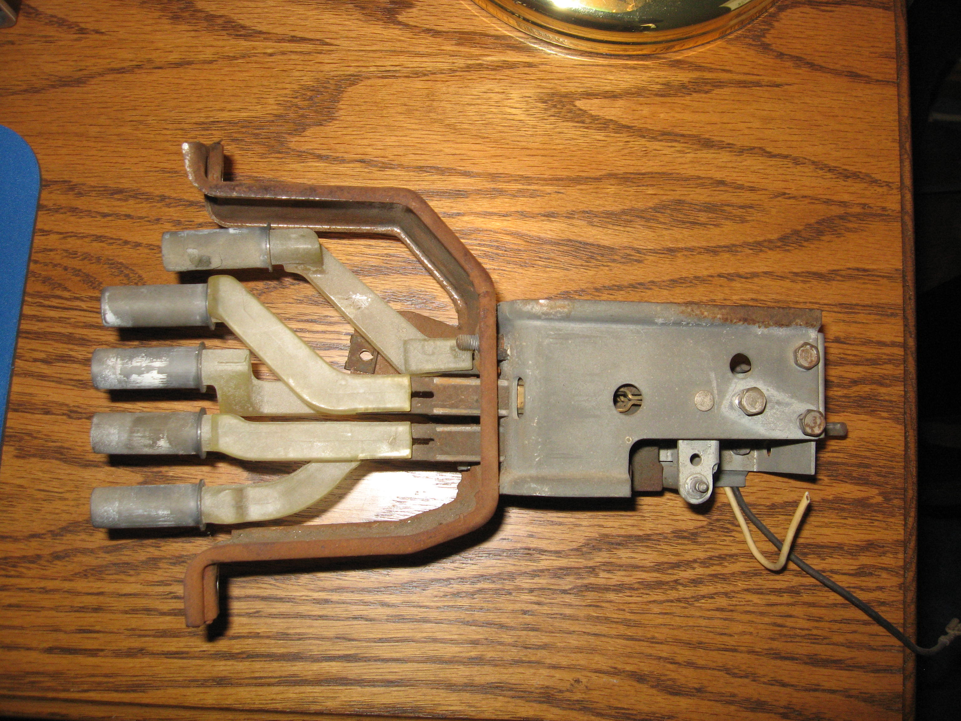

The pics of the shifter and relative cable position were very useful as was the explanation re adjustment. Likewise cable removal from tranny. My tranny is a '60 and the 57 manual with 59 supplements I have are not very helpful. If I can figure out how to post the pics I got in private emails I will. Very handy.
