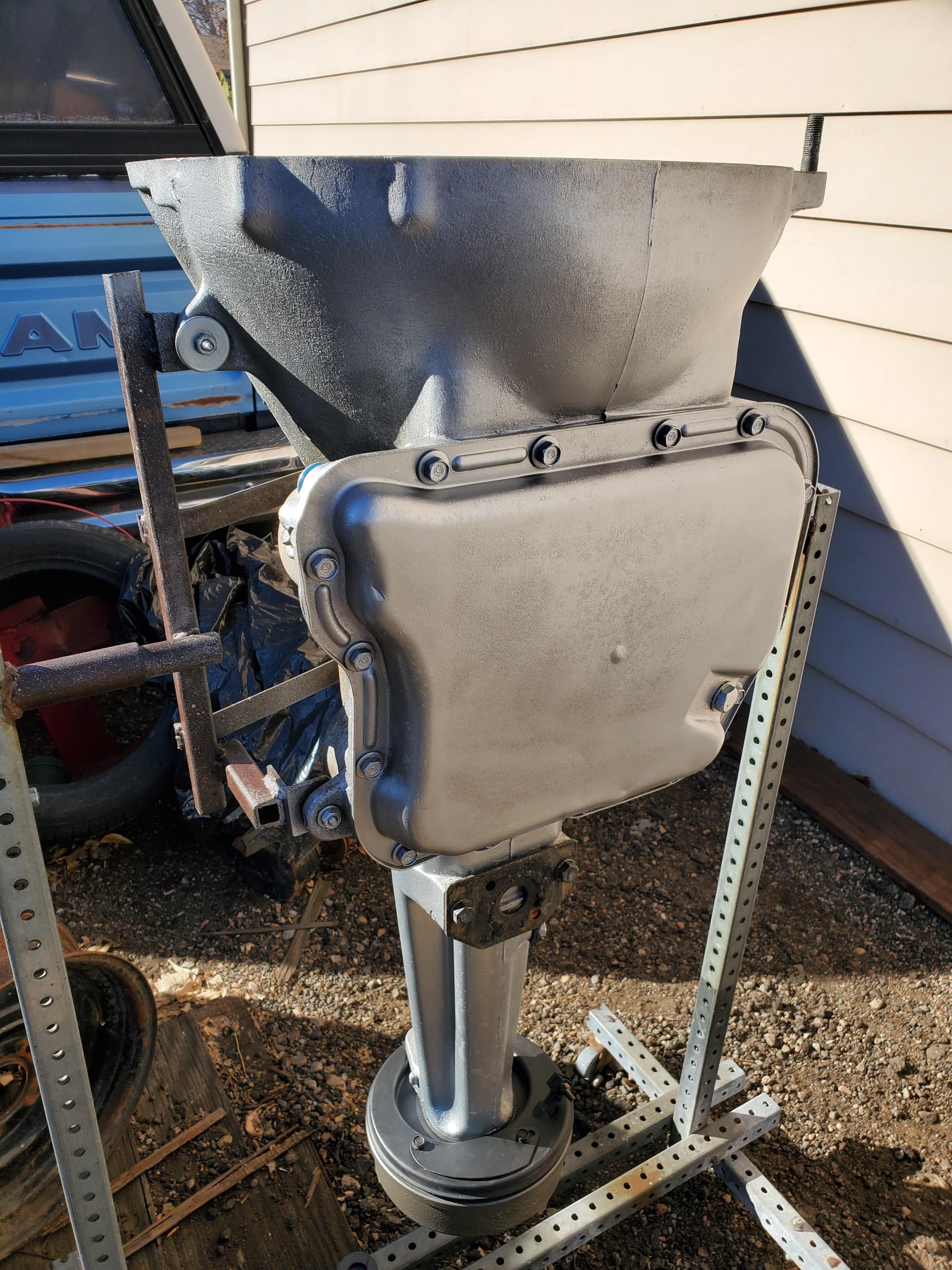

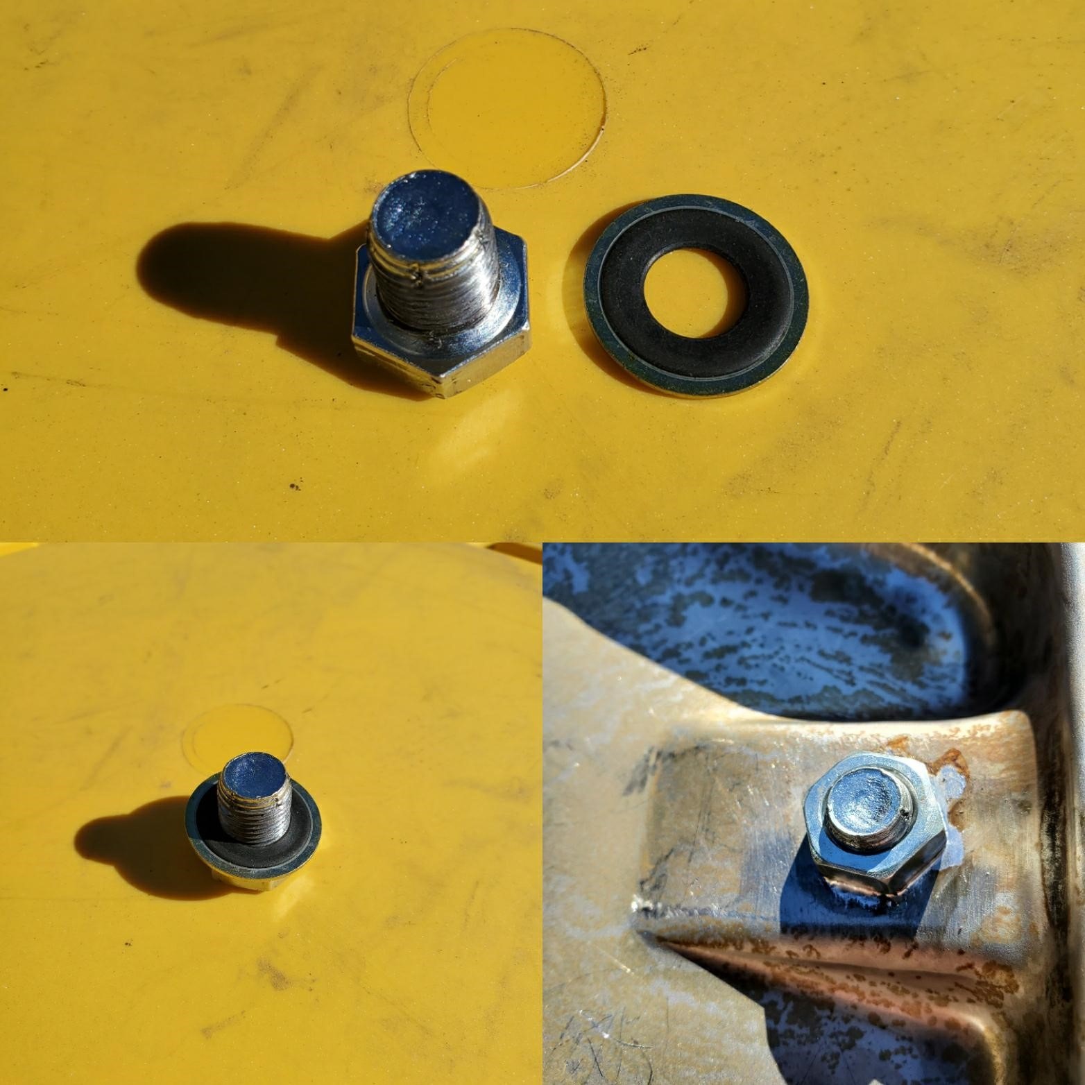

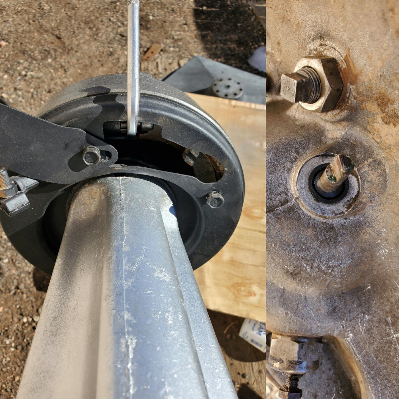

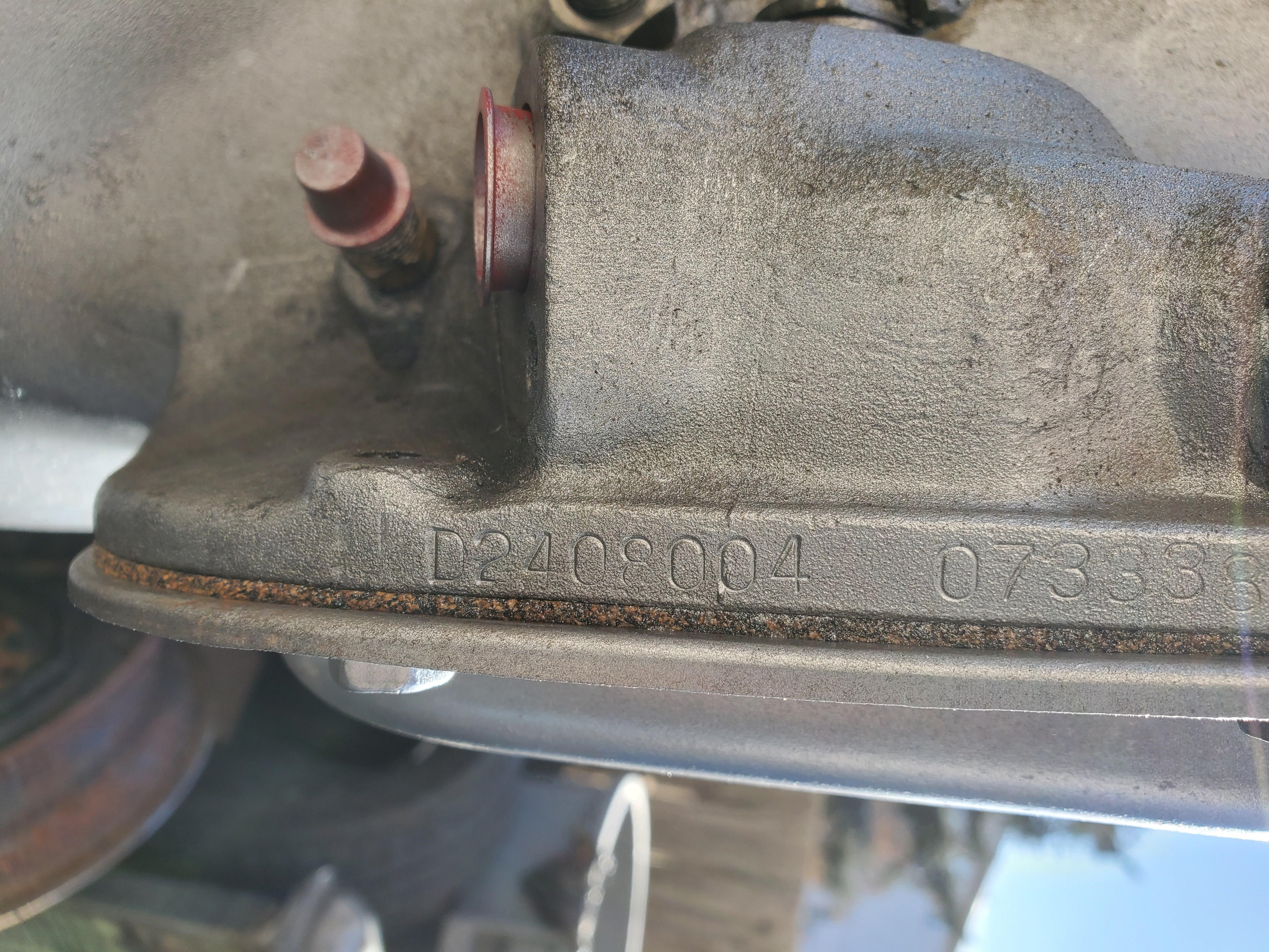

Adjusting E brake, New kick down seal installed from out side, Drain plug installation required silver soldering in lock nut. The transmission is done.

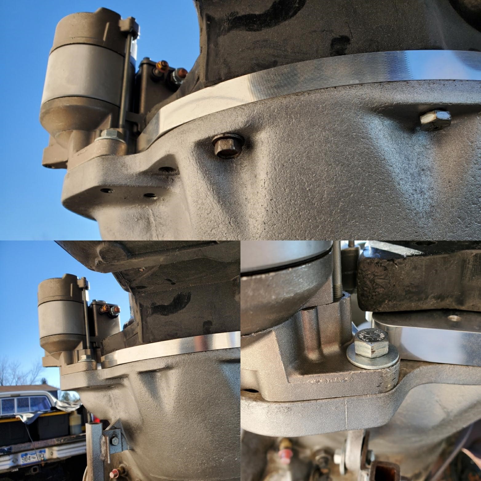

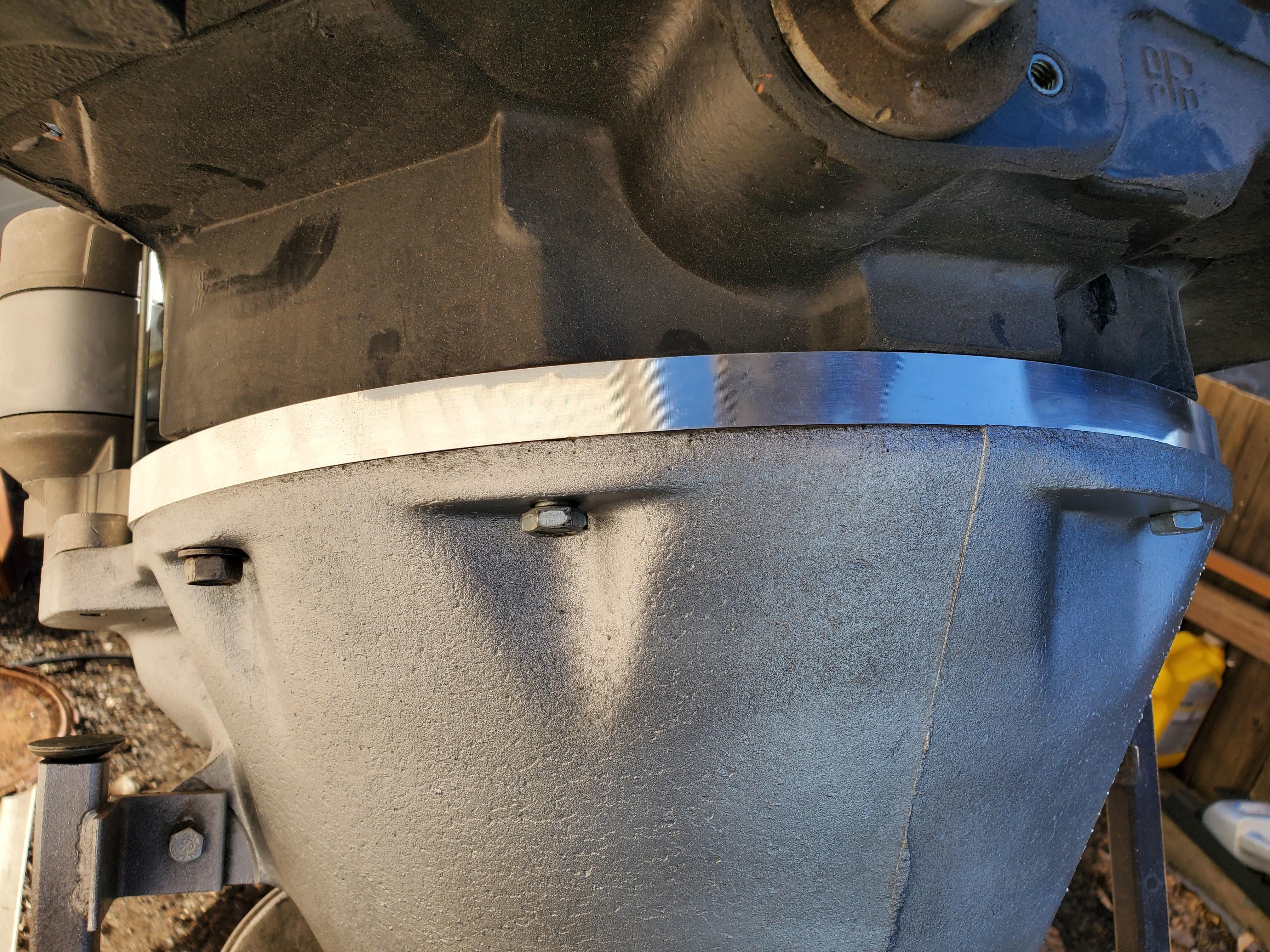

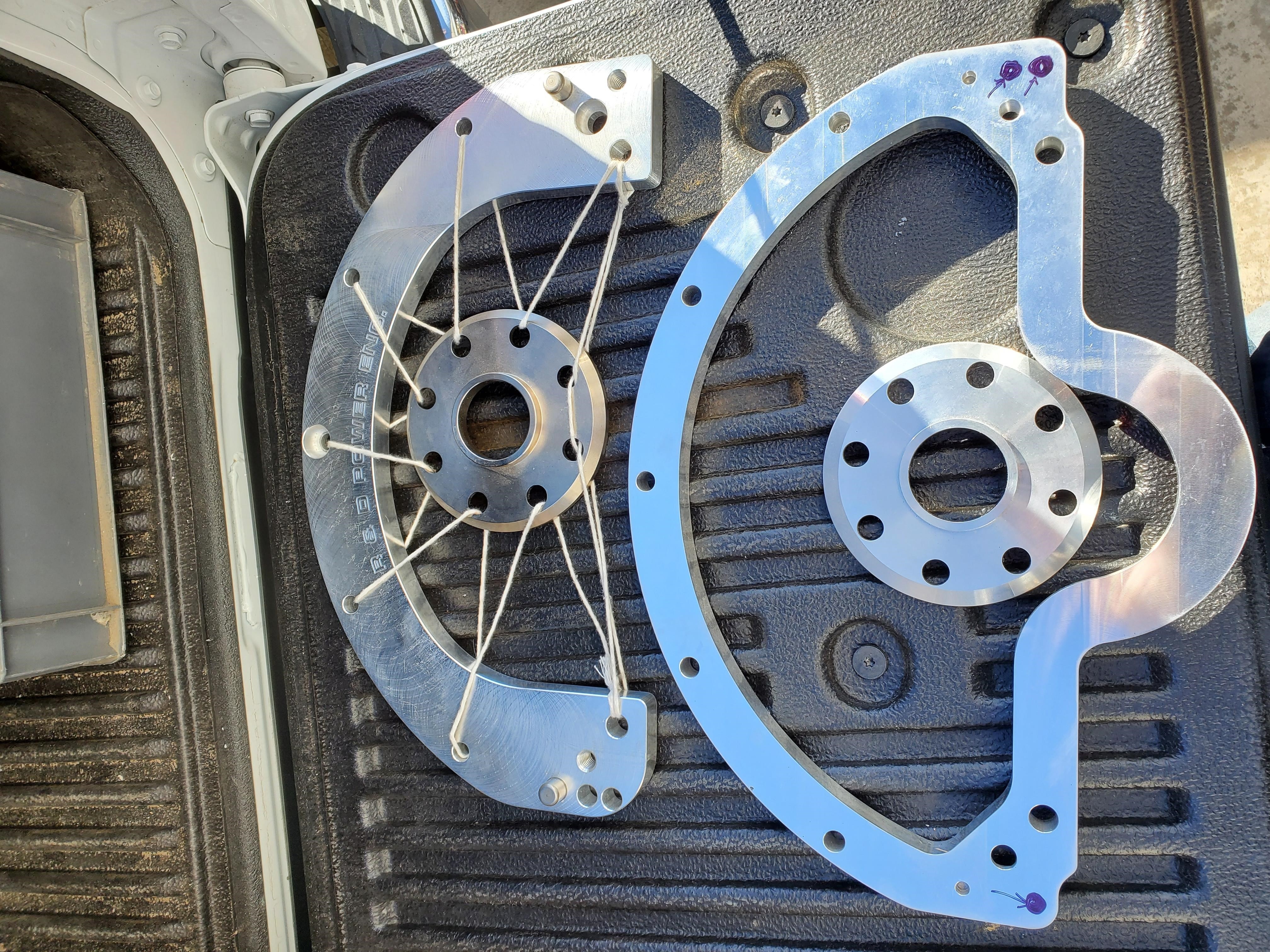

Pictures of engine adapter and modern easy to find high speed starter, Please note the TR waters adapter is missing securing holes? you can drill and add these fairly easily but why were they not included? The R & D power engineering is nicer with a steel crank adapter not an aluminum piece. also easier to dial in. Guess which one I will be using?

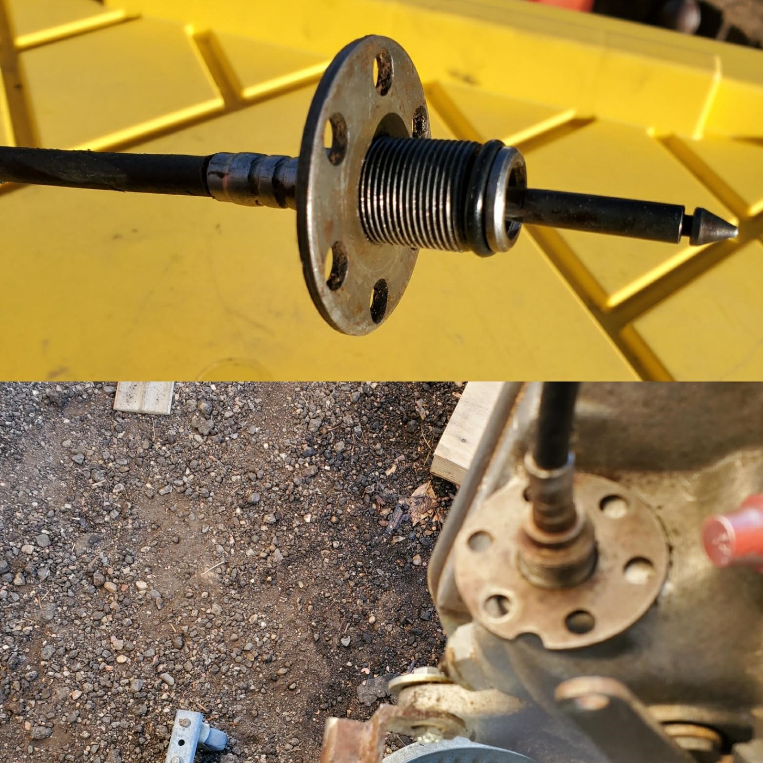

Replace this O ring, or you will have a leak. Anyone for leftovers? With the rooster comb in the center detent, have an assistant hold the drive button in, adjust in the adjustment wheel, secure with screw and test, use a powered test light and make sure your neutral safety is actuated in neutral. you also can watch the rooster comb through the safety switch hole. /b]

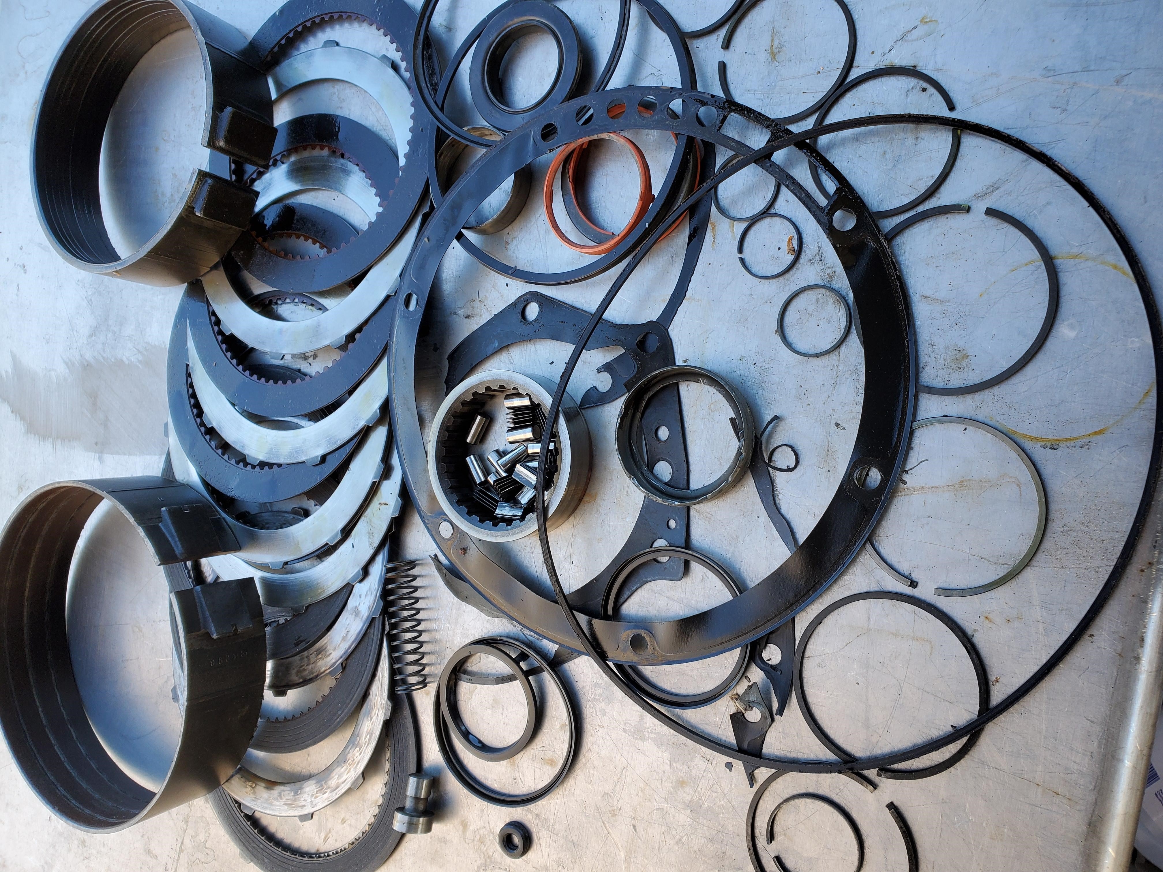

Recap on parts prices on conversion project.
1962 A 727 with E/brake for B engine Core $250.
1963 A 727 for A engine Core $100.
Adapter kit for early A and Hemi engines $400.
Master rebuild kit for A 727 Bushings rings bands etc.$180.
Emergency brake shoes and misc. parts $75.
Torque Convertor rebuild 2200 stall roller thrust $120
Gil Younger TF1 Shift Kit Mild performance $60.
Solvents sealers and paint $25.
Tail housing seal $ 6.
Total parts not including tax $1216 tax here $96.80

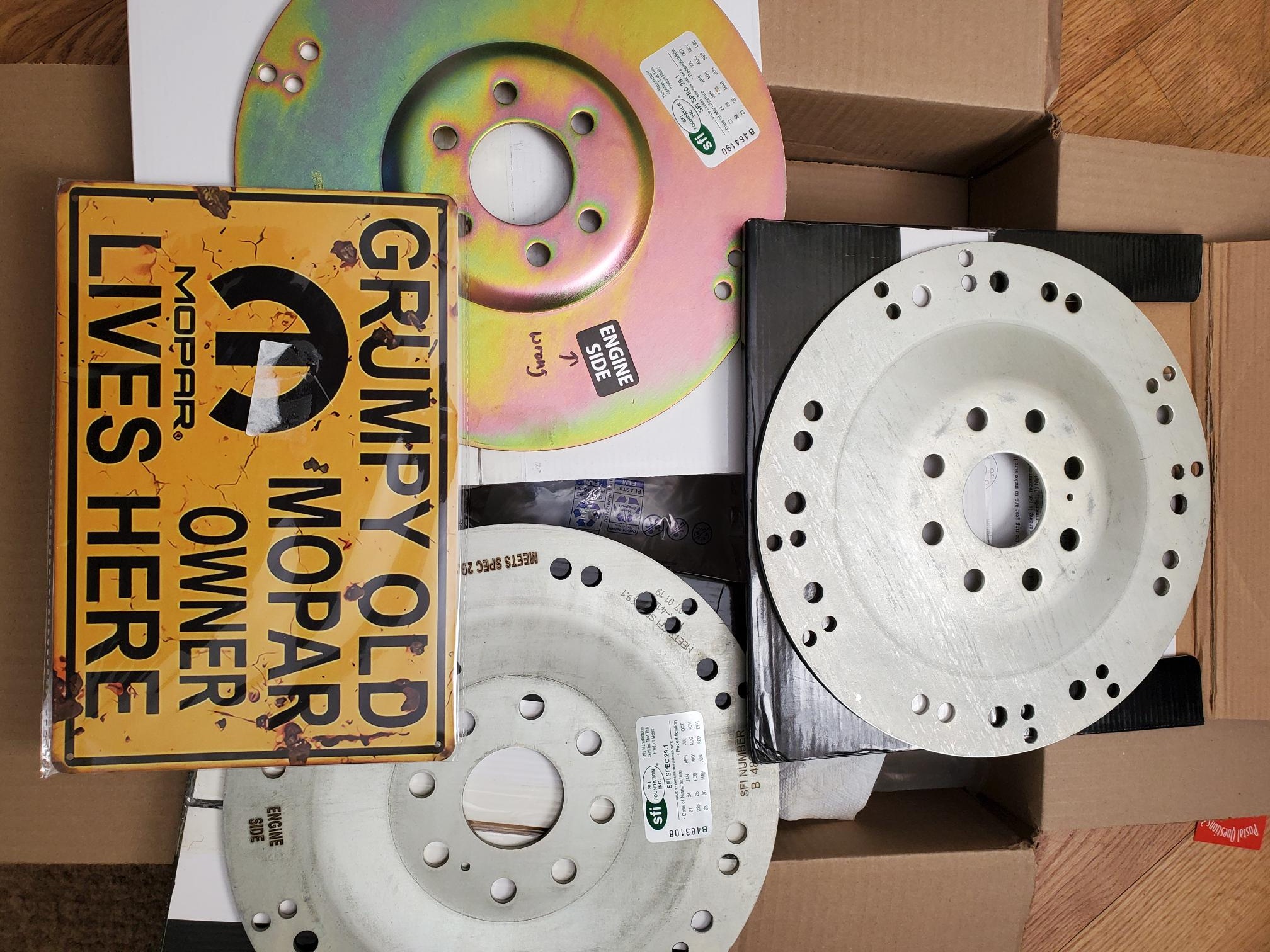

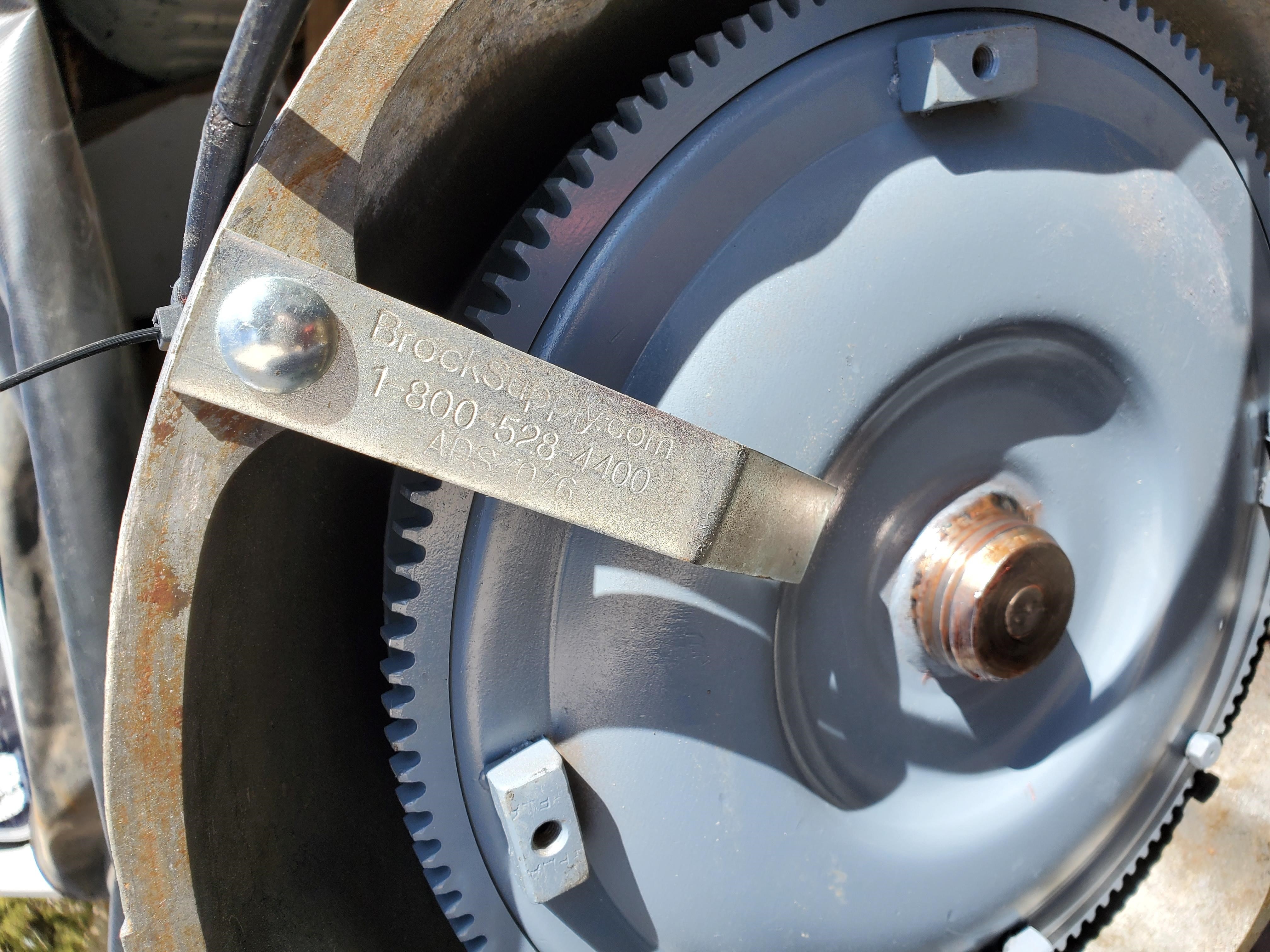

Ordered more performance flex plates, for 727 and 518 automatic transmissions. Still getting the side eye from some of my neighbors, that think I am working on 'nerve gas generators'. Until their transportation leaves them stranded, then all of the sudden I have new friends in need. Pictures are for educational purposes only, not smut, just naked car parts. Rick

Sweeeeet, Rick! Are these flex plates going in transmissions for personal consumption, or are you rebuilding other folks transmissions as an avocation? And shouldn't there be bullet holes in that sign? :twisted:

One plate is for me, others for customers. My sign does have holes in it, this sign is for John Q.

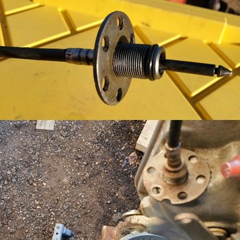

Helping a friend pull a M-6 transmission from a 50 DeSoto, it has the same emergency brake arrangement. So the same system seems to have been used from 49 to 1962 Chrysler products.
Re: Cast iron A-466 to A-727 conversion Forward Look 56 to 61
My '63 Valiant wagon uses the rear drum braking system for emergency brakes, Rick (as well as having a park pawl for the transmission). That's consistent with your observation.
What did Mother MoPar do for emergency braking before 1949? Or are emergency brakes a post-WWII invention?

Dan, My 47 WC pickup has an external band on drum, ratchet lever locked in place until center button is pressed to release ratchet saw sprag Adjusted by threaded bolt and centering limit, on bracket.
