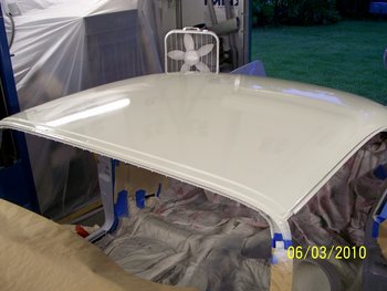

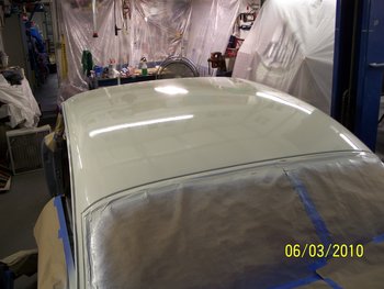

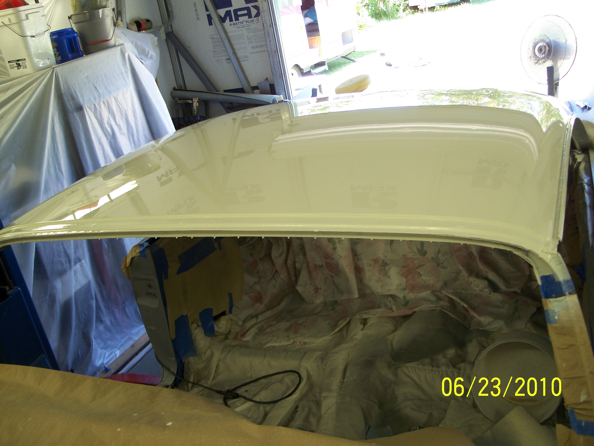

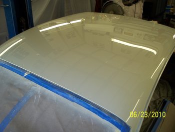

Couple of pitchuhs, finally getting some paint on the car, painted the roof, used white paint left over from the Desoto. Lots of orange peel but enough paint so will wet sand and buff nicely. Going to wife's mothers memorial in New Orleans next thursday then to Aberdeen, TX. to pickup daughters camper trailer so I will wait until I get back to paint the red.

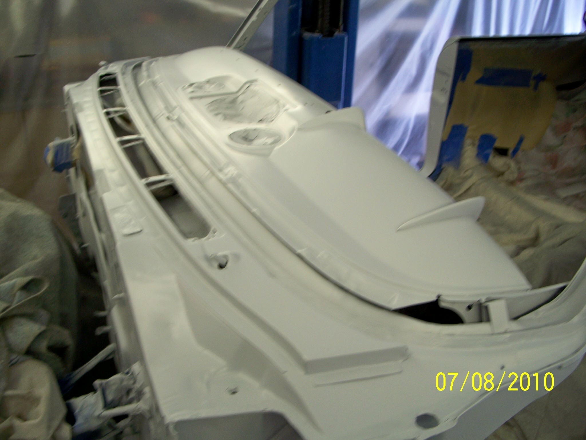

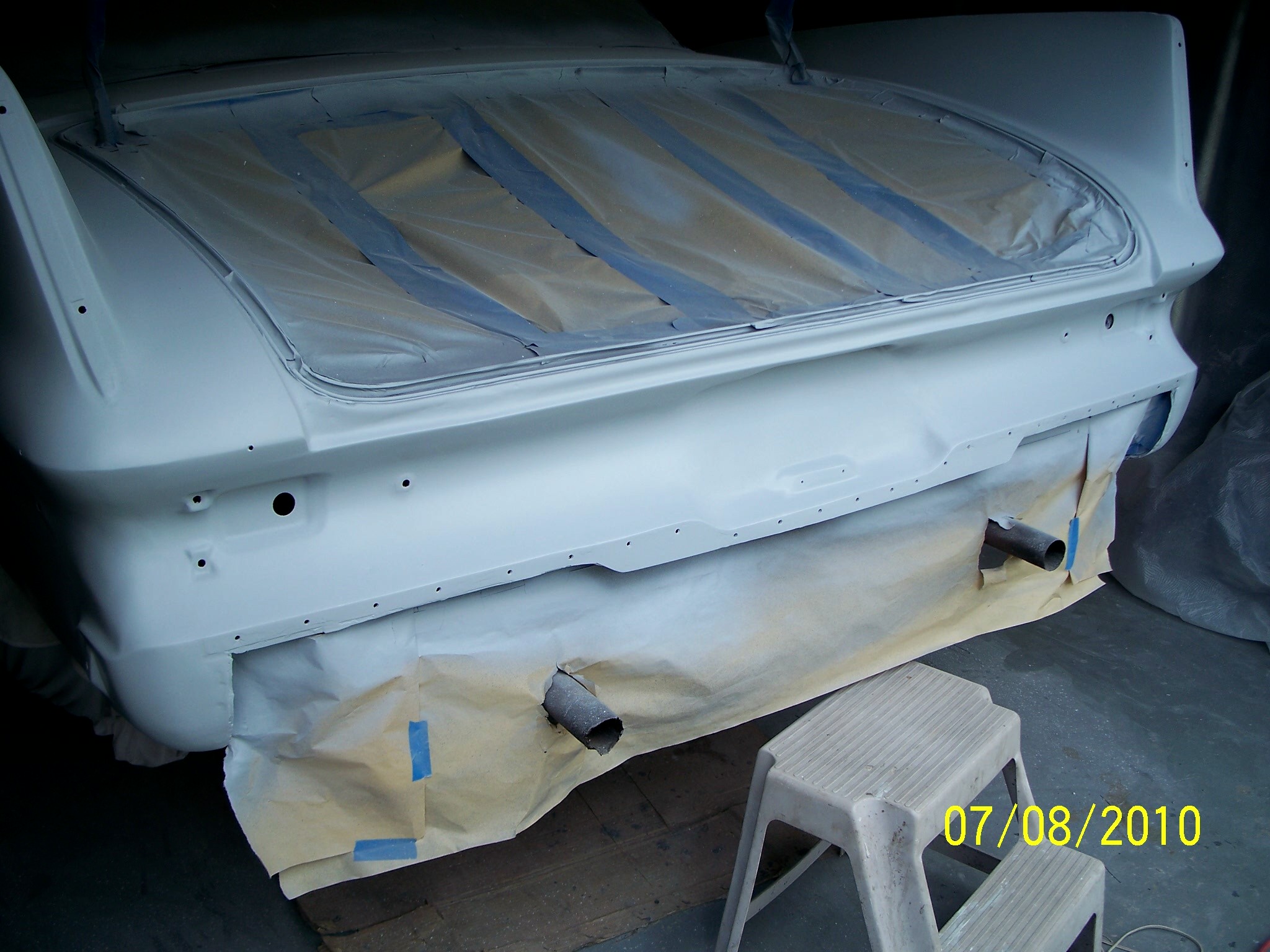

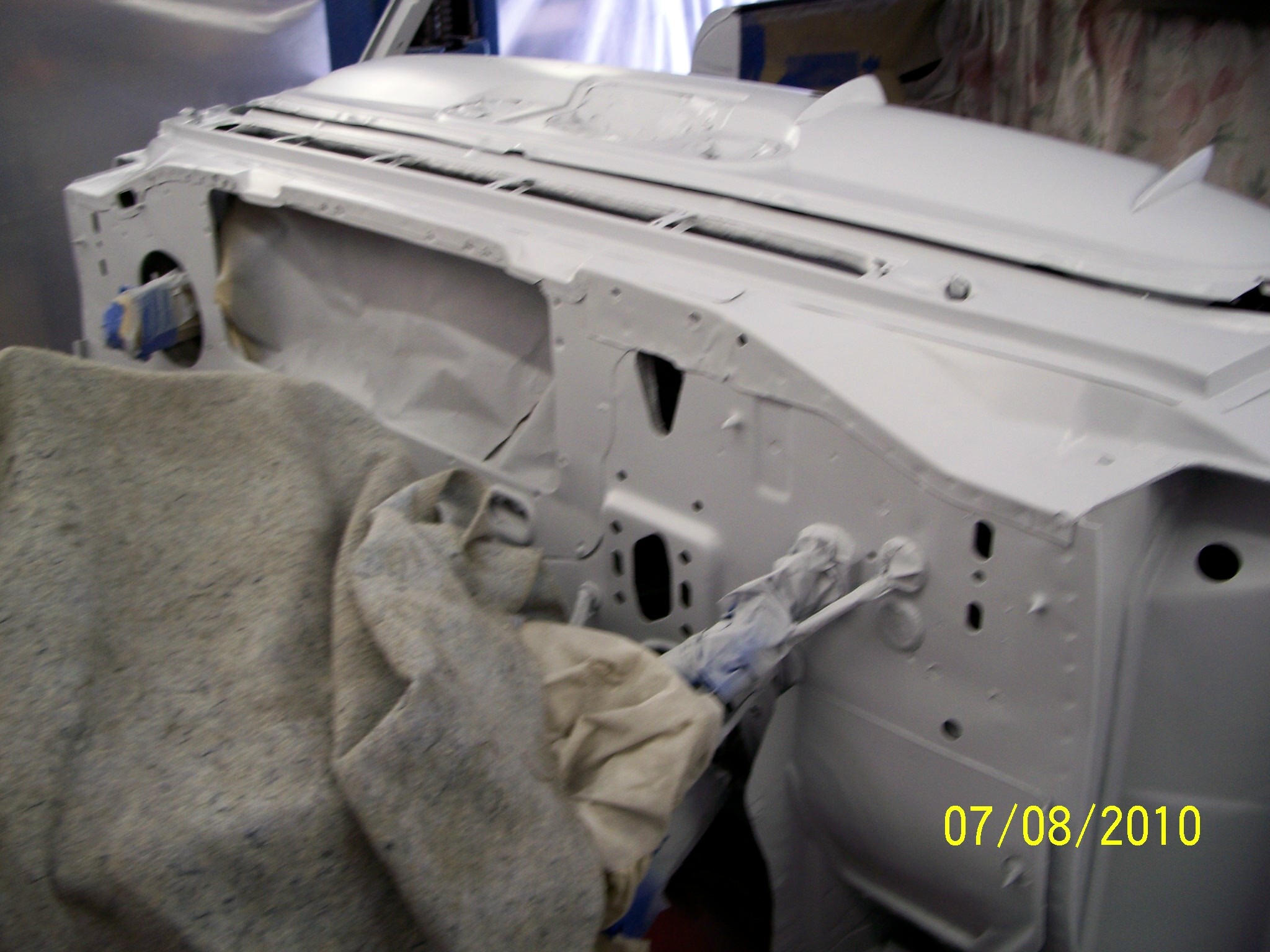

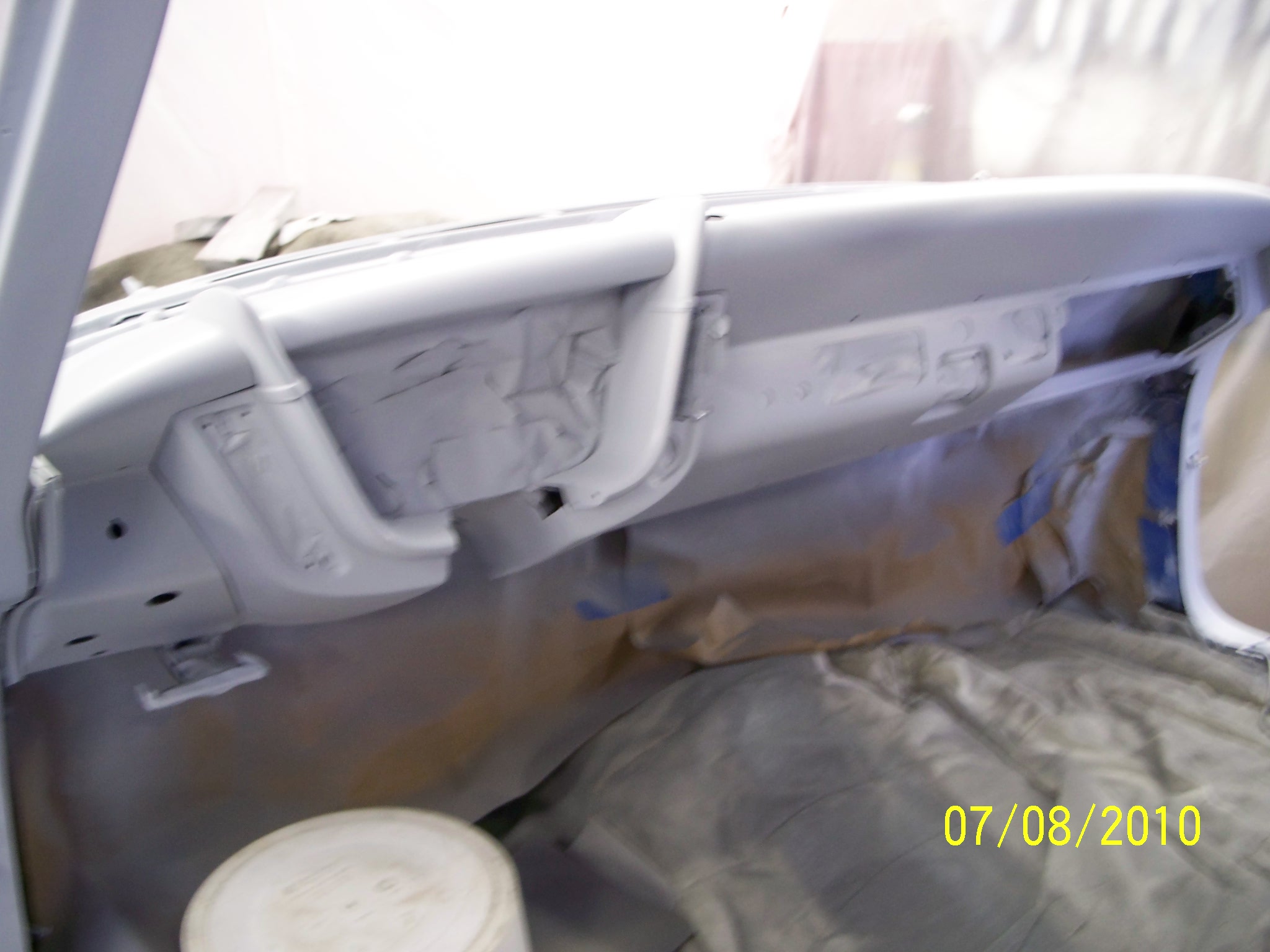

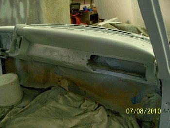

OK, mo pitchuhs, almost ready for color, then I can install steering, dash components, power brakes, etc. I had half gallon of white paint leftover from the Desoto so used it on top. I'ts not bright white but white enough. The body has been Osphoed, one coat epoxy primer, blocked, one coat 2k urethane primer, blocked, what you see is the last coat of 2k primer. Will light sand with 400 paper then color red.
Wet sanded and buffed.
Sorry, a little fuzzy.

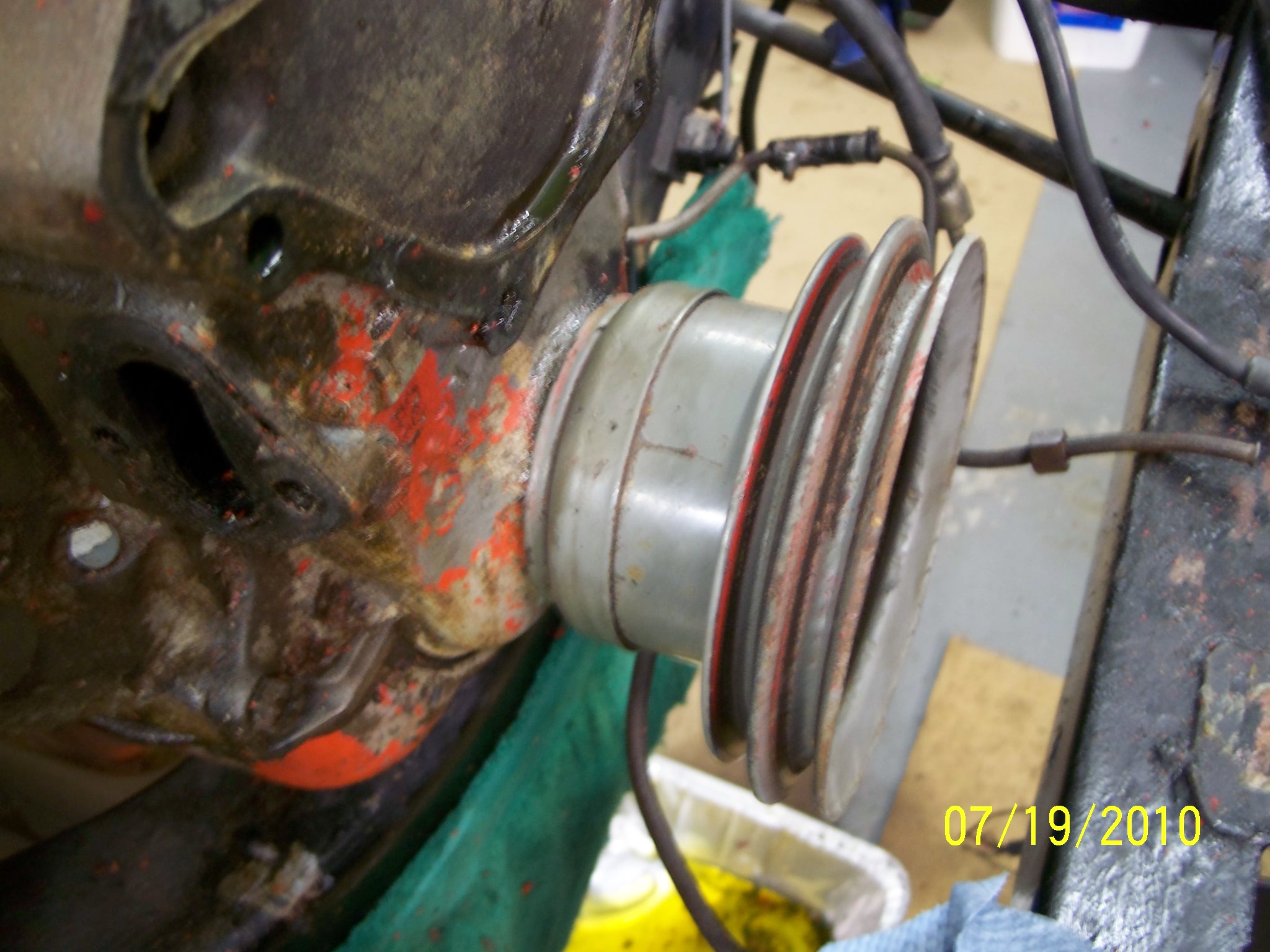

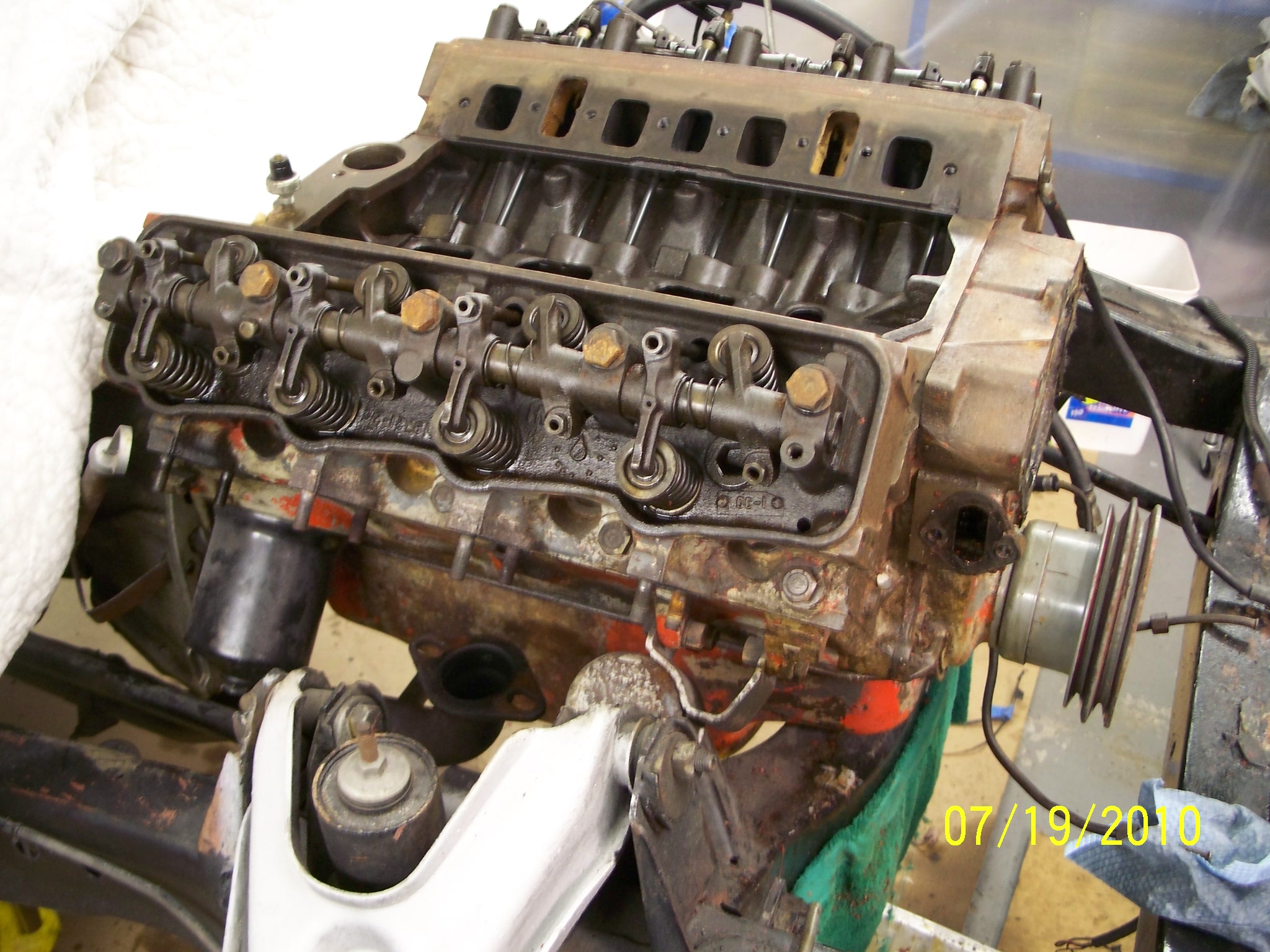

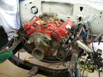

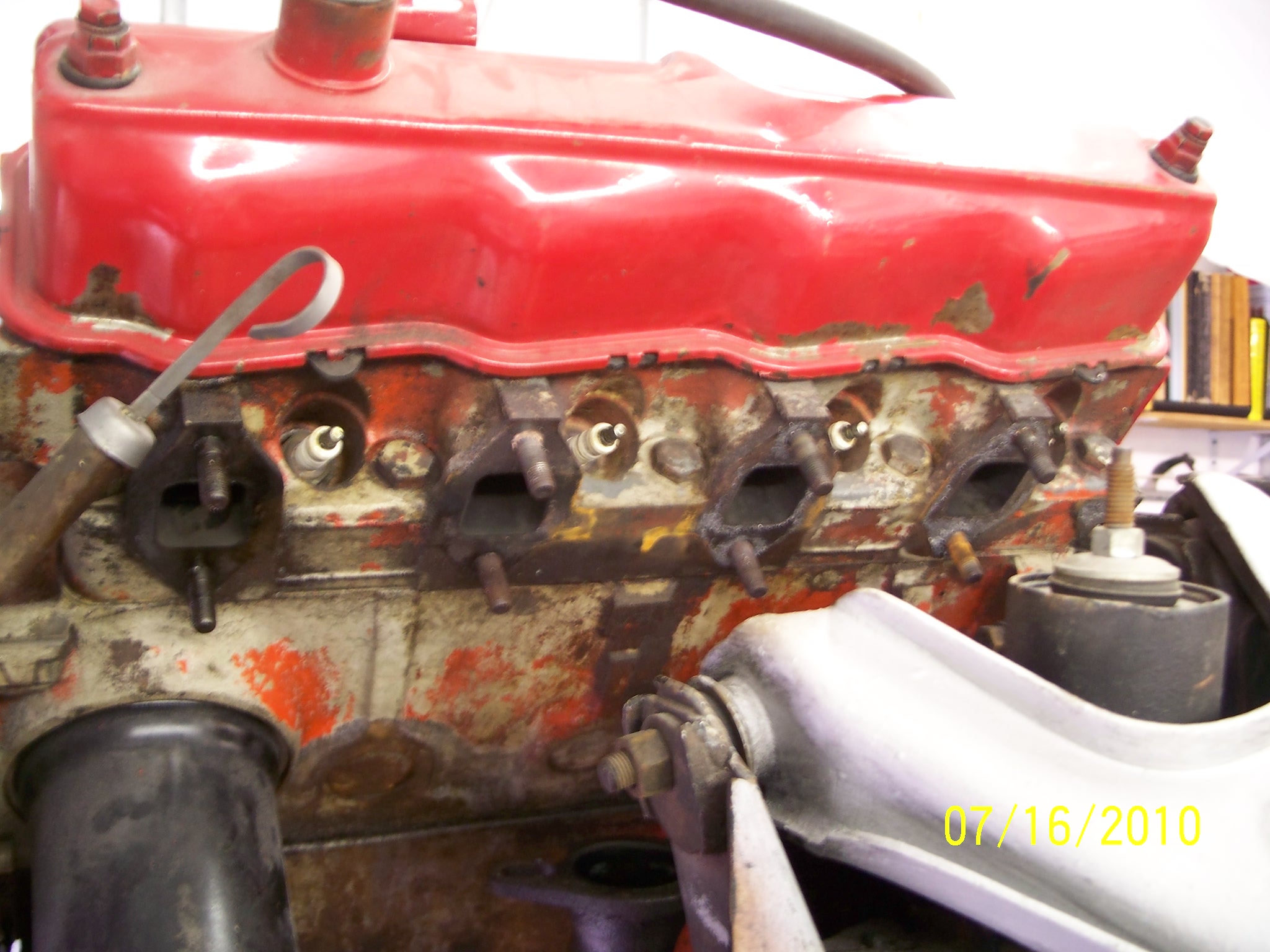

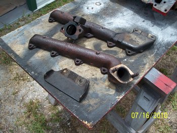

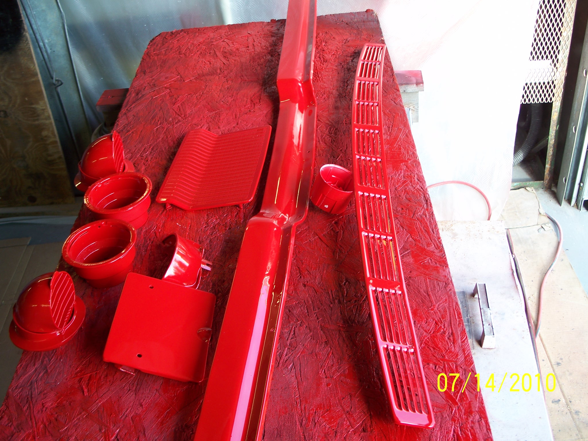

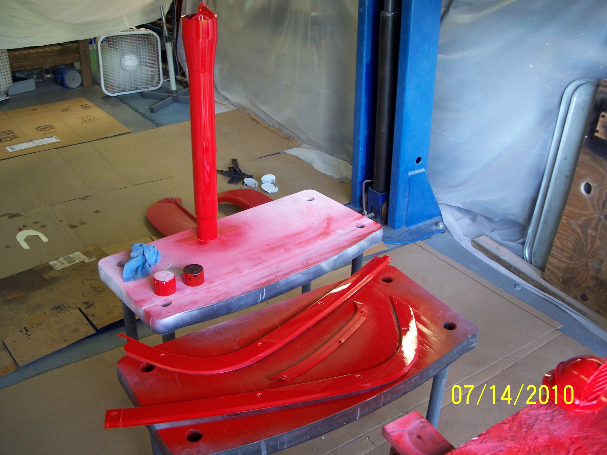

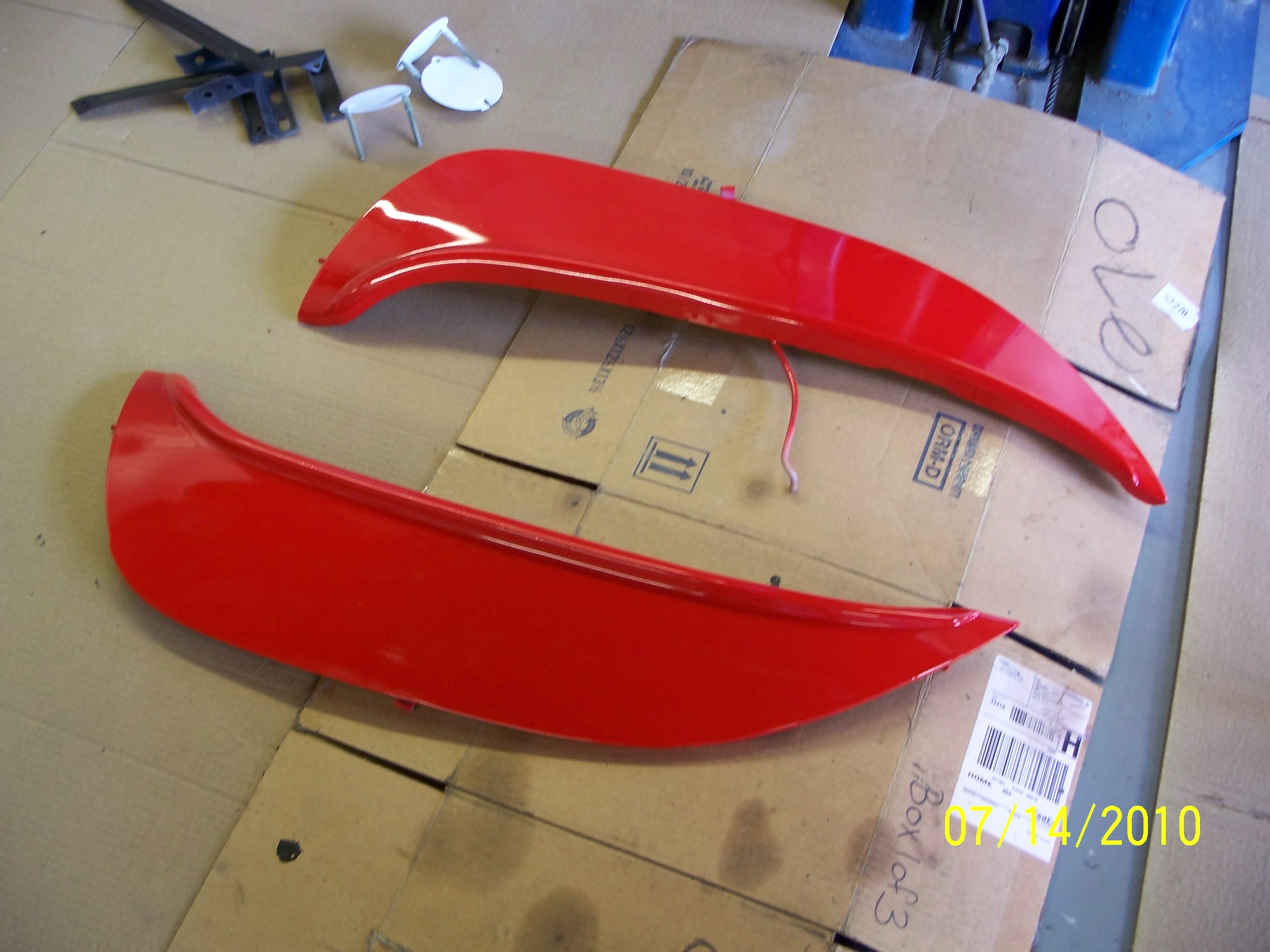

I couldn't stand it anymore, I had a strong desire to check out the RED I picked so I painted a few pieces to see what it looked like. I'm happy, happy, happy. I've kinda somewhat mastered my new Eastwood Concours HVLP gun and the paint (single Stage) laid out rather nicely. In case you are interested to get 10 psi at the nozzle the inlet pressure at the gun has to be 29 psi. make sure your desicant filter is before the gauge. I decided to complete the engine and engine bay before painting the dash and body.

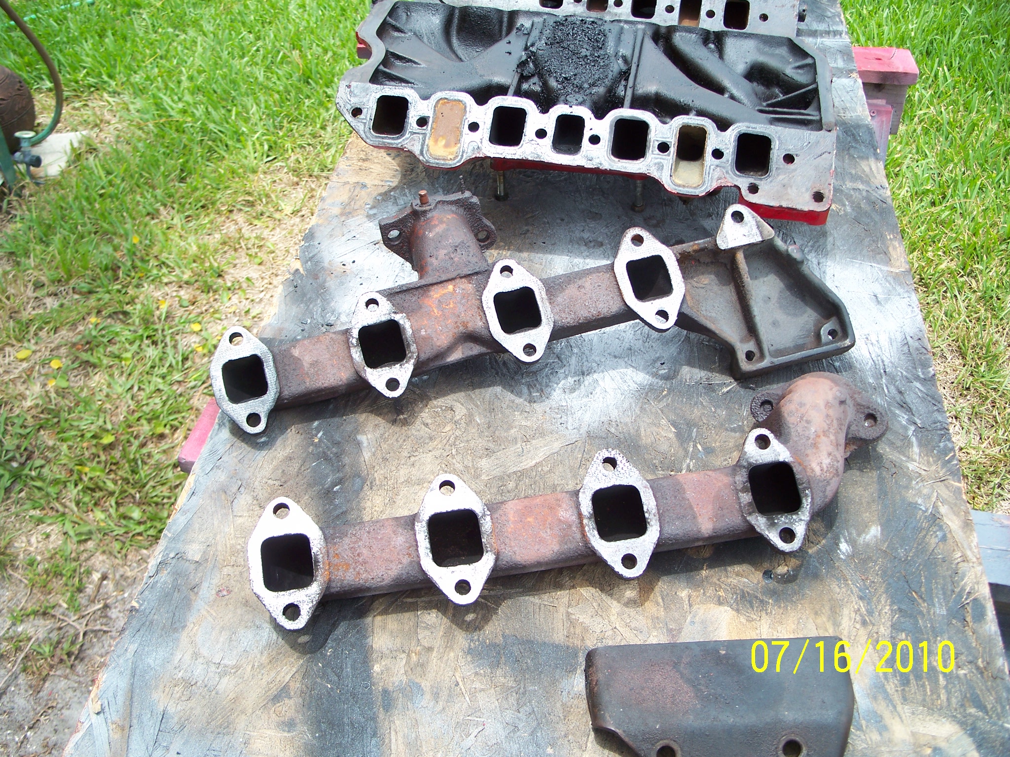

Going to: Replace motor mounts, water pump, new belts and hoses, freeze plugs, timing chain if needed, clean oil passages, remove all old paint from engine and repaint, red engine, black pullys and fan, gold valve covers. Did a compression test (by the way make sure the oil pressure sending unit is installed, oil all over floor) Manual say 125 to 165 psi, my readings were 135 to 160 so I'm going to leave it alone for now. Will sandblast the manifolds then paint them, then paint the engine and put back together, then paint the body, install dash, power brakes and steering.
Whew,
LOOK MA, NO HARMONIC BALANCER!
