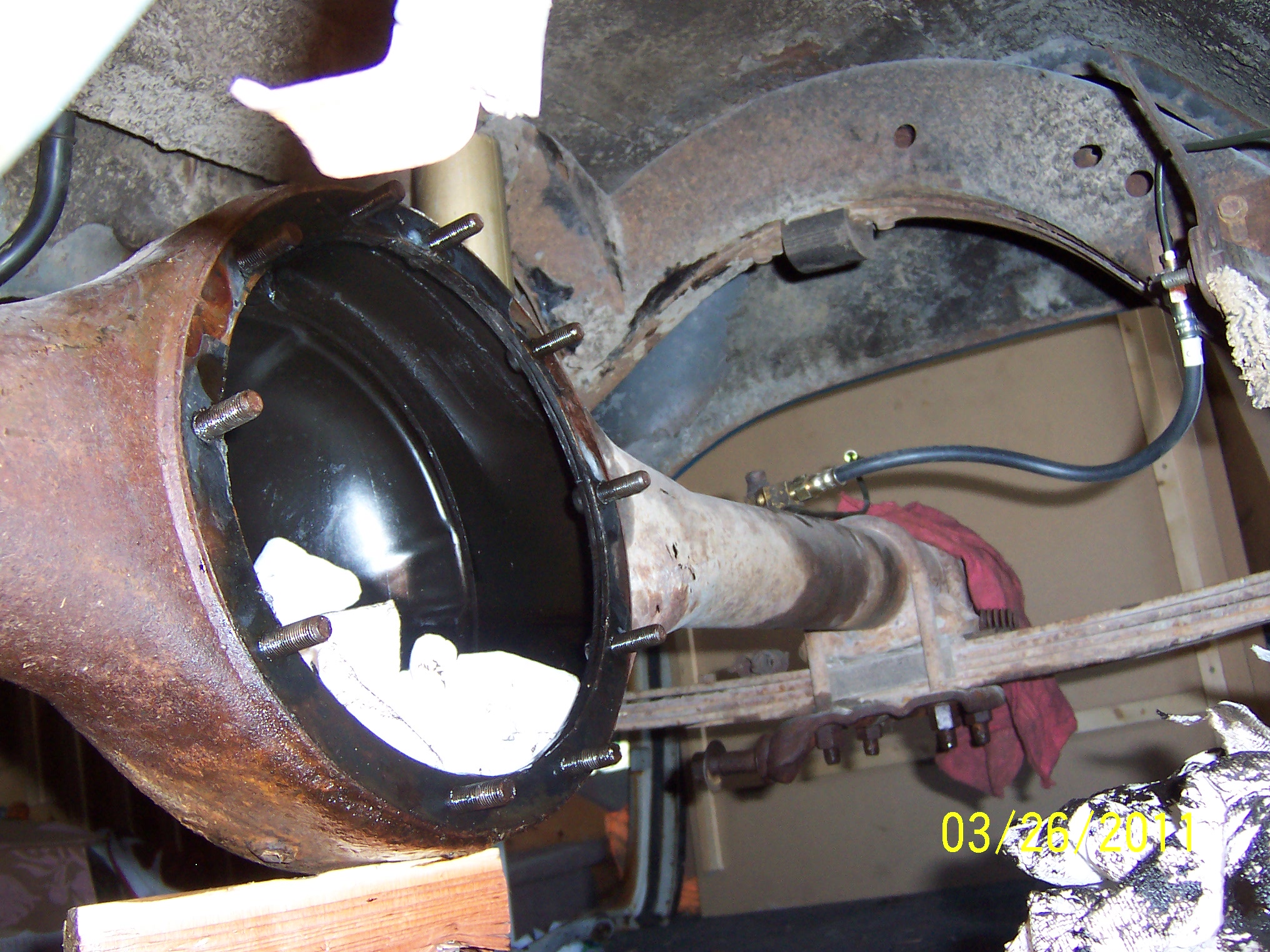

Recent pictures of the new rear axle seals going in. Plus, as long as the rear brakes and axle shafts were removed, Ricky Mopar (Rick Clapham) decided that my 413 RB needed better gears then the highway 2.94 ratio. He dug out another 8 3/4 center chuck with 3.58 ratio open gears that he had take out of an old 59 SF a long, long time ago. Rick also helped out with the needed drum puller and seal setting tools need to make all the new parts go into position.
Everything went in well. Had to use a second hydraulic jack to help lift the pumkin near the opening but was able to push it in from there with a new gasket too!

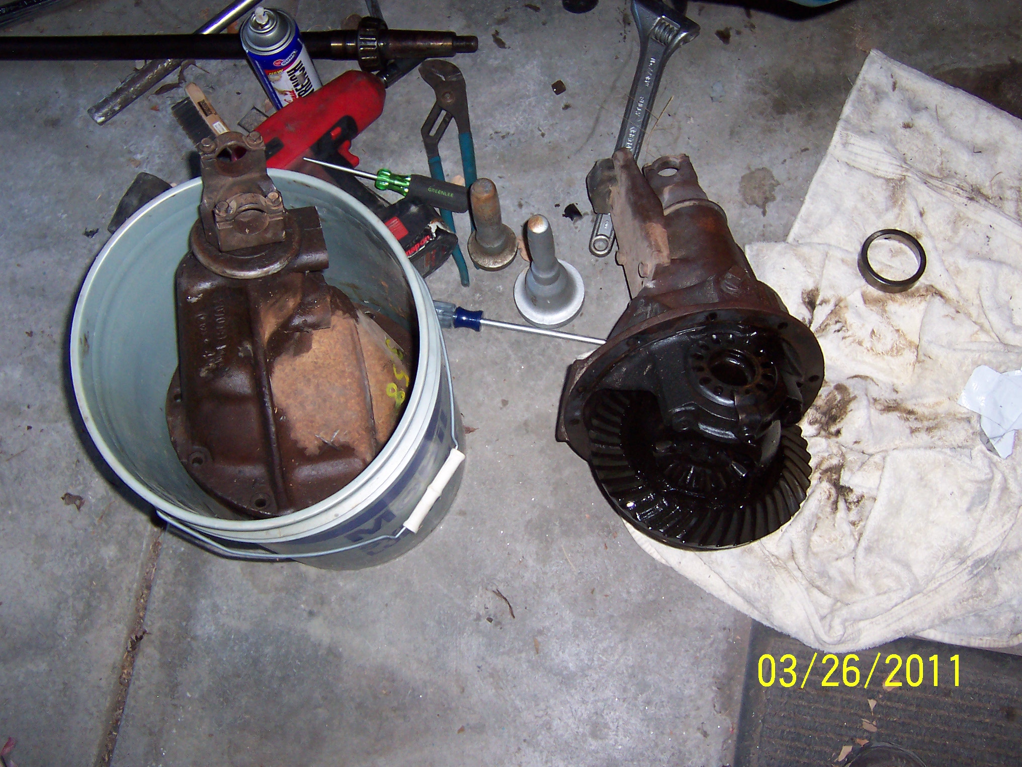

Old 2.94 ratio chuck on the right and the new to me 3.58 ration gears in the "easy to tote" white bucket!

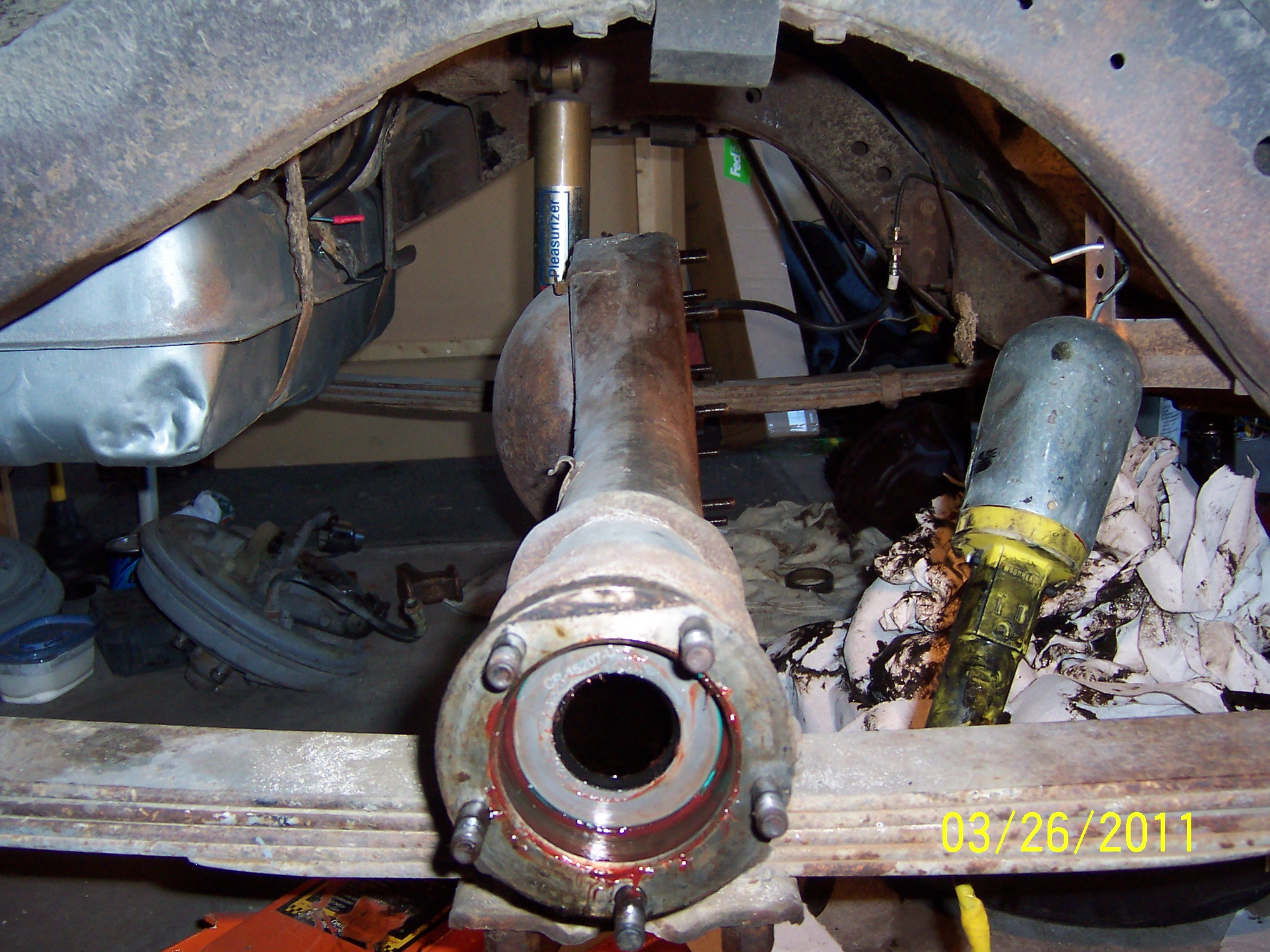

passenger side view of the new NAPA inside axle seal installed. Also put on the new outer seals on the brake backing plate too. Repacked the bearings and re-installed the axle shaft. The passenger side was the leaky one upon disassembly, but now both are brand new.

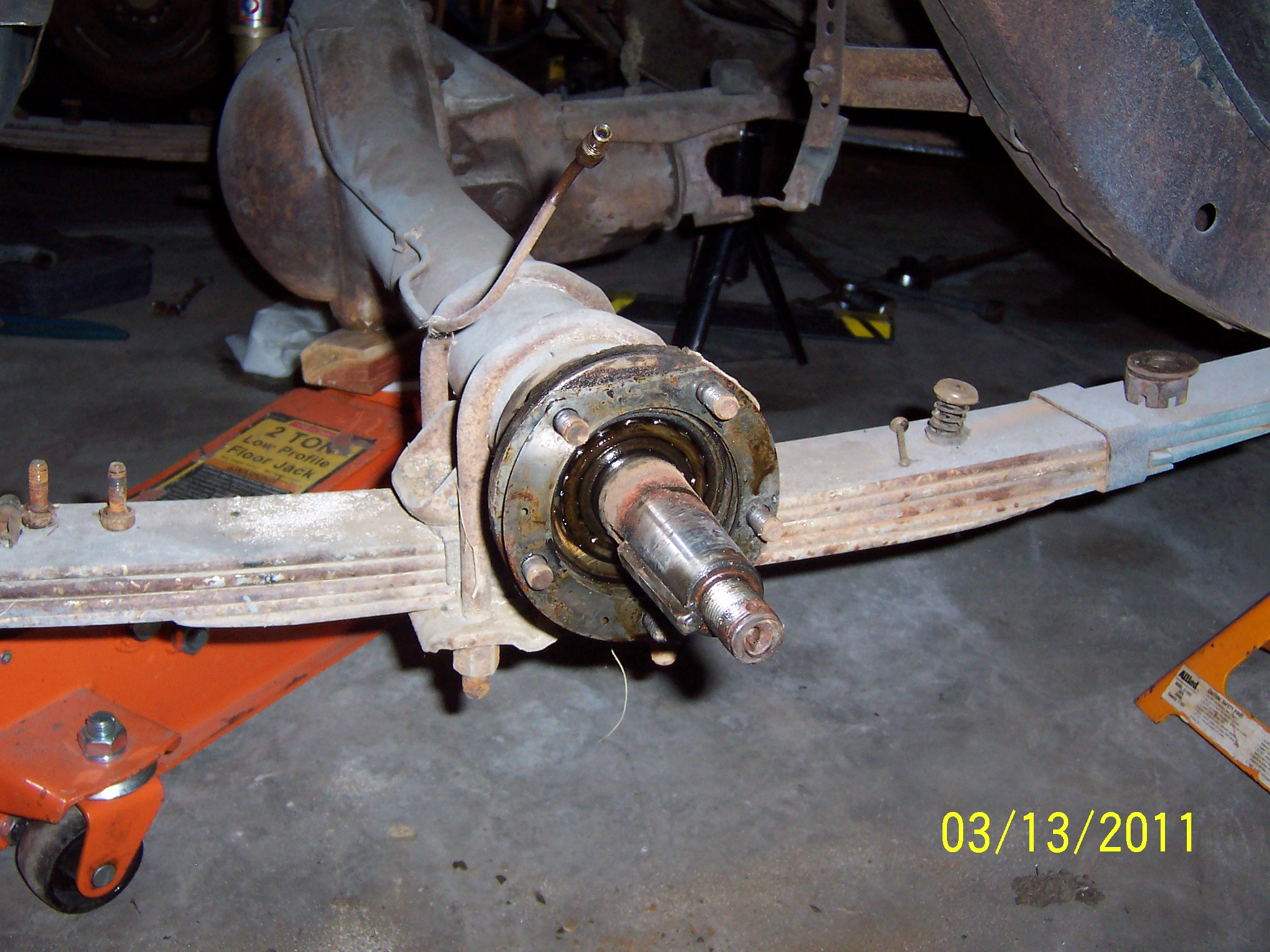

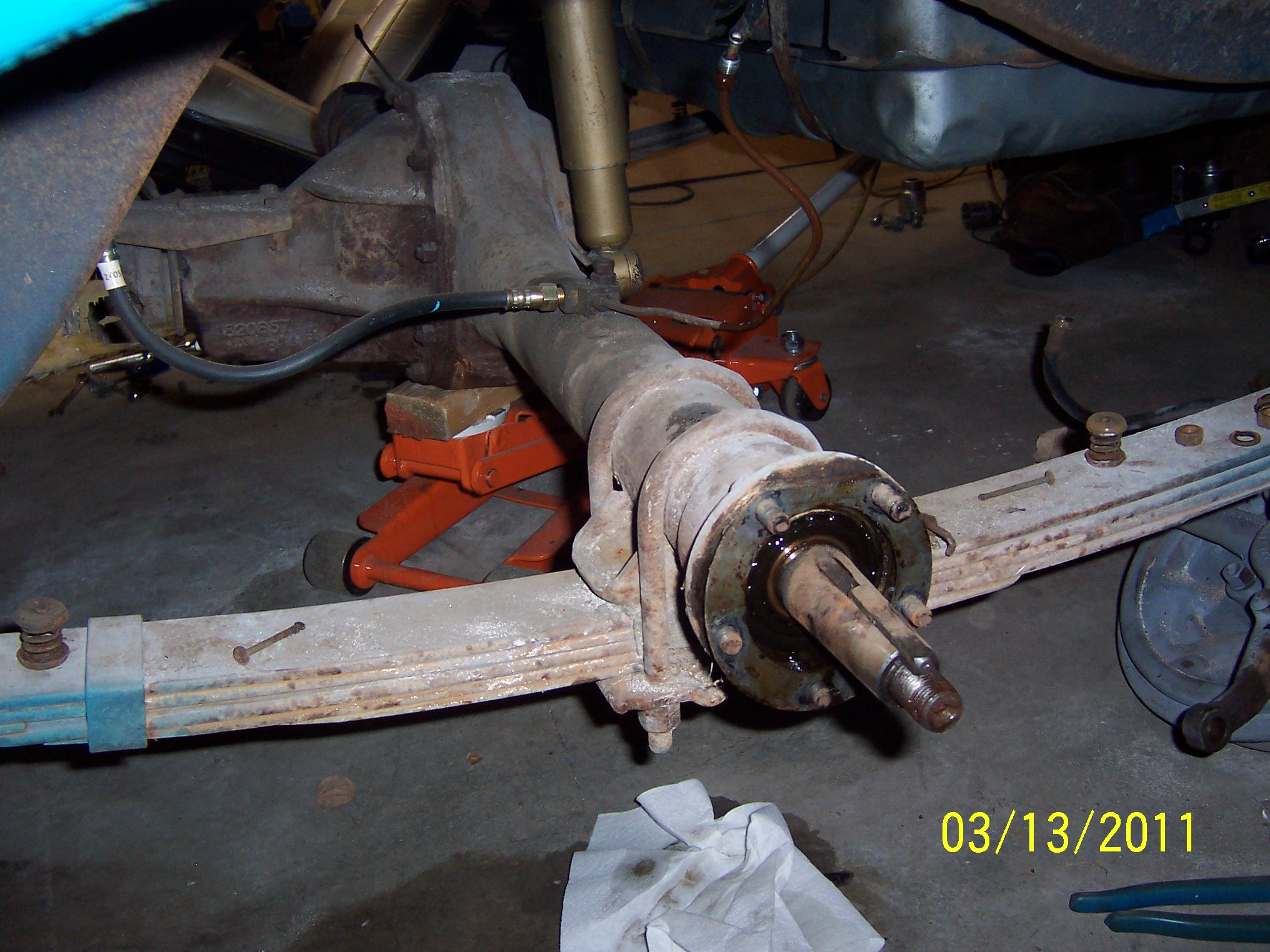

Here are the before pictures of the axle ends before disassembly. The Drives side did not leak but replaced it anyhow since it was right there. The passenger side was the leaky one. So that is what started it all besides the wheel cylinders would not bleed at all due to junk and corrosion in the cylinders.
Leaky passenger side, Two shims of different thickness on this side for axle play.
drives side not leaky but replace anyhow as long as I was in there doing the right side... Only one shim on this side for axle play.
Posts: 2218
Q. - Nice work, I will do that on my convert. also. Question? what are those two doobers between the bucket and the gear set, kinda look like handles from a grinder??

Dick,
Those are seal drivers for setting the seals in pllace.

John F. is spot on! They are in fact Seal drives. Rick Clapham brought over 3 of them for me to use to drive in the outer and inner seals for the axle. Beats using a large socket on them and it much better install.
