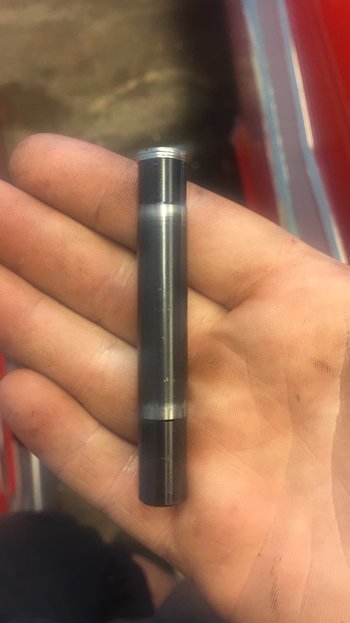

I had the tank that came on the vert fixed as it was leaking, adjusted the fuel sender but all the filters were still clean. Mounted the tank back and filled it up again but the car still didn't fired up.
We decided to change the pump but didn't made a difference. Then we took the fuel pump push rod out, that was another story!!! It was 7mm shorter then it used to be so I put in the old push rod and the car fired right back up!

Splain me why shorter??

Mr Koch, that's the whole issue. It shouldn't be shorter and it wasn't shorter when I rebuild the engine!

:o I am surprised that the cam can still actuate the pump after that much wear! Even with a new push rod.. the debris must be in the oil pan and filter.

Wait, I had assumed from this thread, that the new pushrod was (incorrectly) shorter than the original. When I look at the shorter, new rod, it doesn't appear to be worn. Am I mistaken about that? Was it really as long as the old rod, and wore down?

It was really as long as the old one! I wasn't getting any fuel to the carb as the push rod runs on the camshaft and it runs the fuel pump. The cam didn't pushed it down on the pump so no fuel at all.
Rick, I really hope all of the debris is in the pan and filter. I don't want more damage

Matthew; Drain and flush. I even use a small fishing magnet. and add a magnetic drain plug.

What would worry me is the condition of that cam lobe?????????????? :?

That also worried me but it seems to be fine now.
I assume the cam material is harder then the push rod. I don't wanna pull the cam now that I can finally drive it

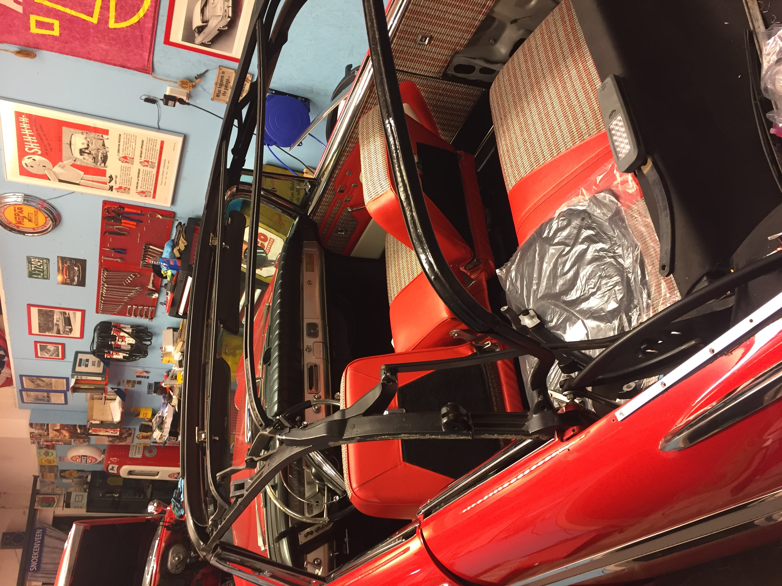

Haven't really enjoyed my top cover yet. As some of you might know the top frame broke. Really happy that I have spares!
There was a small rip in the vinyl so I decided to put a new top on. Ordered it and it was deliver to mr Koch.
My parents picked it up and I started on it.
Still need to fix the 2 center bows.
A pic says more then 1000 words so here are a few pics!
