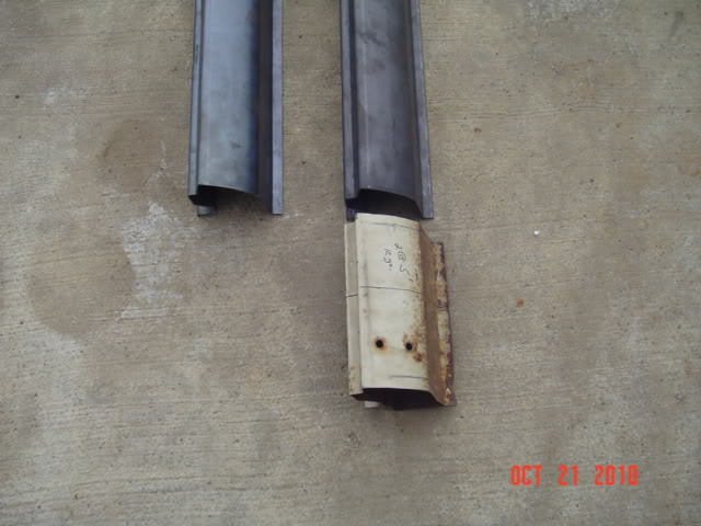

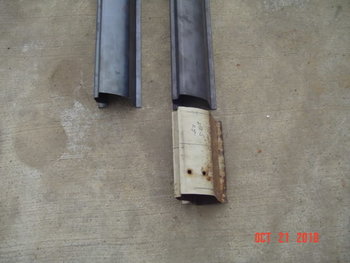

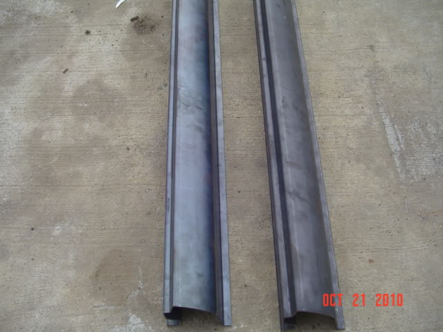

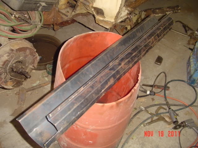

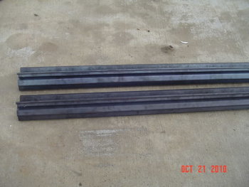

Here are the replacement 12 gauge rocker panels. These were made with a hydraulic metal brake, as the gauge of the steel was a bit too thick to use a mechanical brake.
To get the dimensions of these parts correct, I cut a cross section from an undamaged rocker panel from another Mopar. You can visually see the difference in what was specified for a convertible versus a coupe or sedan.

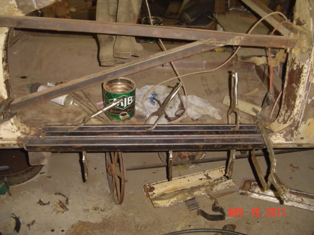

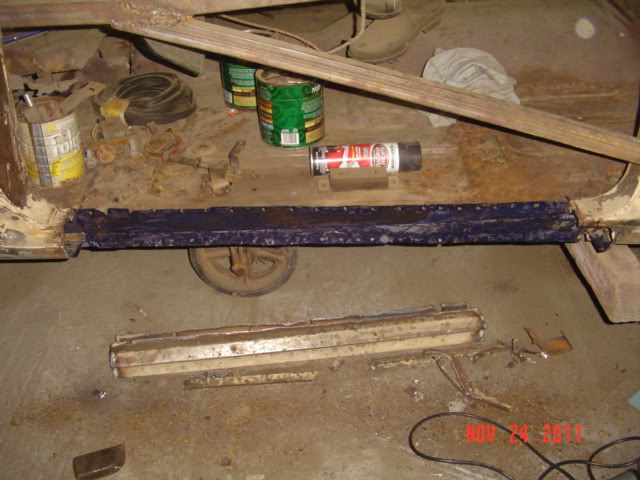

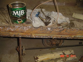

12 Gauge rocker panel installation- Now, I cut the original 18 gauge rockers from the body with the body firmly positioned on the frame. There was no rust found, but wanted the stronger panels to reduce body flex that convertibles can suffer from-
Cutting and fitting the replacement panels-
Had to hammer and dolly the inner rockers back smooth ater breaking the spot welds, then lightly ran a grinder over to knock down any nubs-

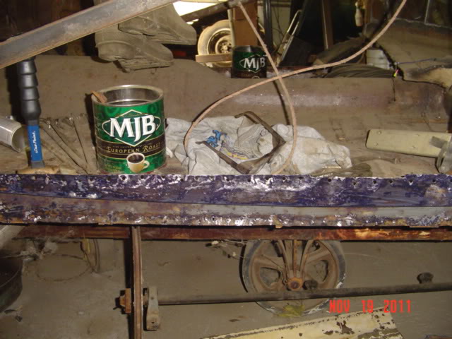

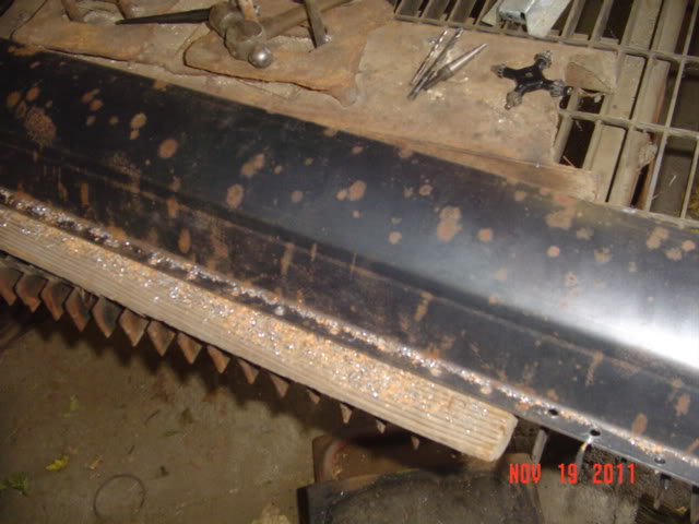

Drilling the replacement rockers haphazardly to replicate spotwelding, with 1/8" holes enlarged to 3/8 holes-
Treating the metal with Over-Rust after cleaning-

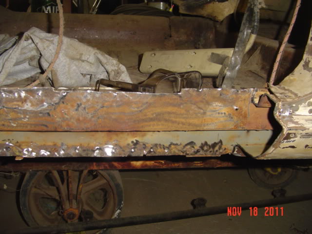

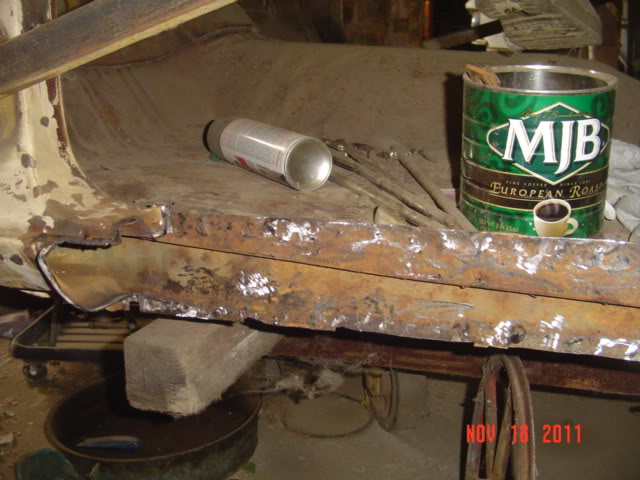

Here is the driver side rocker positioned and partially welded in it fit quite well-

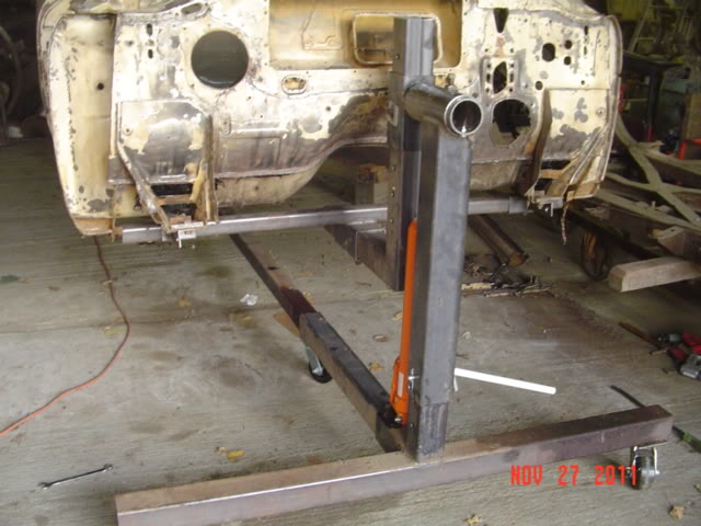

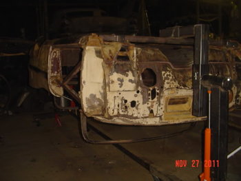

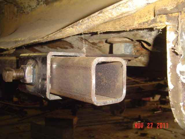

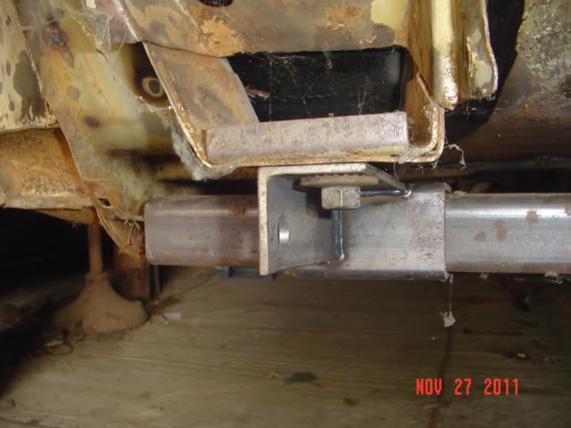

Noow that both rocker panels are now installed, I am able to move onward. I bought this Carotator at the Arco swap last summer, assembly was easy, and of high quality. Using a series of wood blocks and barrels, as i had no help that day, I managed to move the body into position for the rotisserie. Fully fastened on, I can rotate the entire body with one hand. This will make all the grinding and welding much easier.
---John
