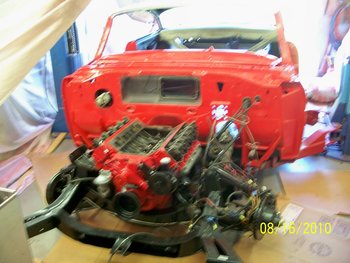

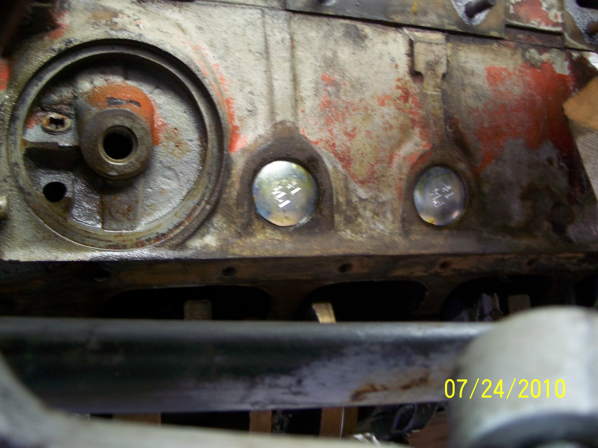

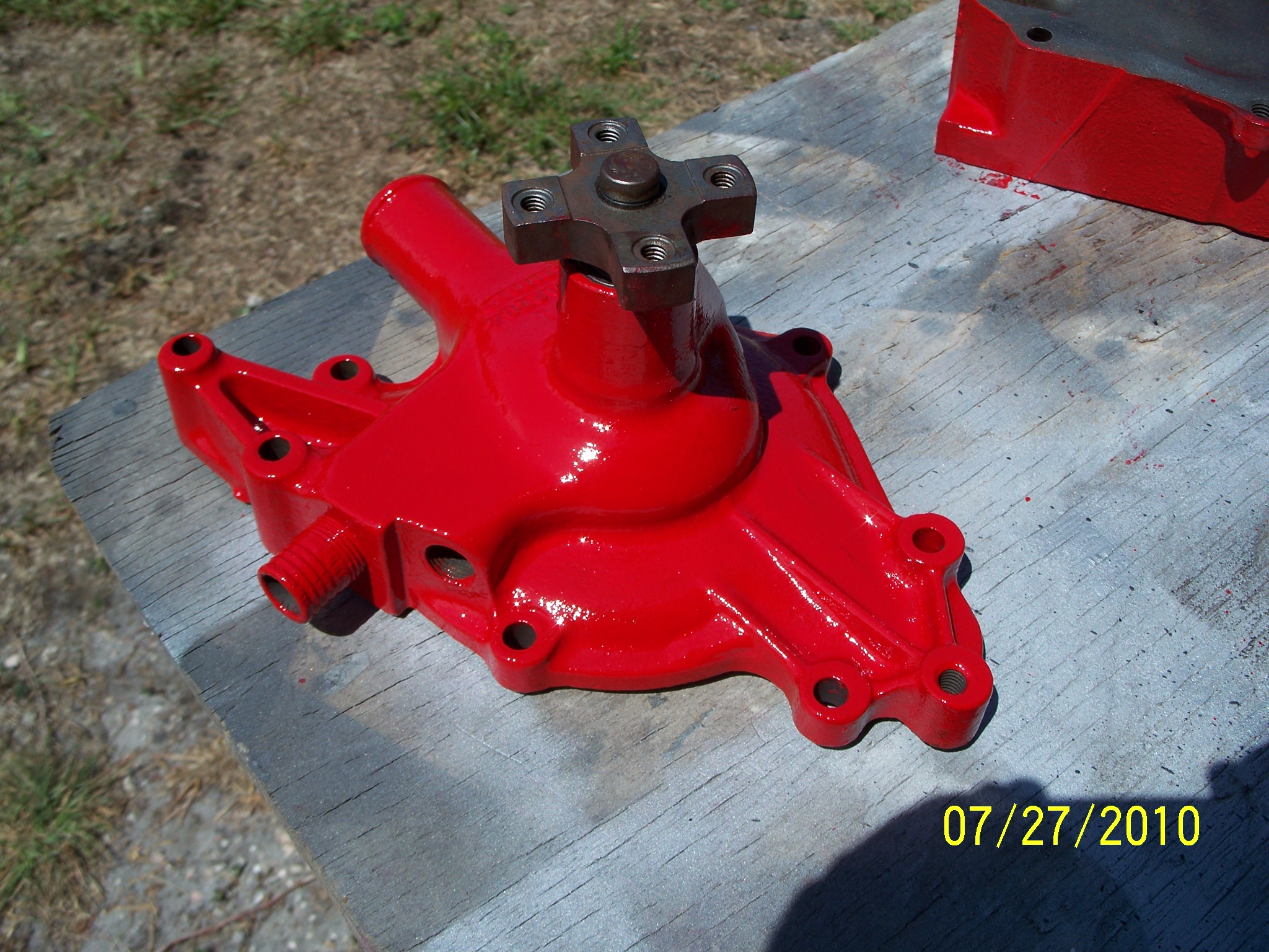

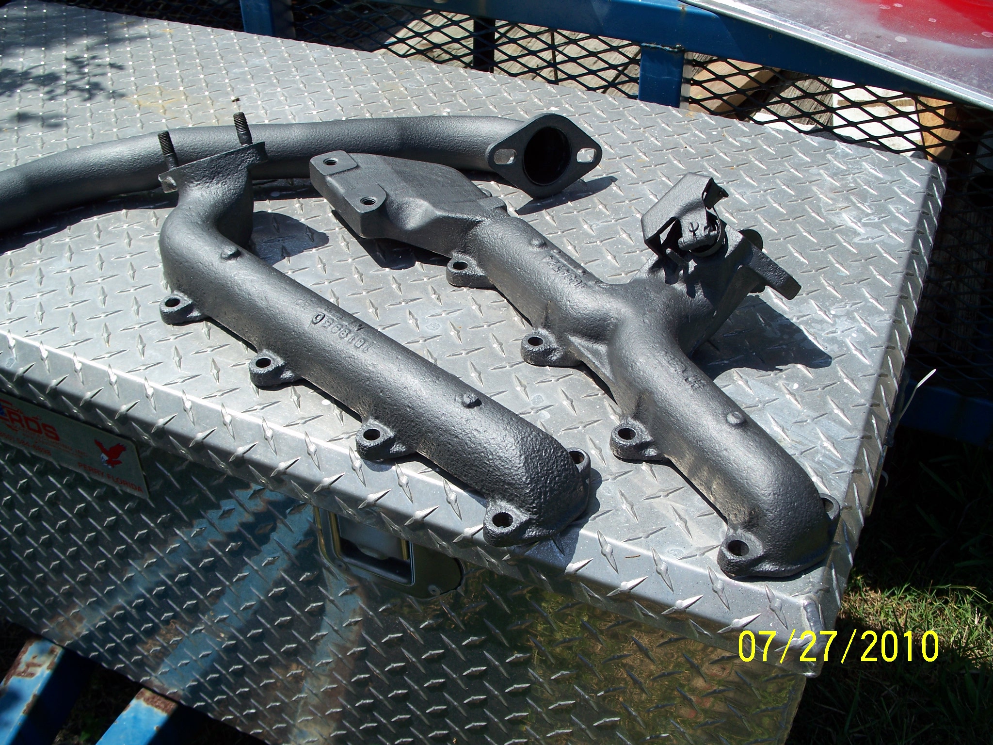

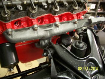

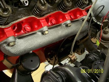

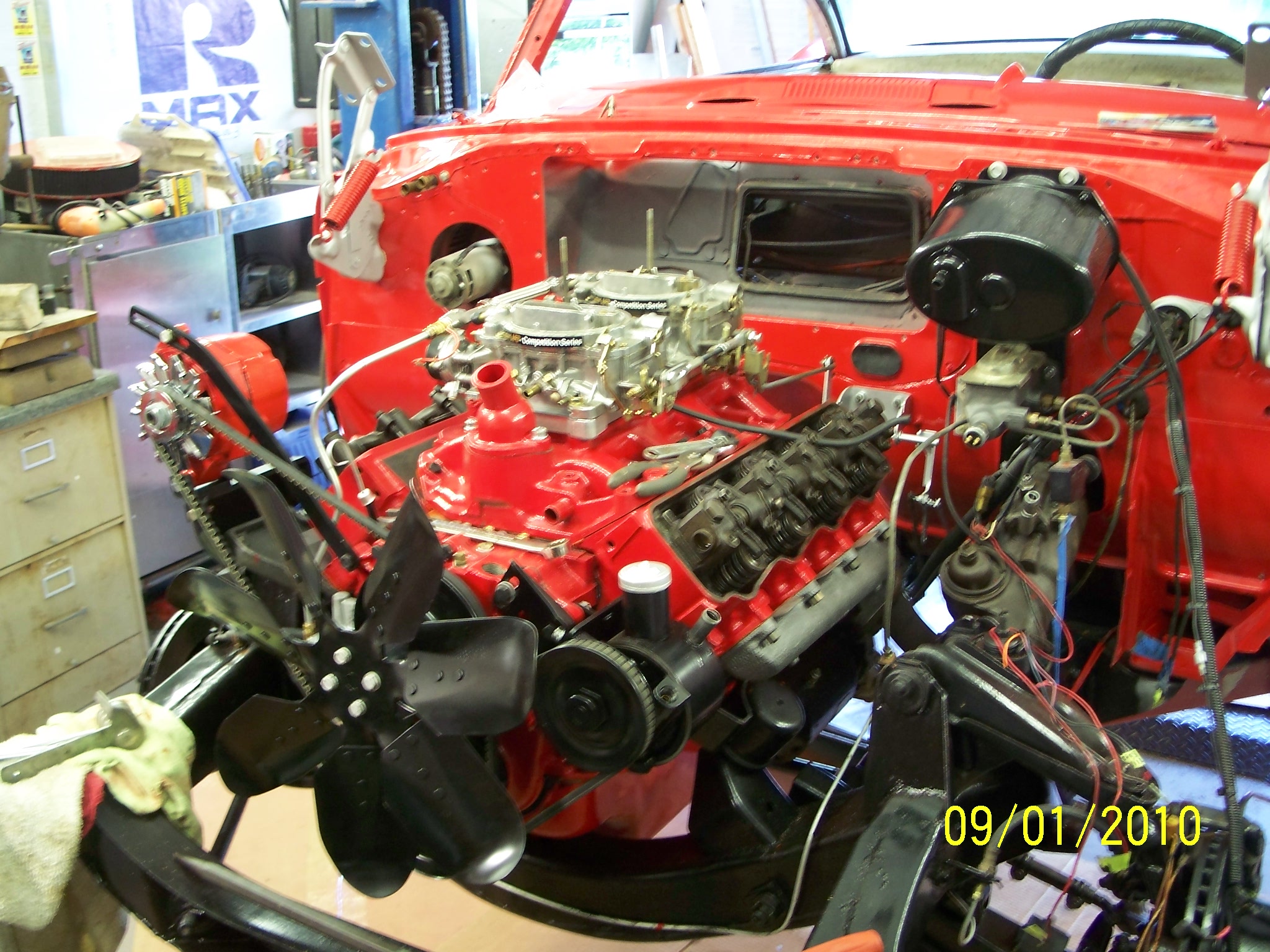

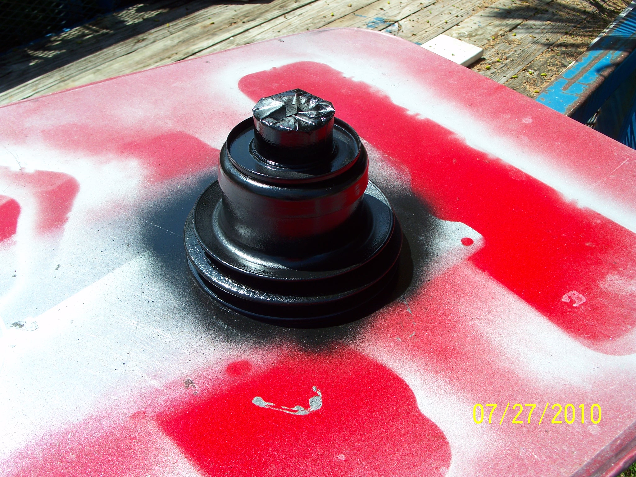

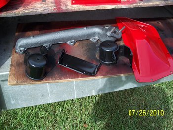

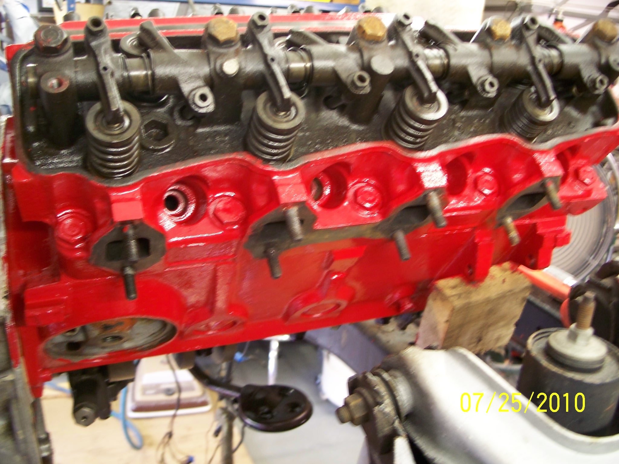

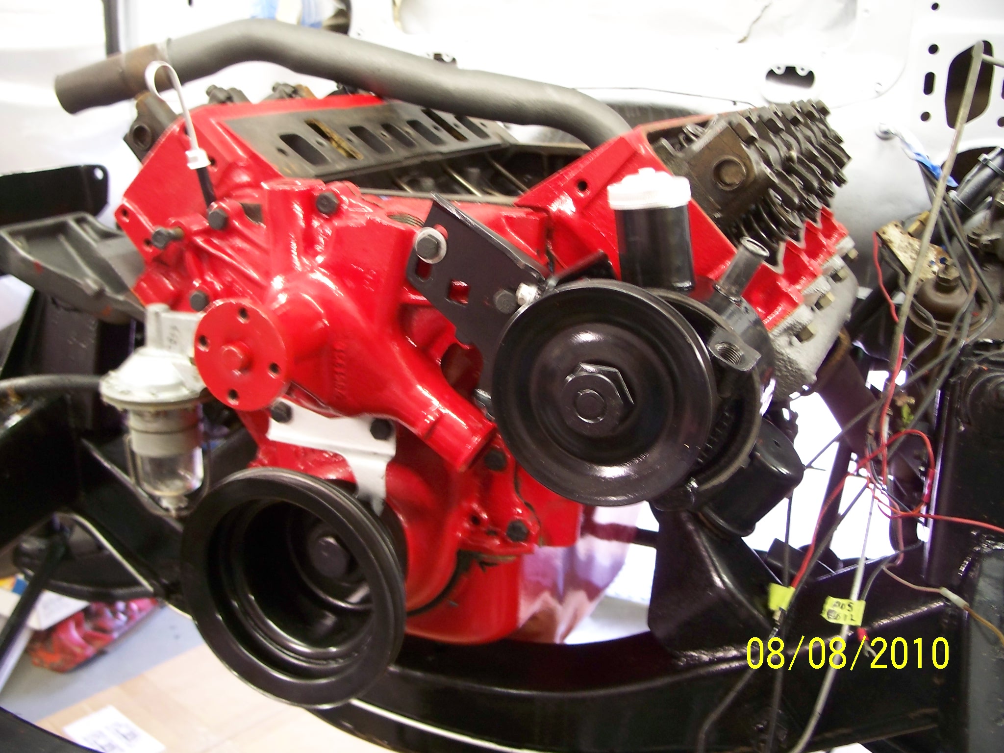

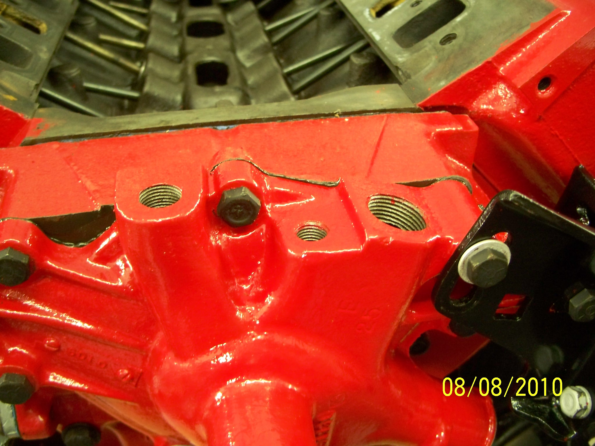

OK, here's the engine afta pitchuhs, the water pump you see here had to come off (only one outlet) I didn't notice until I had to remove some fittings from the old pump, the correct water pump for an AC car is two outlets. I got lucky because the timing chain only had 1/8" play, 3/16"is allowed. It's a good thing I decided to replace the freeze plugs because when driving a hole in one of them for removal it disloged some internal rust and walla a hole apperared so it would have leaked very soon. It wasn't easy replacing them, I thing it would be very near impossible with the fenders on, especially the ones under the motor mounts which i replaced also. The engine paint is Eastwood Chrysler Red 650 degree engine paint and the Exhaust Manifolds is also Eastwood Manifold Paint. More to follow:

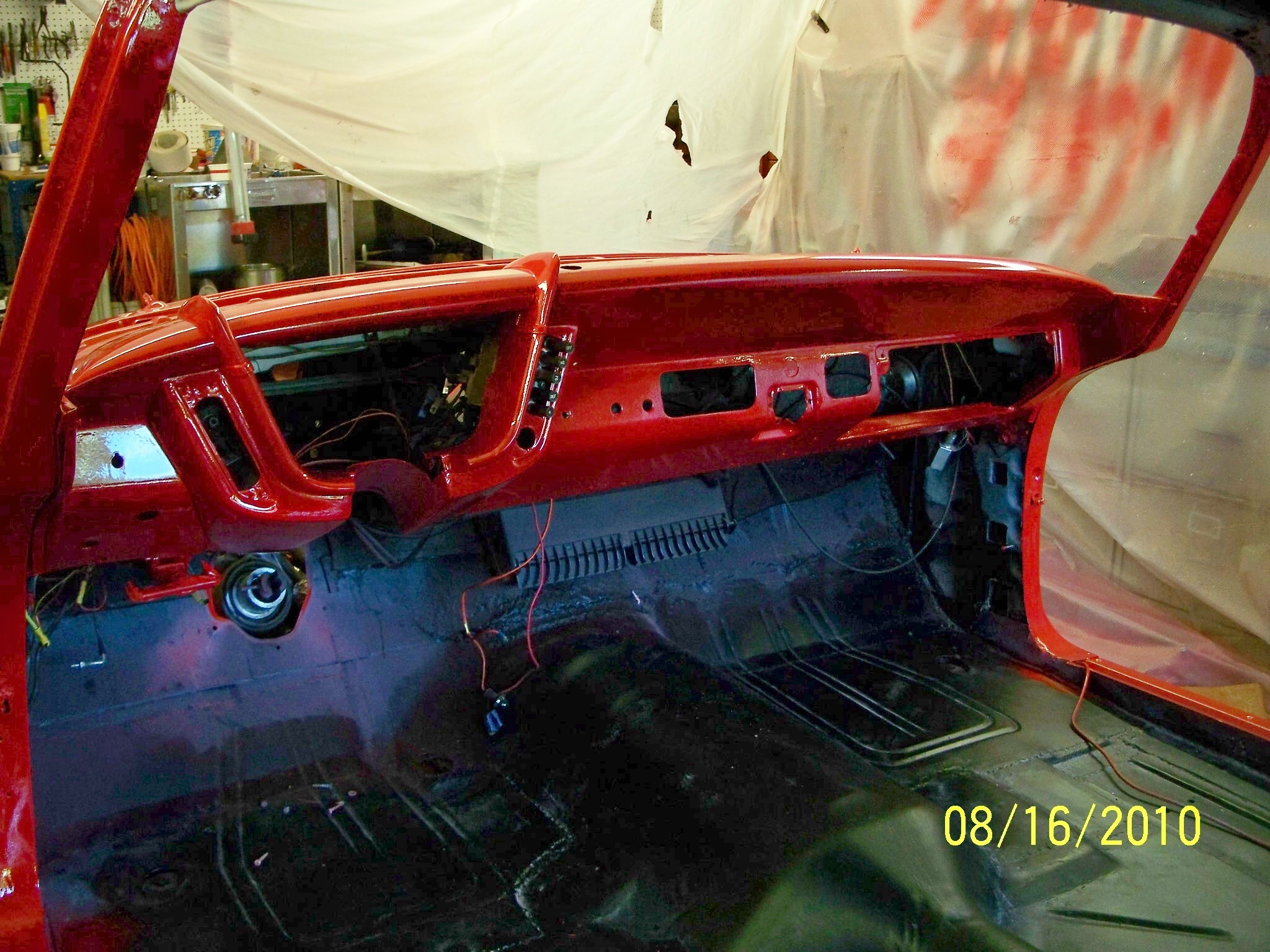

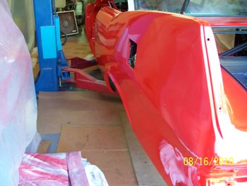

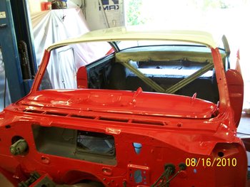

heahs somo - got her body painted taday, gona need lotsa wet sandin and buffin. Hope I'm not boring you guys.

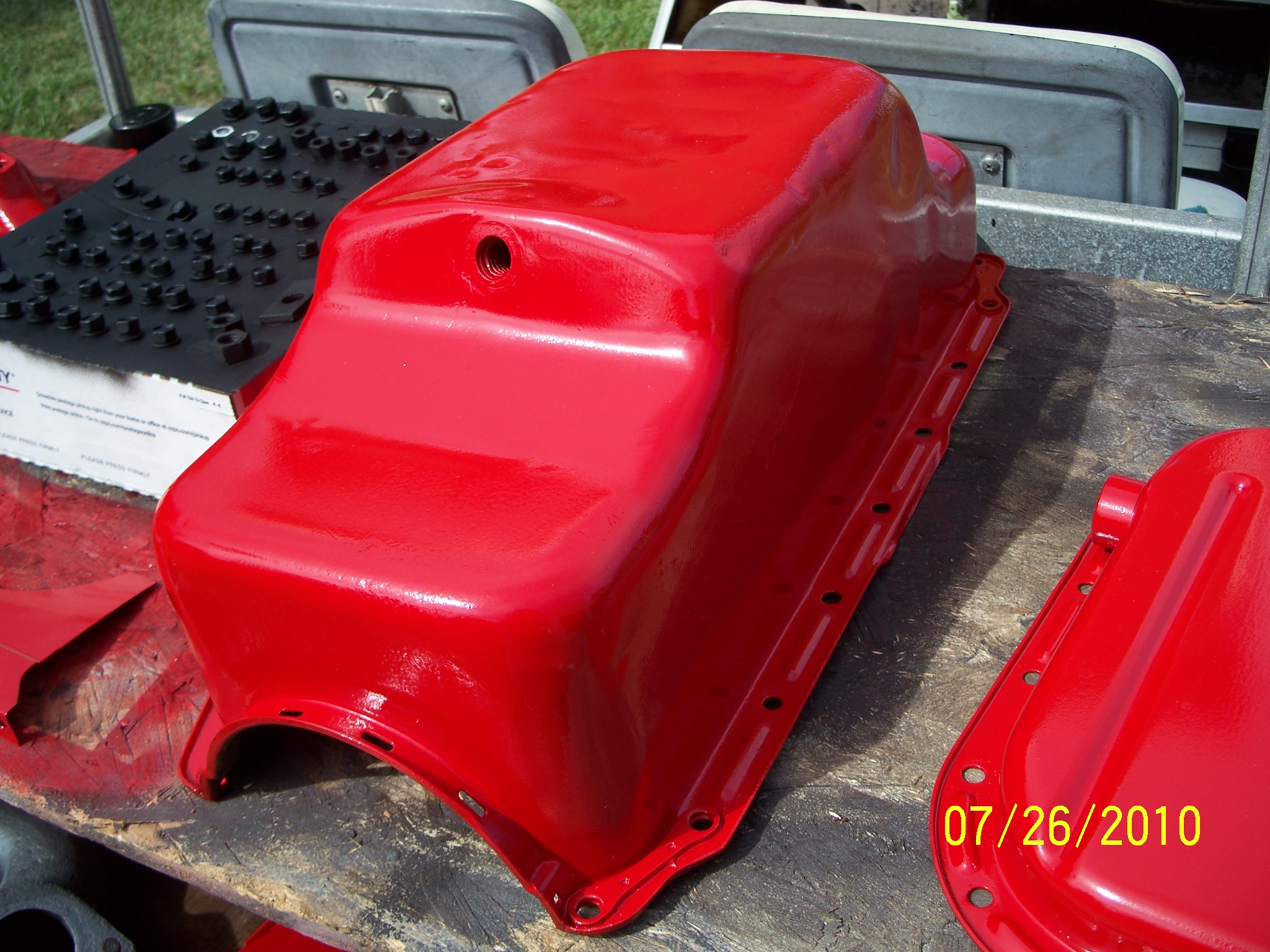

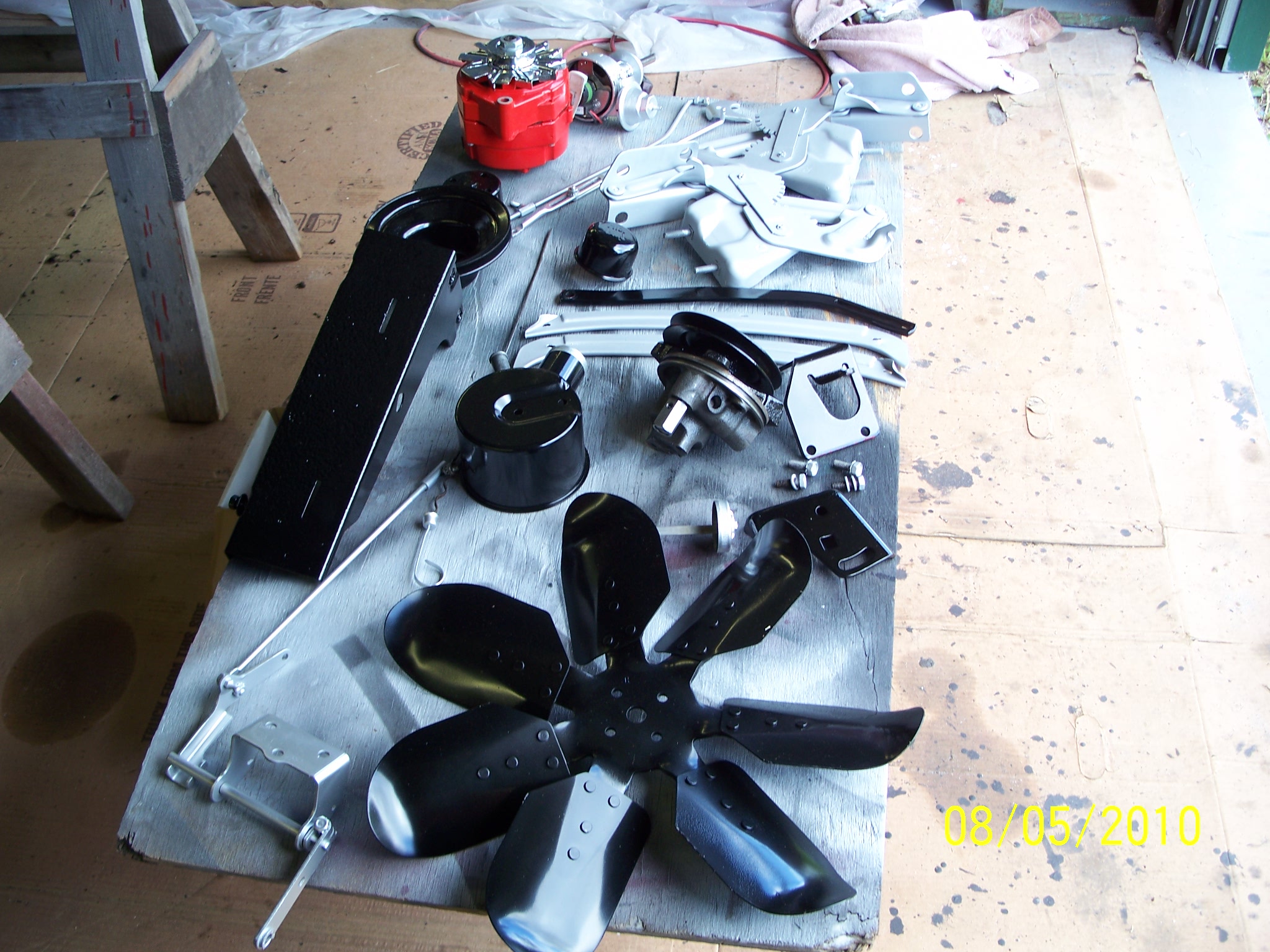

BITS AND PIECES

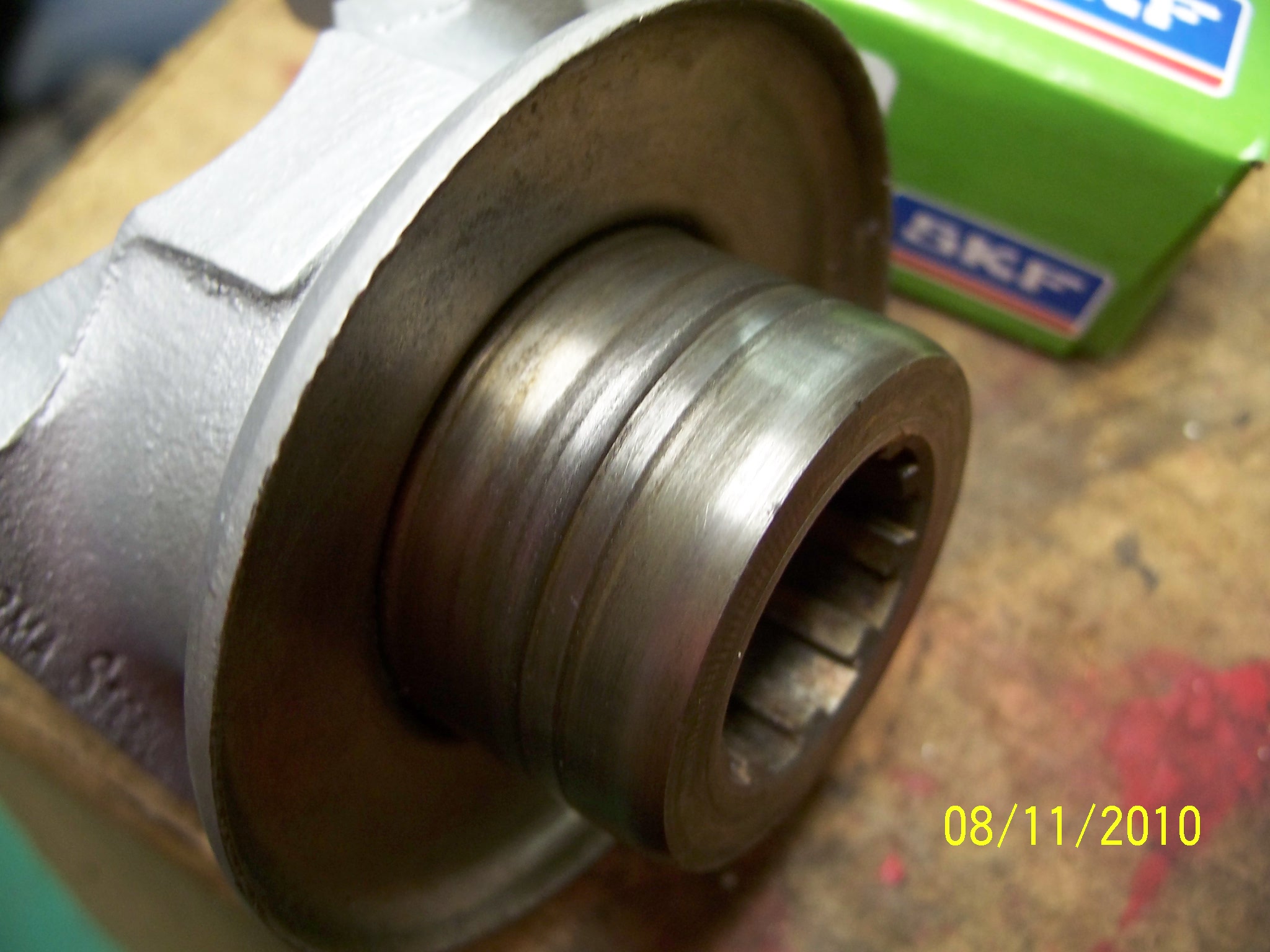

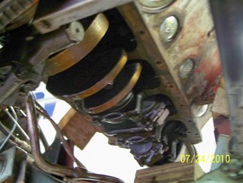

SPEEDI SLEEVE AND INSTALLATION TOOL
DEEP GROOVES, REALLY NEEDED SPEEDI SLEEVE
WATER PUMP WITH TWO OUTLETS, I ASSUME BECAUSE OF AIR CONDITIONING

Dick, hardly boring us with these pictures of your car. We enjoy your work and quality, keep sending the pics!

Great work Dick! I love the color - it will be even better after wet sanding.
I am never bored of pictures.

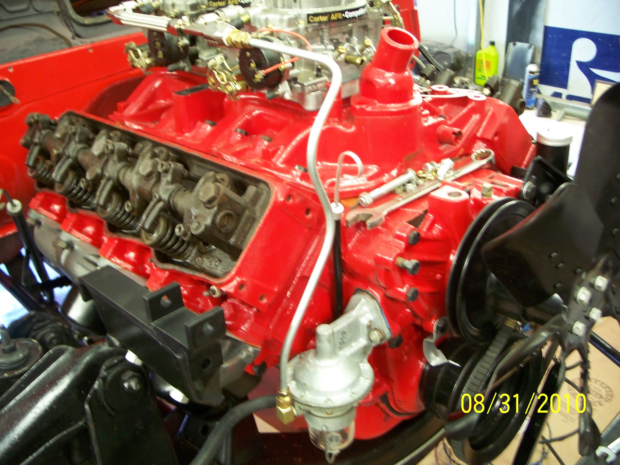

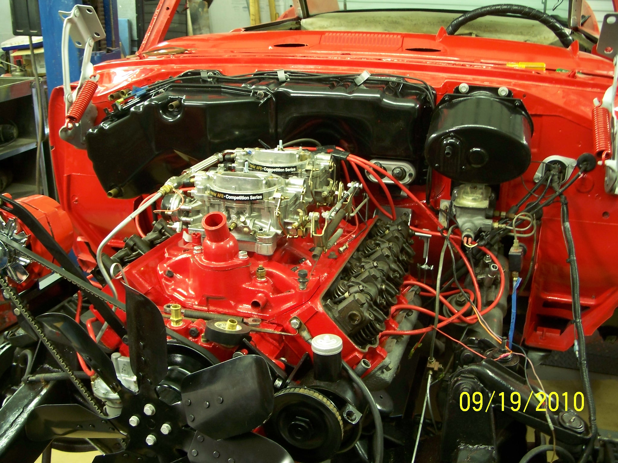

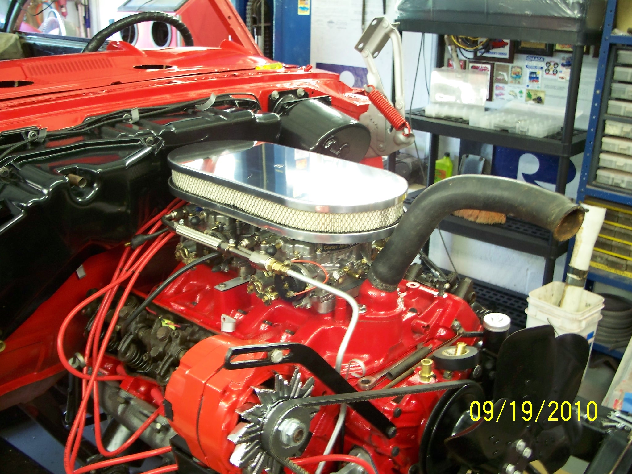

I'm Jealous, John has a 413 and all I have is a 318, that's 95 cubes difference, dag nab it. Eny who heres some more pitchuhs and commentary. Had to change to different carburetors than you see because of linkage hangup and clearance problems problems, Hope to get it running sometime next week.
Puting it together wasn't as bad as I thought.
Looks like more clearance that the single chamber.

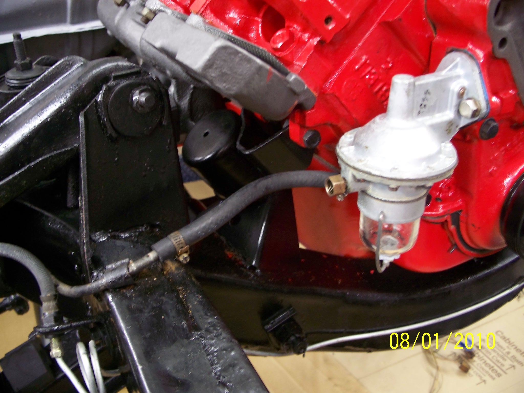

How bout that glass bowl fuel pump.

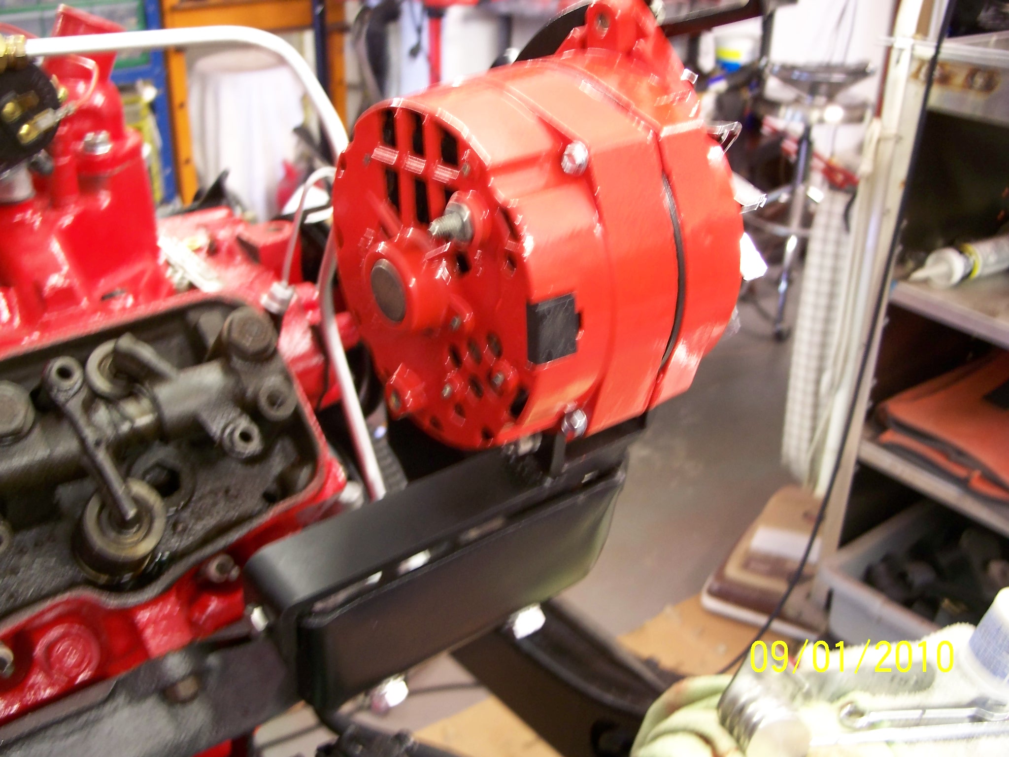

80 amp, 1 wire, got the adapter on ebay.
Nice fuel log.

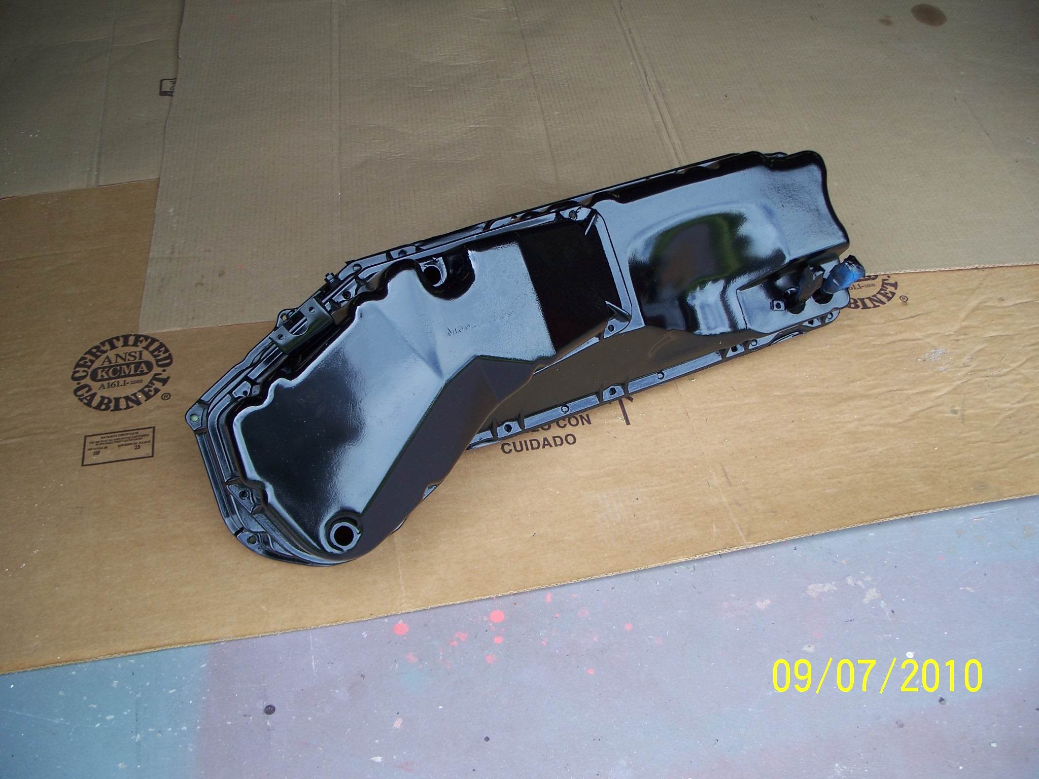

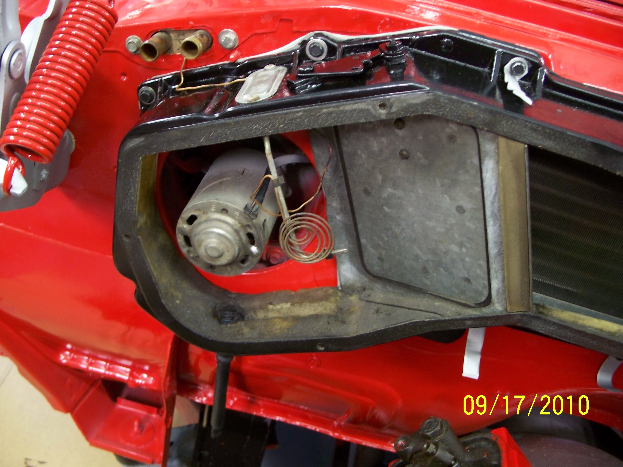

A/C heater Plenum - Gloss black.
Heater core goes there.

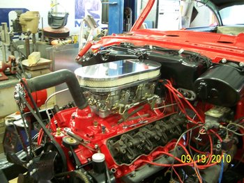

Plenum all buttoned up, 2 fours fitted.
Heavy cast Alum air cleaner $94 on ebay. Beats $600 Plastic Repos.

WoW! I am running out of adjectives for your work!!! What type of paint did you use on the Fiberglass Heater/AC box, Shure is pretty parder!

I'm interested in type of paint of heater box too, looks sharp.

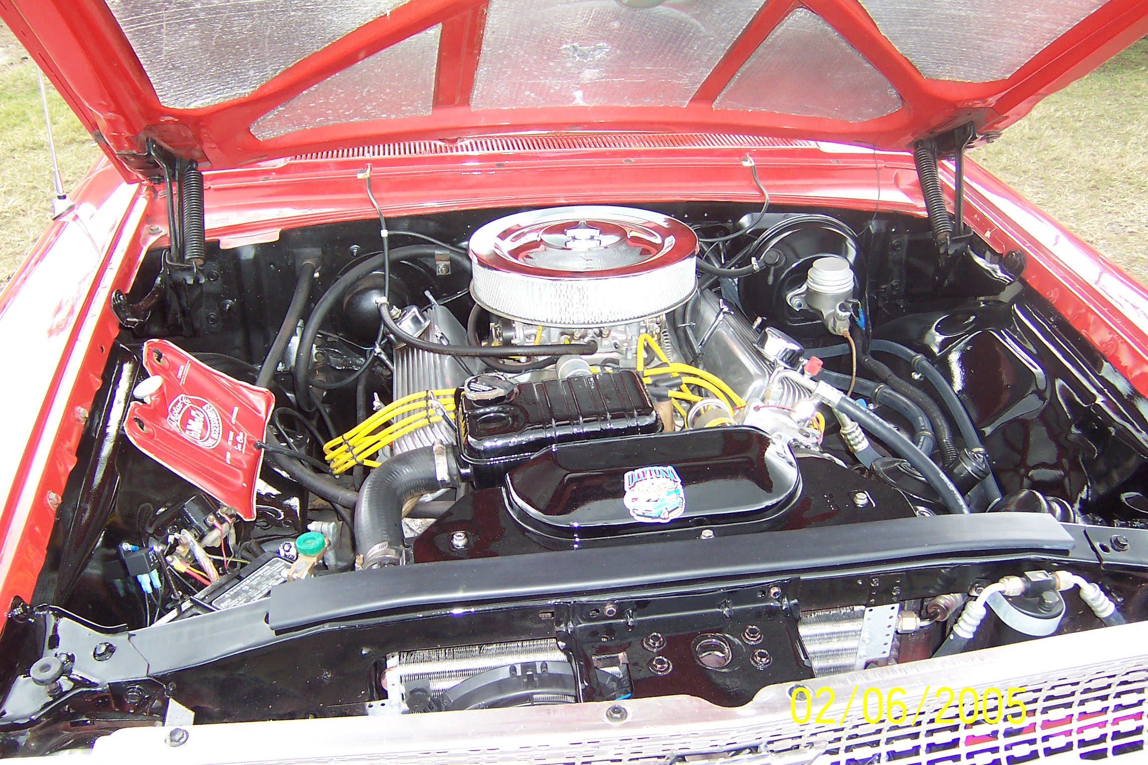

Thanks Guys - Believe it or not it's Rust 0 leum rattle can "APPLIANCE EPOXY" gloss black. Got it at Home Depot, was using thier regular gloss black but not anymore, same with white. I detailed the engine compartment of my 63 Galaxie with the reqular gloss black and it came out nice but I wish I had known about the Appliance paint then. See pictures.

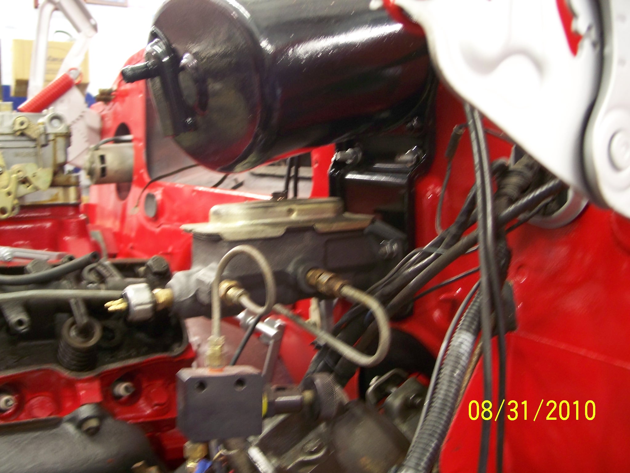

Looks great Dick. See you've utilized a solid canister brake booster. Were these also used on Plyms and are they interchangeable?? Just curious as i'm all set with the bellows style now thanks to John and Roger. Great Work!!
