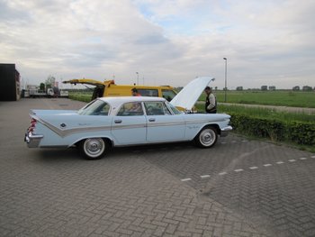

Sunday we went to the Spring Jukebox Fair in Rosmalen and had a long but wonderful day. We met our friend Andre halfway and drove up to Rosmalen together. Unfortunately Andre had car trouble on our way there, he was losing power and had to make a stop :evil: We were able to get the car to the exit and checked under the hood, everything looks brand new and we couldn't find a thing wrong. After 15 minutes we decided to try again and the car ran strong as ever although Andre was a little worried and did not drive very fast, but I was able to stay awake.
We arrived early enough to get a good parking spot and reserved some extra space for our visitors. Marjo's oldest son Robin and his girlfriend Marjan were coming to visit us there, Marjan's brother and his girlfriend came with them. We had a wonderful day with lots of fun and lots of car talk. We did not buy anything at the fair (for the first time in 12 years) but really enjoyed it. Around 5 PM we decided to say goodbye to our visitors and drive home.
And again we had to stop, Andre's engine lost power again. We got to the exit and found a safe place to park and he called the AAA. After waiting for a very long time help arrived but he couldn't find anything wrong and the car was running fine again. We agreed that he would follow Andre for at least 10 miles to see if it would happen again. After 5 miles we saw a bit of black smoke coming from the exhaust and he lost speed again :oops: Then the AAA guy told Andre to find a safe place and wait for a tow truck. We had to wait for a very long time until the truck arrived and we were cold and hungry by then. Andre drove his Desoto on the truck and got in the truck himself, I gave Matthew the keys and let him drive the last part of the trip. It got dark and it started to rain but we got home safe at 11:30 PM.
We are lost about the problem with Andre's car so if anybody has suggestions please let us know! He has a 383 with a 4 barrel carb and a electric fuel pump. He had this problem before (and more than once) and he tried almost everything: rebuilt carb (2x), new cables, all distributor parts were replaced at least once and he added a second fuel filter between the tank and the pump. Some times he has no problem at all and then it just happens after an hour of driving at a regular cruise speed. He loses power and there is some black smoke from the exhaust but the engine keeps running. Mayby to much fuel or maybe not enough ??? But why is it only happening now and then :?

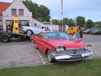

Andre's DeSoto and my SF parked together

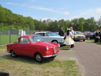

Big and small (Goggomobile)

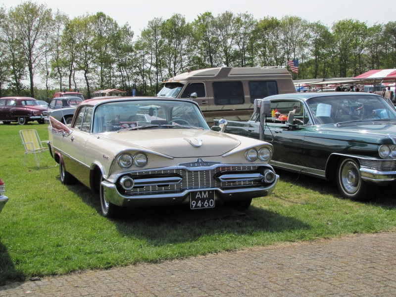

Beautiful 59 Dodge 4dr hardtop

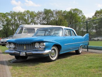

60 Adventurer

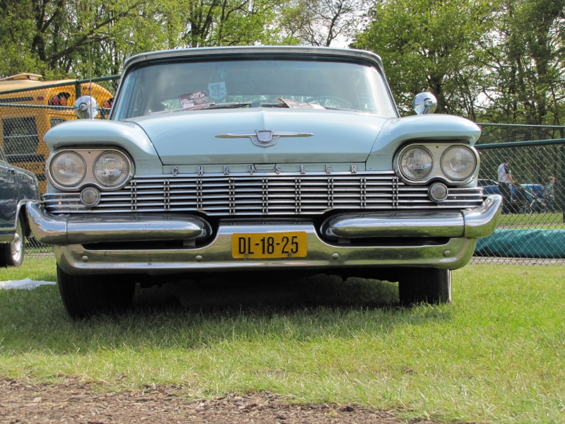

59 Chrysler New Yorker
