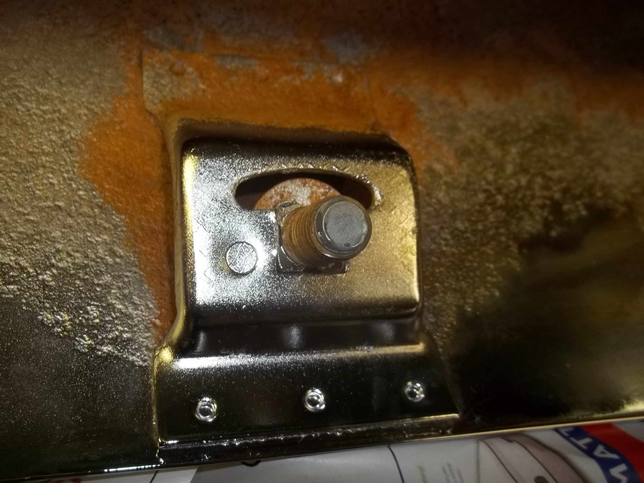

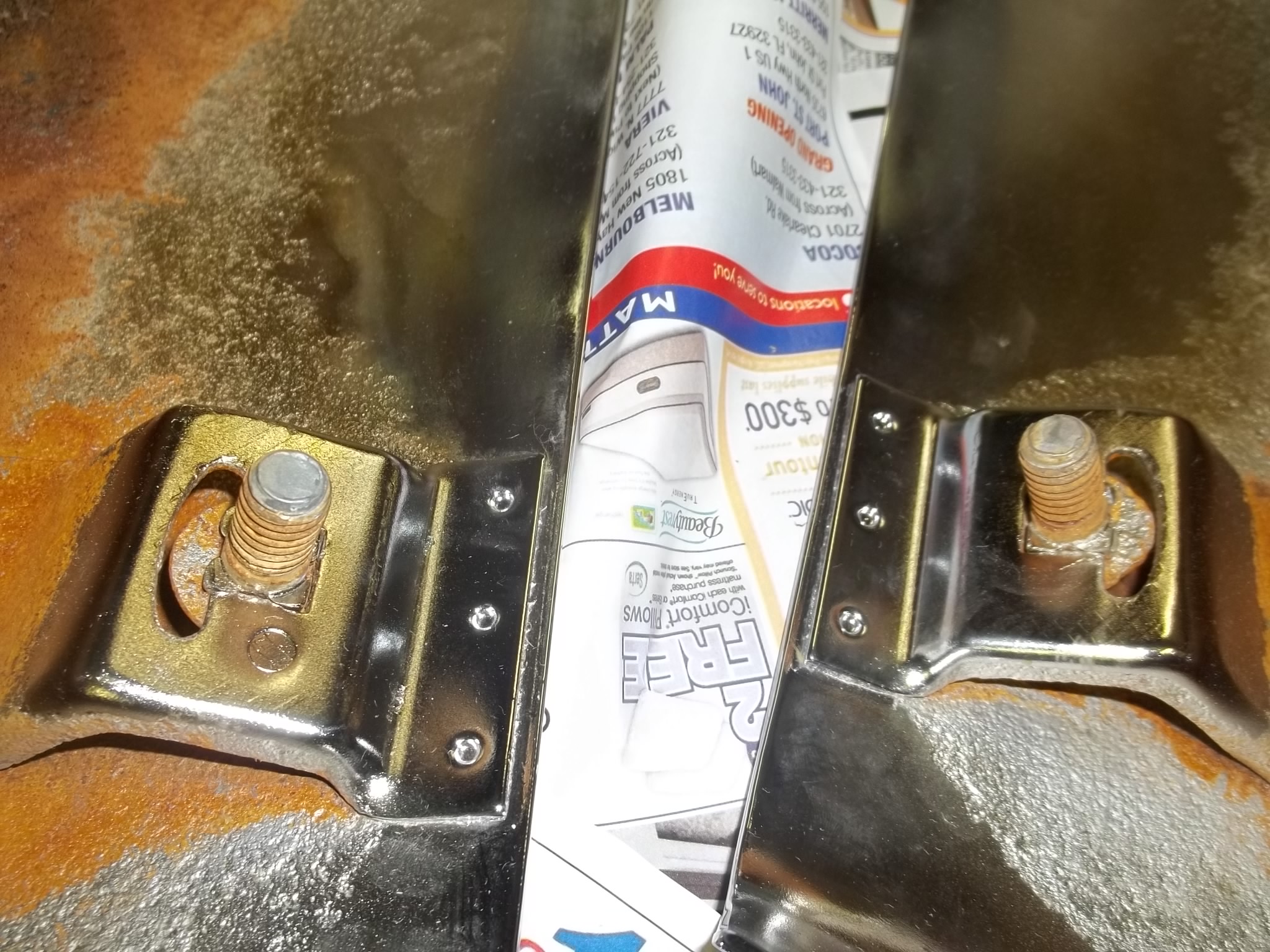

Now one more pic that I need, I will send my number wings in to get plated soon, On the inside of the wing, There is a bumper bolt tack welded on mine (one of them is broke and I will need to replace it) Are your inner number wing bolt tacked in or posse for adjustment purposes for fitting to the main bumper? No rush on this one but I know your front bumper is off and thought I can get a picture of that area and some of your wise sage advice...

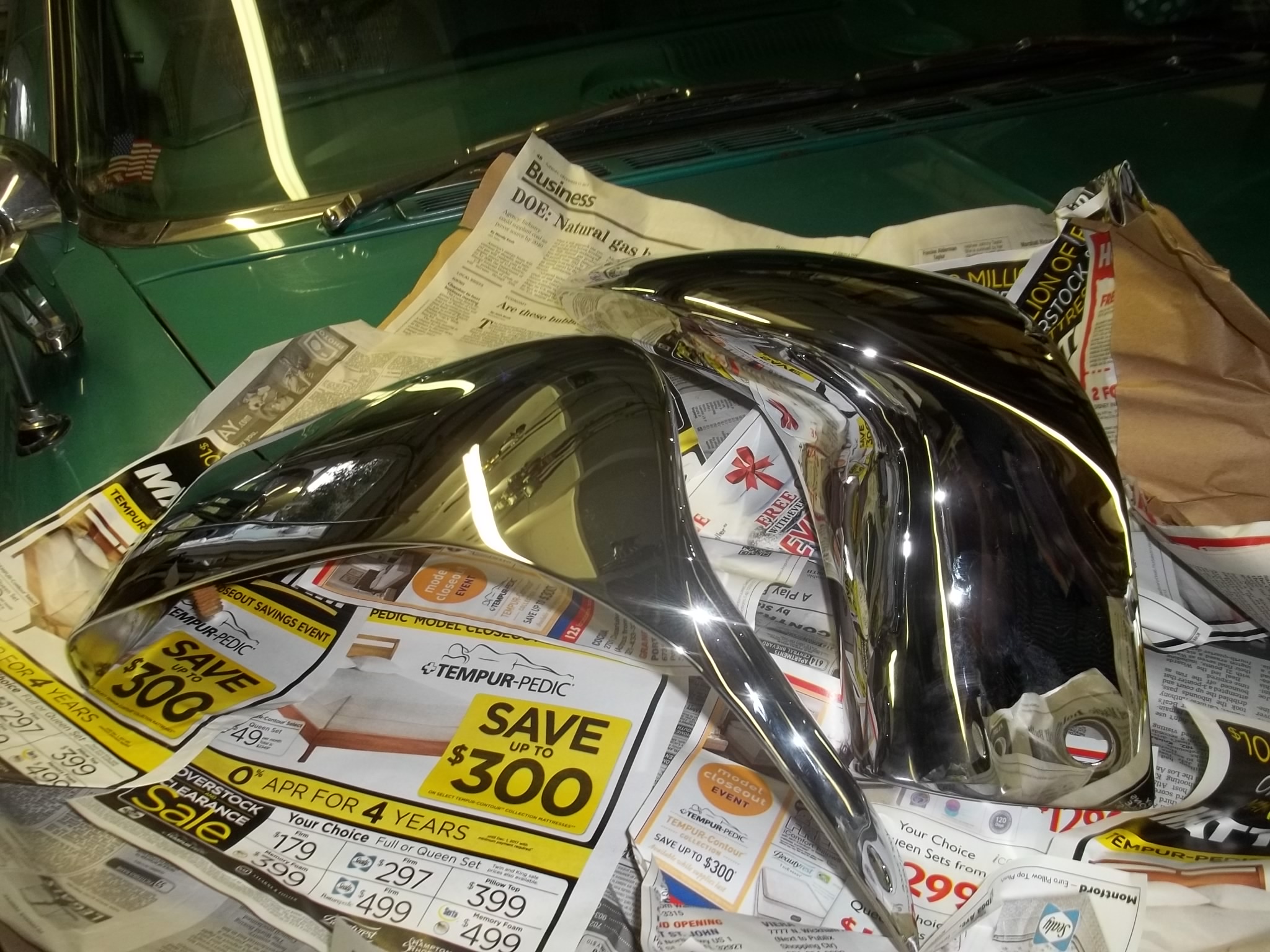

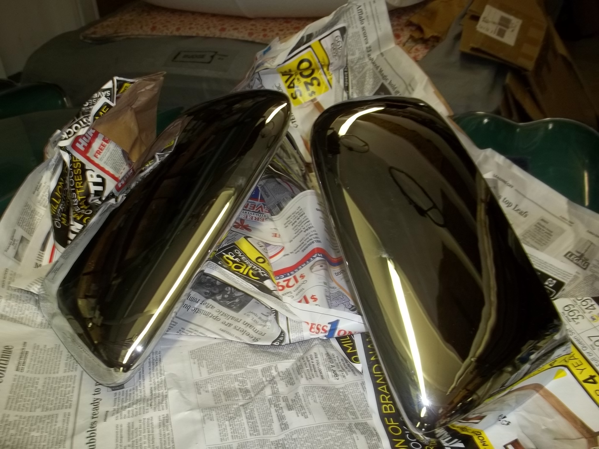

Regarding the bumper wings, that's bumper John, not number! heh, heh. It's funny you asked, the other day my Plater in Melbourne, Fl. (110 miles) called and said ALL my stuff was ready. I jumped in my Van and drove up to get my stuff to find out they made a Boo Boo and found out all was ready but the bumpers. They gave me twenty buck for lunch and my trouble. How nice. Anyway, I have my bumper wings so here are the pictures. The bolts on mine are crimped in place with very little movement. That bolts fits into the Valance. It looks like the bolt can be replaced because of the slot the head of the bolt can fit into.

Dick, Wow! Nice bumper wings! I will have to get you re-chromer name. My guy went out of business who did my bumpers.. Thanks for showing those bolts on the inside of the wings. Are they slipped in loose or tacked in fixed with a welder? Yours look they just slipped in...

John - I'm guessing the bolts were crimped in place before the bracket was welded to the wing. The bolts are not spot welded because they can be wiggled slightly. If your wings have that elongated slot the head of the bolt should slip right in and then be spot welded to hold it in place. If necessary the slot could be opened up slightly without doing any harm. My plater is www.spacecoast-plating.com. He charged me a $140.00 each. They enjoy a reputation as one of the best platers around..

Thanks Dick! One of my wings bolt was broken off before I picked them up a year ago, It looks like I could indeed pry a little on the bracket to get the busted bolt out (after grinding down the old tack weld off course) I will do this before I send them to your guy to do.
