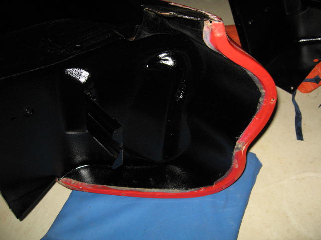

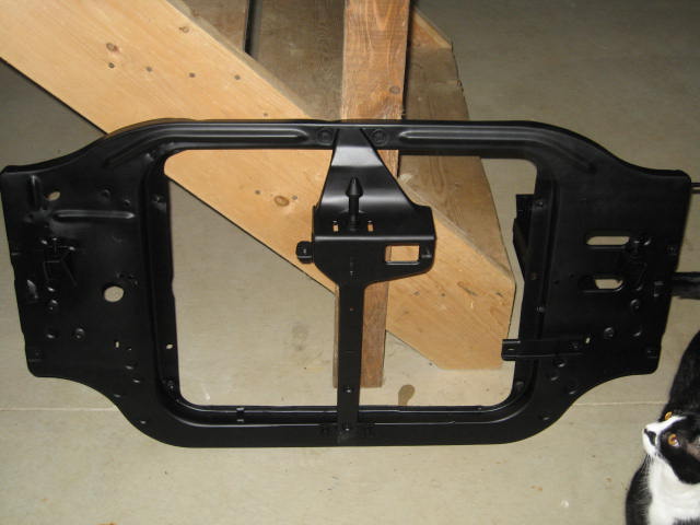

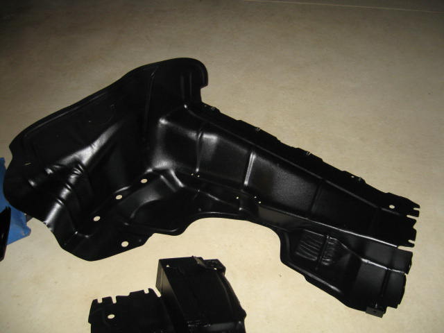

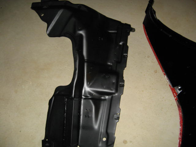

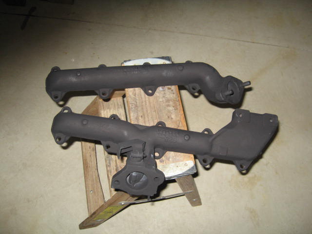

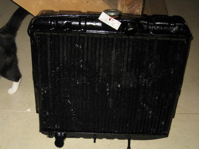

Not much happening,still waiting for the motor,I did get the front clip done.Core support,inner fenders,satin black.Also painted the outer skins,and had the battery box area repaired,it had some corrosion,must of had a battery leak at some point.Got the radiator flushed and checked for leaks(none),and primed and painted the exhaust manifolds with VHT high temp paint,took them to work and "cooked" them in the oven.Everything looks like new,all the hardware comes off easily because of the lack of rust.I am going to clean/replace all hardware.The inner tire area was done satin black but with A light "splatter" effect,turned out nice!! Got my core support rubber the other day,probably do the distributor next. Mark M

I remember trying to stay factory original with my car, doing the inner fenders in satin black, but the fender wells were done with dove grey, similar to the underside of the trunk floor. I didnt bead-blast and prime the insides of the fenders, just cleaned and spray-canned, so they weren't pretty for long.

Roger; Some things are going to be my own idea,it is hard to stay with the factory,I have seen some differences depending what factory they where built,your right about the ivory.My biggest challenge is going to be the interior(probably next winter) the car exterior is going to be flame red/white,but I am not nuts about the factory interior color choices.The original interior is red/gray with gray headliner and gray window trim,I was thinking red/white inlay tuck and roll,light headliner(bone),black or red dash.Anyway that is down the road and i'll look around and come up with something hopefully by then.Seems like the interior choices back then were very nuetral.All the pieces in the pics were shot or glass beaded they cleaned up wonderful. Thanks Mark M

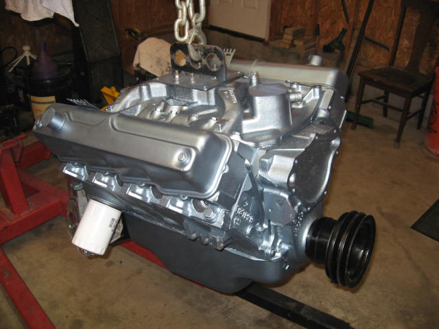

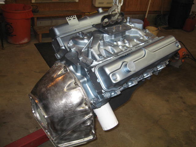

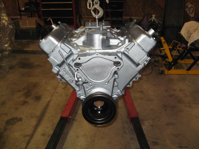

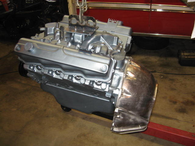

Got the motor back,now the fun begins.bored .030 over,crank ground .010,it is painted VHT #403 titanium silver,has A blue tint.going to marry it up to the tranny next.Bye for now, Mark M

Very nice Mark......engine looks fantastic mate!!

Looks like a component from United Starship Enterprise!
Sharp!

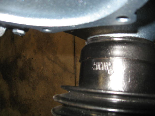

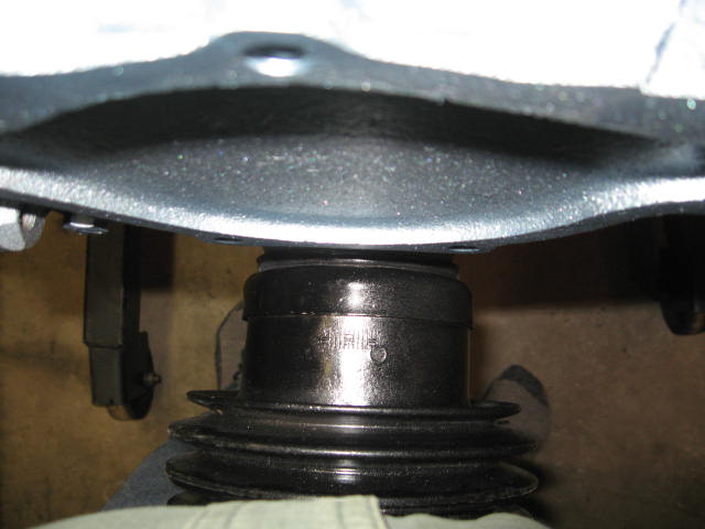

Question: Does anyone know why there is A timing mark degree scale stamped on the harmonic balancer? I have the one that is attached to the block(2 bolts), the harmonic balancer has the line(slash stamp), and lines up correctly with top dead center.The stamped scale 0 thru 10,before and after,is sitting at about 1:00 clock (the one stamped on the balancer) is there another line up mark on the water pump? I removed the scale on the block to get A better picture of the balancer,I don't know why they would have two degree scale guides. Thanks Mark M

My 57 has the timing marks on the pully too.........could be off a 57?
Posts: 2217
Re: Marks winter of "59"
Mark - My 318 "A" Block has a pointer attached with two bolts on the water pump and a line on the crank pulley, no timing degree marks anywhere, it's my understanding the 318 "A" Block has no harmonic balancer on the cranc pulley, it's balanced internally. I also have a 3i8 "LA" Block and it has a harmonic balancer on the crank pulley.
