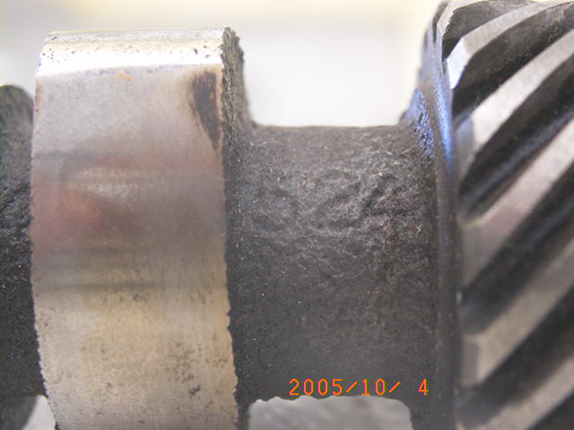

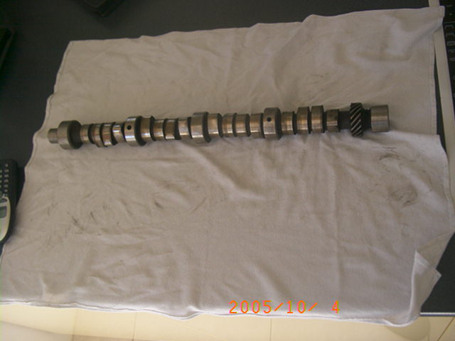

In a box that came with my SF almost 20 years ago I found a camshaft. It was told to me that this camshaft was the original one and was replaced just before the car was sold to me. The cam shows the number 524.
Here is the problem:
My 318 shows a compression of 130 psi. on each single piston, what’s inside the required tolerance of 125 – 160 psi. Yet the engine appears very tired and doesn’t respond as I think it should.
The questions:
- Is it possible to identify the cam by this number (524) and if not how do I know what cam-lift and cam-duration this cam has?
- What is the Valve-Lift and Valve-Duration for the stock 318?
Thank You!
Stefan

Stefan,
The stock Fury grinds for 1957,58 were 256/.405 and 260/.405 respectively. Aftermarket grinds were approx. 240/.387 to 256/.400 or thereabouts.
The cam you have pictured is not a Poly camshaft and will not work in your Poly engine.
