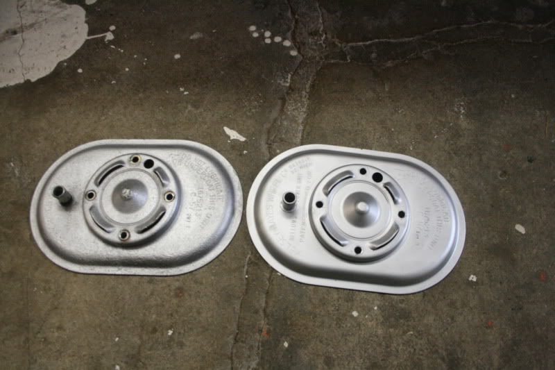

I switched the front plate of the brake booster as mine was a lot better.
On the left the one that was on the booster, on the right my freshly painted one

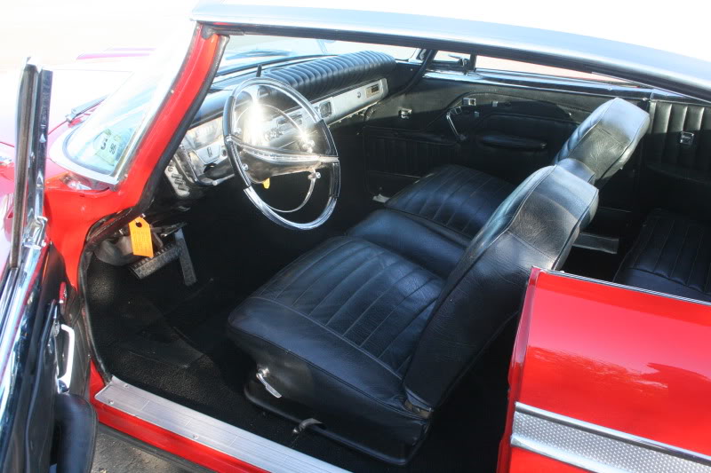

Got the seat back in and this is the result with the carpet

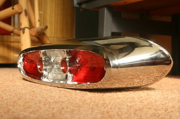

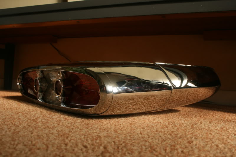

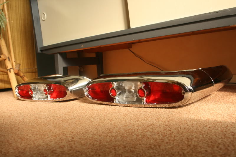

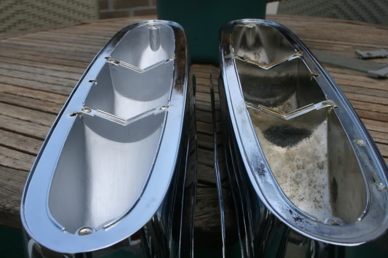

And finally we got our taillights back! New chrome on them make them a lot better looking.

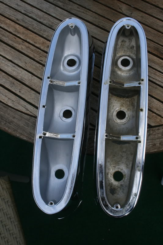

Had to paint the inside of the housing silver. 1 done
Beauty pic
And got them all back together. Still need to have the light bulb sockets but we ordered them today. Also need to install the gasket but will do that when the bulbs go in. I cleaned the reflectors and putted in new lenses to finish it.

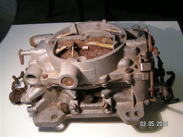

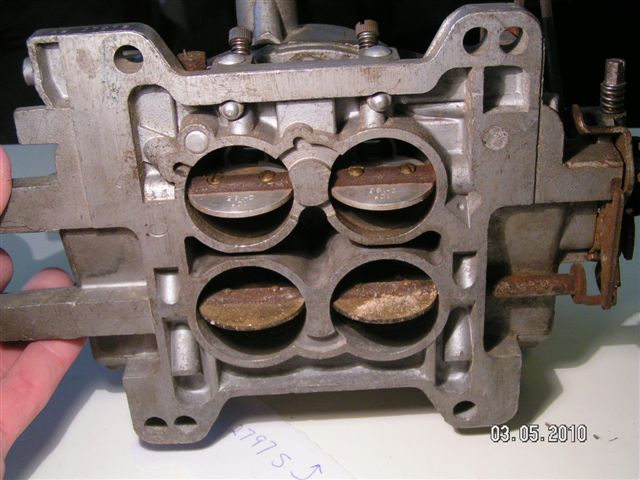

And then we have Andre's car, we want to get his car running as well as mine. He wants to try a new carb on it as we both believe that the problem comes from the carb. If anyone has a good 4bbl for a 59 383 engine for sale please let me know.

What a coincidence..I have a Carter 4 bbl carb, orignally from a 1959 Chrysler Saratoga 383. It needs a general rebuild, but it is not stuck or broken, as far as I can tell.
I could have it rebuilt here, then ship to you. I will email you pix, as I am still too stubborn /lazy to learn how to post pics on this Forum.

Roger, thanks for the offer!! I will call Andre this weekend and ask him what he wants, he can see the pictures in this topic:

Hi Matthew - I'm going to pick up my bumpers today and bringing the tailights to get a price on rechroming. I'm assuming you have to remove all the sockets etc. How difficult is it to remove them and what was your cost in dollars in haveing yours rechromed if you don't mind sharing. I'm assuming it's quite expensive. Really can't wait for you to get here, I have a nice old quilt right next to the lift post where you will be chained. Oh, I greased the chain so you won't have any chafing, so you should be quite comfortable.
Matthew Keij
Posts: 1405
Re: repaint!
Post by Matthew Keij »
Dick, if you remove the lenses you can see a little lip. That is the lip holding the socket into the housing.
You can try to bend them up to get the socket out. I tookma hammer and gave the sockets some taps to the side so the lip bend a little bit. Then I did the rest with a screwdriver.
Be very careful with the hammer! I tried it on an old housing first. If you do it too much/hard the housing can crack!
Do you have replacement sockets?
It was around $500 for both of them to rechrome.
I'll be fine with that. As long as there are some drinks and food I'll be ok :lol:

Matthew Keij wrote:It was around $500 for both of them to rechrome.
Dick, I know better as I paid for it.... the total cost of rechroming the taillights was € 200. But we discovered that one of the parts had a crack after we got it back so I sent out another bezel and that cost another € 50. With the current USD/Euro rate that is about $350.

Matthew/Ron - Just got back from picking up my Show Quality Bumpers $500 Rear, $550 Front, Wings $140 each, Guards $75 each. Not cheap but the Best Reputation around. They came out wonderfully. The price they gave me on the Taillight is: $75 for side extensions, $100 for Bezels, $180 for main housing. Total $355 a side. They have no deep pitting, just pin prick spots but a lot of them. I asked about taking the sockets out and he said all I had to do was cut the wires take the guts out and leave the metal parts of the socket in the housing. After plating all I have to do is insert the contacts and solder the wires back together. Sounds like a plan to me. Don't you wish you had thought of that. heh, heh. I figure the price is pretty good considering I got a price from a company in Orlando a couple of years ago that specializes in chrome plating pot metal. He wanted $800 per side.
rogerh
Posts: 3024
Location: Seabeck, Wa.
Re: repaint!
Post by rogerh »
Although good in theory, when the parts get re-plated, the sockets also get a coating, and now the bulbs won't fit. Best to rip the sockets out now, get a thorough chrome job, then install new sockets. :)
