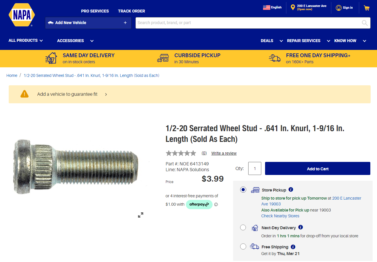

Where is the loose fit? Is it in the holes in the drum around the studs? This from the article:
Here's where the fun begins. You now need to press in new studs. The stock lug bolts on these old Mopars are 1/2-20 UNF thread with a 0.622" knurl. The knurl is the ridged part of the stud that fits into the hub. In order to have a good tight press fit you need to make sure whatever stud you use has a knurl size of at least 0.622", but it can't be too large either. If it's too large, it will be difficult to press in and you stand a chance of damaging the hub. NAPA has studs that have a 0.623" knurl (part number BK 641-1128) and these work very well.
Is it possible that the threaded portion of the studs you pressed into the hub is slightly undersized? Did you use BK 641-1128s?
Posts: 5133
Re: Tapered Axle Rear Brake Conversion
Then again: Those studs were recommended for the 10" drums. So I guess that is a question for Matthew - I'll try to get him to comment.
