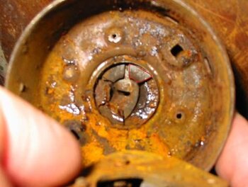

But, remember that retainer I broke? Here's the pic:
Tom had said:
For whatever reason, there was about 3/8" of play in the shaft. Tom was right -- without any play, the bushing can't go anywhere, and the armature remains centered. But with this play, the armature centers in the stator with energy applied, lifting it (and the bushing!) 3/8 of an inch, allowing the armature to move off center and bind with the stator.tomf wrote:Hi Dan, I believe the retainer is there for assembly purposes, so it doesn't fall out, If you get the bushing off the shaft and free to turn, I would assemble the motor and not worry about the retainer. Once it's together, the bushing can't go anywhere...

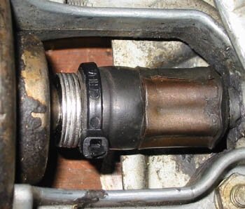

As TWSAM (The World's Slowest Auto Mechanic), I finally got the regulator and window back in the driver's side rear. The motor worked beautifully -- until, the star gear worked it's way out of the rubber connector, despite the tie wrap around it:

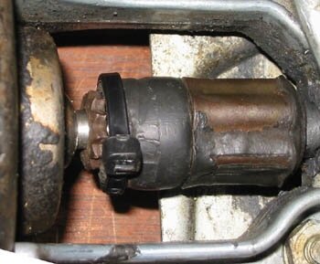

Having not fully exhausted my "washer trick", I pulled the assembly back out, put some lithium grease on the interior flat surfaces of the washers (not quite sure what lithium does to rubber), put a stack on the shaft to prevent the gear from working its way out again, replaced the tie wrap, like so:
So far, it seems to be holding up. The window goes up and down quite nicely...
