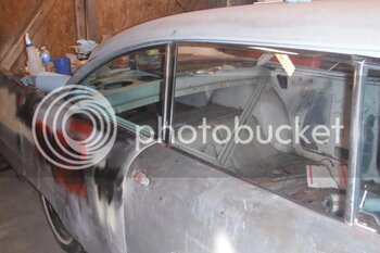

Out of sequece but earlier this year I bought a parts car, and dismantled it, all the window regulators were cleaned and treated and greased up I installed all the sideglass, so all these parts wouldnt be lying around and possibly getting lost, Ill very likely remove it again when im into the body/paint

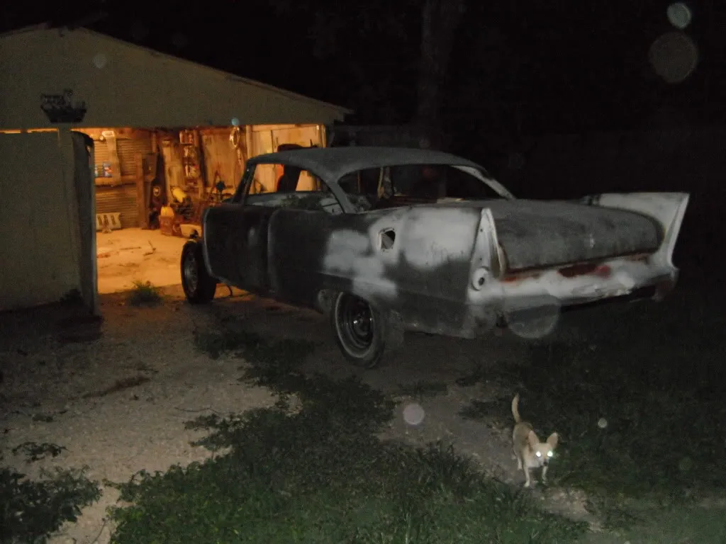

Very nIce! I like the picture with the car at night outside your garage....I think we have all been there....

Thanks John Q Its incredibly hot here I often wait till the sun starts going down to work on it,I cant wait to take that ugly primer off of it, Thanks John (Big M) Im Still learning from your 59' build!

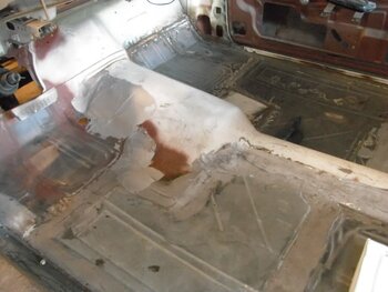

318fins
Posts: 27
Joined: Sun Sep 18, 2011 6:50 pm
Location: sa tx,USA
Re: 1958 Belvedere 2dr ht build
Post by 318fins »

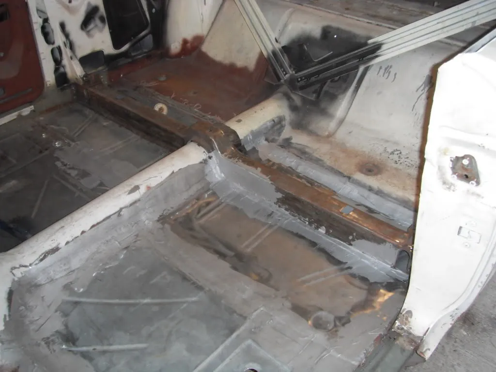

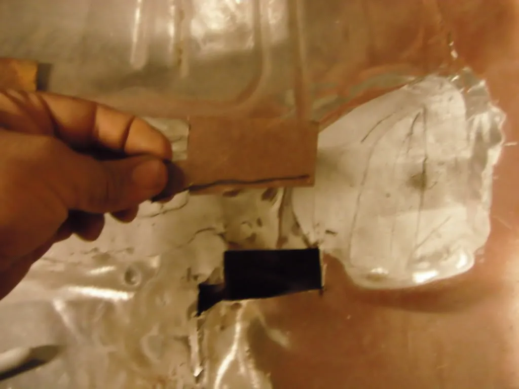

Thanks John Q Ive learned alot from watching Johns 59vert project in fact thats the project that made me take the full plunge on a project of this magnitude, I too bought a universal type harness from Ebay a few months back ill install it after paint, it too has with the GM type column thing, but ill go ahead and use it as your right the originals are way expensive and my car will never be a show car, Im trying to build a nice solid driver I can really put some miles on,especially country miles, the adavantage to the modern harness is you can add any accsesory easily like fuel injection,power windows ect..Im trying to stick to as original as I can afford mainly on the stuff thats easily seen exterior,wheels tires ect.Im doing a Christine car but Im seriousley considering painting her the original white, this car had a white body unsure of the top color, I actually wont make a final decision till im at the final stages of body prep work.In the final stages of the floor stuff,soon ill put the front clip on and start body/ paint.about 15-20 hours went into this rear seat beam worked on it this week,replaced some 90 degree sections as well as cleaned up and primerd the innermost parts.This part was supposed to be a breeze but proved a little laborious.
