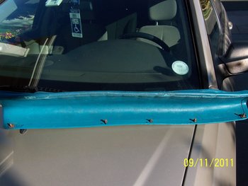

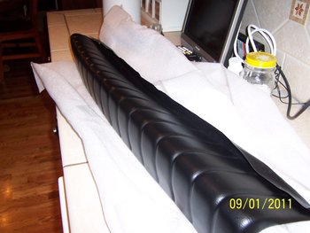

Matthew and I ordered two new Dash Pads from Just Dash's after a long wait... they came in. We both supplied our old metal strips to be molded into the new pad. Matthew's is Black and mine was a color match to the Turquoise paint of my Dash frame. Cost $100 more for this color match too!
Now you can't see the metal strip but I pass over the top part of my Pad (and Matthews too before I shipped it Holland) to verify that it indeed had the metal strip made into the pad.
I started with placing my pad with any clips used, over the two end holes that need would use the clips with the screw nut combo (both ends of the pad) by locating the pad visually on the dash frame left and right to where it should be mounted. (used old pictures of my car and other forum members cars too) . I then climbed underneath the dash and marked these two holes as being the anchor points for the pad.
I then peeled back the vinyl pad a bit and slipped these two fasteners with the screws on them under the metal strip ever so carefully. I then placed the pad back on the dash frame and again this time marked the spots where the spring clips would go on the strip. There are only 4 of these spring clip spots but I had only three spring clips. I then took the dash pad off and slipped these spring clips fasteners under the unseen metal strip and then just put it on the dash frame. Fit very well!
I then put the two speed nuts on the two end fasteners with the screw studs to securly anchor it down. Then I went about trimming the bottom extra fabric and with and awl, punched several holes where the lower reveal moulding would need to pass thru to anchor the bottom part. The are to the left of the glove box also gets tucked behind the anodized trim too.
I put this strip on but had only a few of those spring clips but put on what I had to have it 99% finished look. Need to stop by the local automotive trim store for some new push on fasteners that would work with this piece of reveal moulding and then it is done.
I was suprised how easy it was to do.
Matthews Black pad
ditto
ditto

On the lower dash fabric attachment strip, I used a more modern 1/2 molding clip with short stud on it and a speed nut. The clips I had were very rusty and seveal of them broke during my first attempt to install the lower horizontal trim strip to the dash pad. And they those that did not break had weak spring tension on them.
Though not correct, they provided great clamping action to the lower fabric of the new dash pad to the metal dash frame. I then reached inside and under the dash to put the speed nuts on and it looks great. It was easier to line up the dash holes and just press in. I did have the glove box out too!
On the assembly line it was quicker to use the OEM spring clips but using these fasteners are a better way to secure the strip and the lower dash pad fabric. No one will see the new way of attaching it for those who are into showing there cars for points at a judged show.
Old spring clip and the newer stud style clip hold tighter and keeps the lower dash pad strip from bowing out due to weak and old spring tension.
