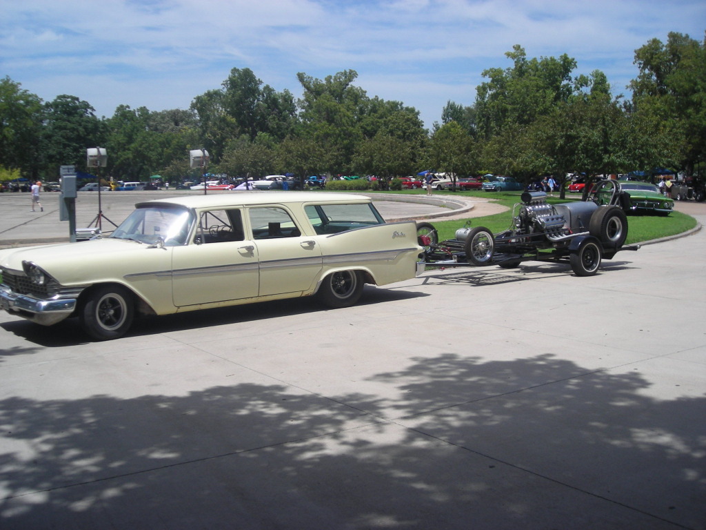

My name is Kerry and I've realized that I have become a Mopar guy. I've got a 354 hemi in my 31 Pontiac 5 window coupe, a 354 hemi in an early 60's Dragmaster I built, and now I'm tinkering with a 59 Plymouth Suburban.
I spent entirely to much on her as she was tired and rusty. In fact rusty again as she has had some sketchy body work and a quicky paint job.
I played with the old 318 for about a year till it became apparent the valve seats were shot and wearing fast. Instead of rebuilding the old stuff I got a donor 95 Dodge Ram 1500 and put it's 360 magnum in the wagon. I used an 89 Dodge D150 bell to adapt an A833 O/D four speed. It's a fairly high mileage engine but has gobs of power compared to the tired 318. It's great cruising down the interstate passing late models.
Now onto the body work. I've got the interior out and trying to address the rust. It's the usual floor pans, rocker panels, and eyebrows. Not sure what I'll find when I take the paint off.

I like you Suburban wagon! and the old School dragster! Nostalgia all the way!
What town and state are you out of?
Look forward to seeing more shots of the Suburban and the Dragster! :P

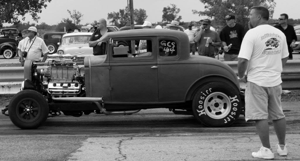

Thanks for the welcome guys. Gotta be careful about asking me for more pics. You don't know how many you'll get!! I'll start off easy. Here's one of my 31 Pontiac. It's got a 354 that I ran with 4 stromberg 97's before the 671 bug bit. I whittled the pulleys for the v-belt drive myself. Ran a best of 13.21 @ 102.3 with the Strombergs and a 12.10 @ 115.10 with the blower.

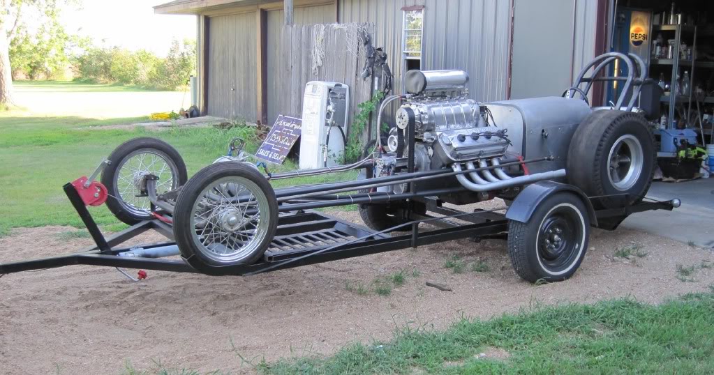

And here's the digger. It's a copy but not a pure recreation of a early 60's Dragmaster Dart. My only real concession to modern stuff is the shorty Turbo350 although I did beef up the cage in the back. I just couldn't afford what a good slipper clutch and bell cost. I've gotten down the track but not all that gracefully yet. Not trying to be competative, just trying to get some early sixties seat time. Got some bugs to work out. I'm addressing a couple of broken 1/4" pushrod adjusters now by having my rockers converted to adjustable (5/16 cup) and will make some 3/8 pushrods to length. The rockers hit the mail tomorrow.
