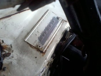

Dickjwa
Posts: 32
Joined: Thu Dec 18, 2014 11:35 am
Re: valve adjustment
Post by Dickjwa »
Thanks for your info. I was told it was a 277 but I I am glad to know what engines came in it.
