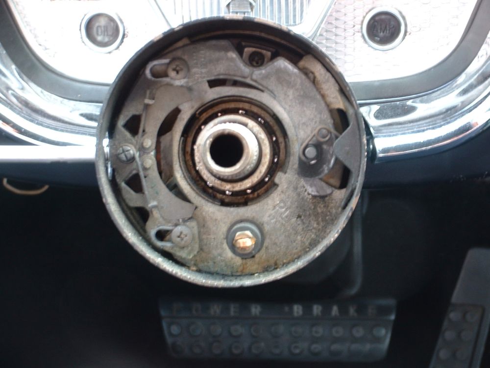

Dennis,
I do have a picture I took when I mounted my restored steering wheel.
Hope it helps, otherwise Roger gets a shot. I can also make pictures of matthew's steering column.

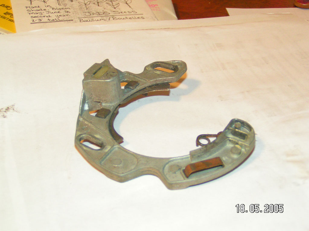

Thank you for the picture. It solved one of my problems, which was how the spring on the right side of the picture when on. There are a couple of other issuses. I have a piece of brass approximately a 1/4" wide and 3/4" to 7/8" long and bent that goes somewhere under the turn signal mechinism. I would like to find an exploded view of the turn signal switch area. This all started because my brake lights quit and I have traced it to the turn signal switch area. Brake light switch works, but nothing at the rear of the car. The Turn signals work fine. The turn signals will not stay detented when making a turn. I don't know if they ever produced a exploded view of that area of the steering colum. Any help would be welcomed.
thanks, Dennis balloon@lakeozarks.com
rogerh
Posts: 3024
Location: Seabeck, Wa.
Post by rogerh »
I do recall the slim brass strip..I wil have to disassemble the "parts steering wheel" to answer your question , which I have no problem with.

Roger offers this advice (and pic) to Dennis:
Roger wrote:Dennis,
Here is how I believe the turn signal switch contact should fit. Make sure all surfaces are clean..this is how Ground is maintained with these moveable parts. Let me know how it works out. I can copy the wiring diagram from the manual as well, if needed.
Roger
