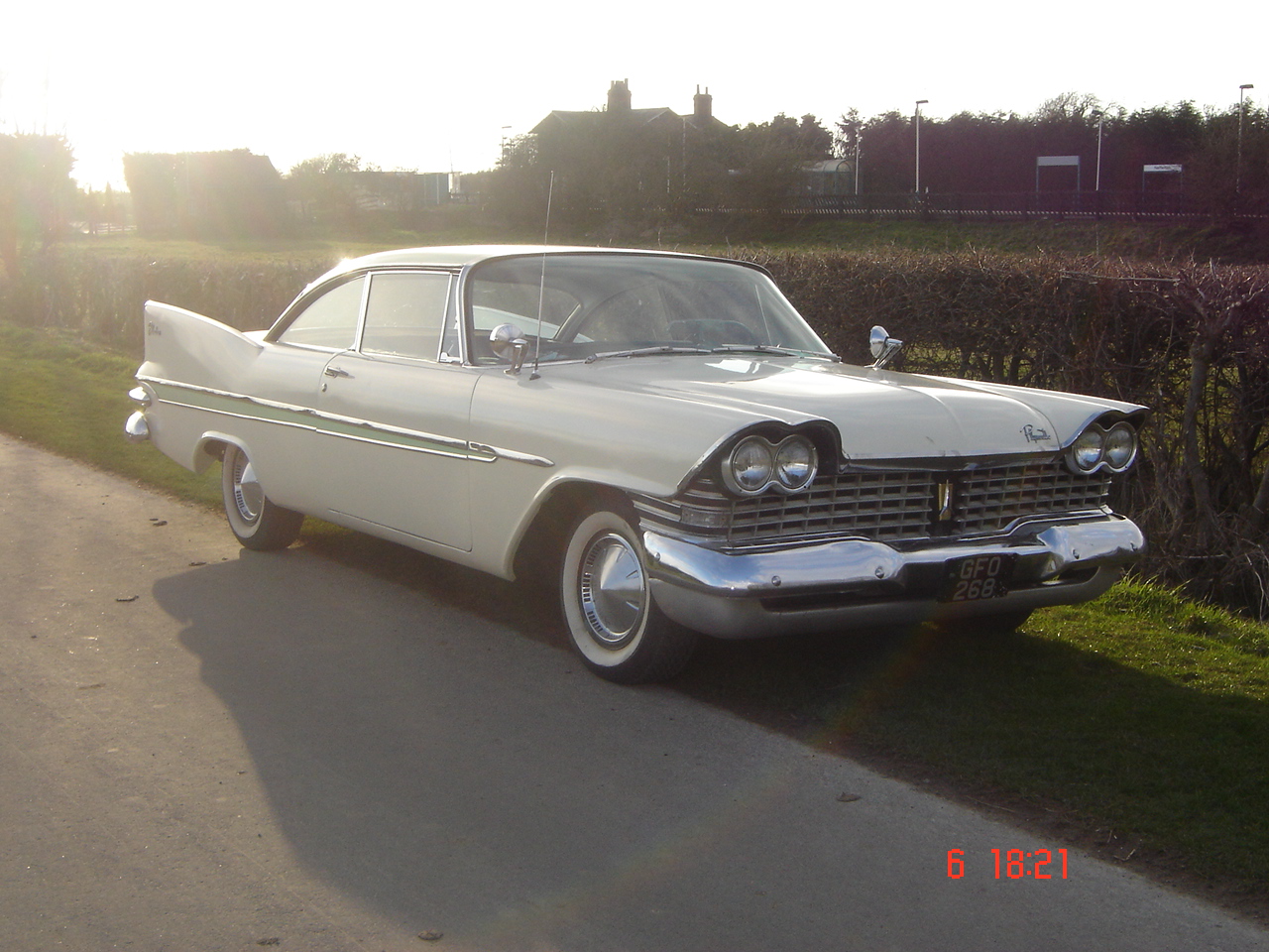

How does the headlamp switch come out of the dash :? I think mines burned out, no front lghts just tailamps.

Ahh sorted it now it pulls off with a good bit of effort, anyway the switch is fine turns out the dip switch is at fault :D
How areyou guys n the states? I am in the uk, i reckon theres only 3 or 4 about 4 2door ht in the uk cool eh?
Dan i am going to keep the old girl and fit a 440 in time, ilike the style not too keen on the polys performance though that said it really is great on fuel 8)
