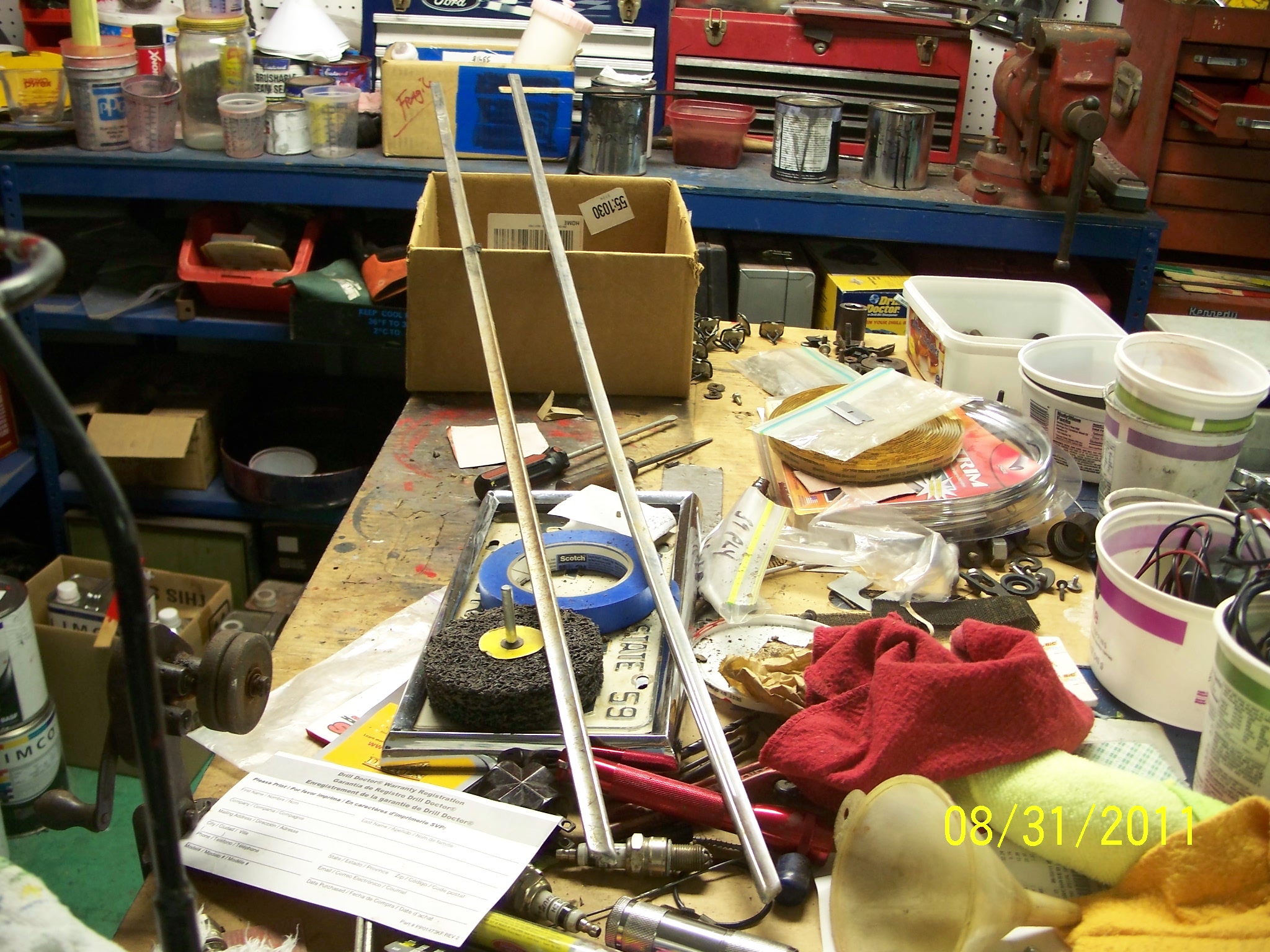

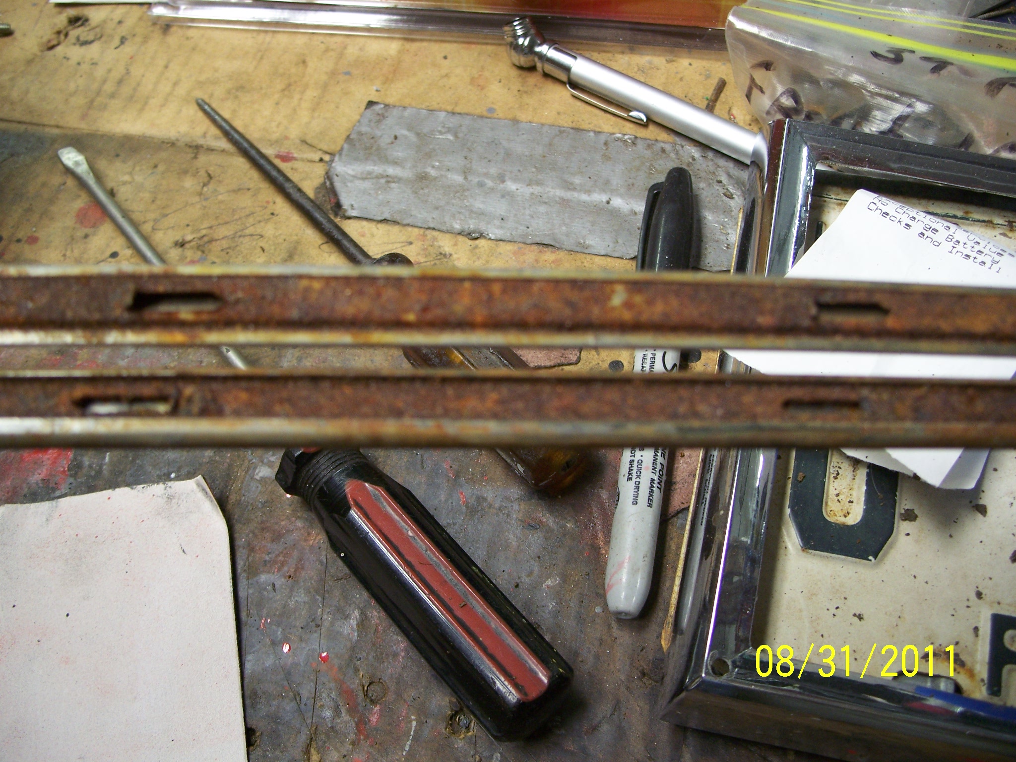

I'm looking for the curved trim piece for drivers side rear panel, mirror image to one in picture. Also both trim pieces for bottom of doors, they install just above the kick panel at bottom of door panel. These pieces have prongs that go thru the panel and then the prongs are bent over to hold them in place. The ones I have all the prongs are broken off, see pictures.

Dick, I had some of the prongs broken off on my trim, and I modified some fasteners to take their place. Find a small oval shaped one with a stud and reshape the oval until it will lock into the stainless lips. Some of these have a spring to hold them in, but the spring is usually lost in the grinding down of the plate. You will be mounting this trim where you can get to the back side of the panel with a nut or keeper of some kind, so keeping the plate locked in the channel is not a problem.

Actually I did not remove the strip as several of the prongs were still there. There is room for the fastener to go into the stainless. I did have to grind off what was left of a broken prong with a Dremmel, to get the fastener in place to use the same hole. You could put the fastener next to the broken prong and make a new hole, that would save the grinding.

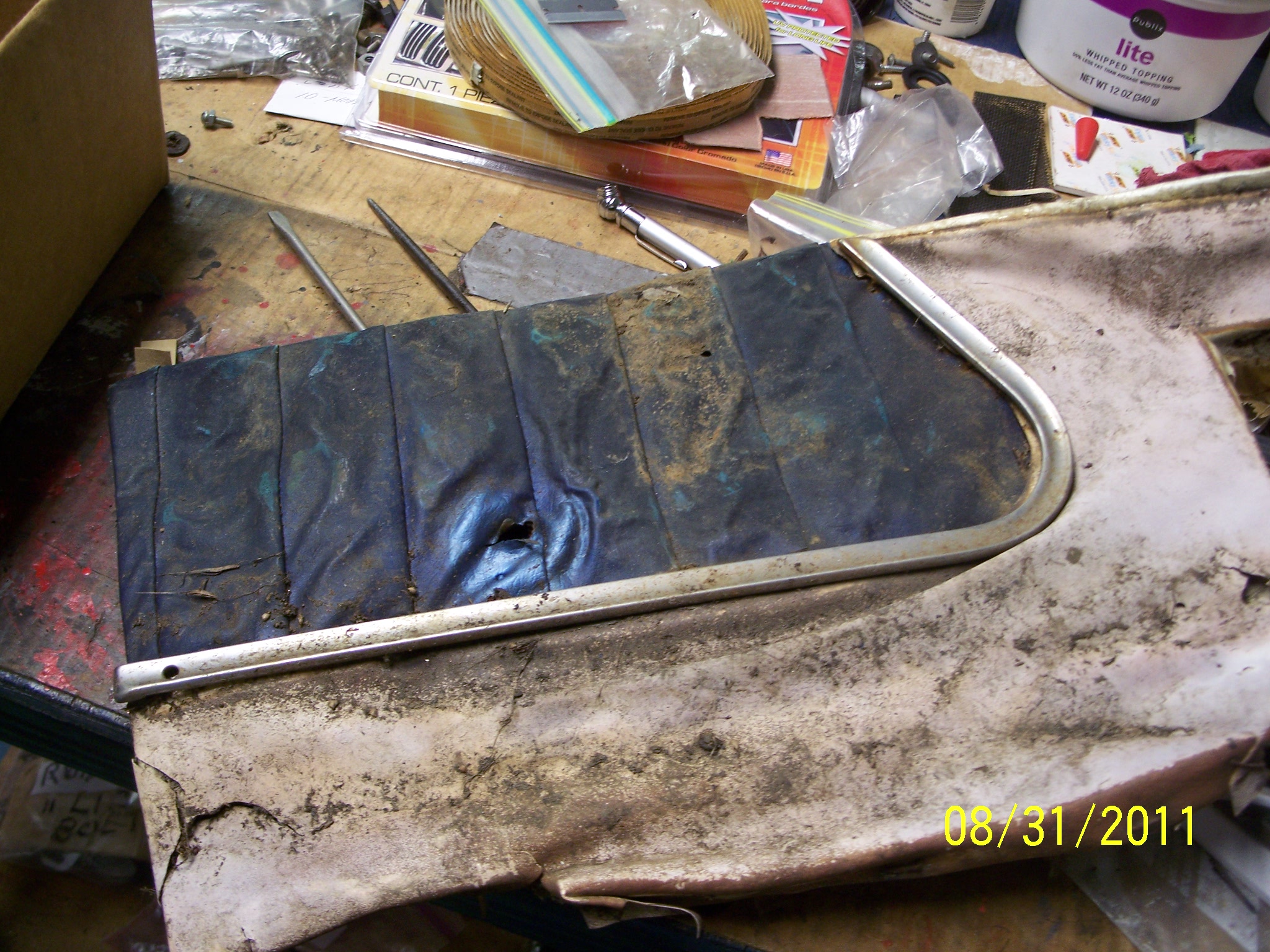

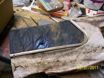

Dick, I was looking at the picture of your interior 1/4 widow panel and it looks totally different to mine and Tom Fox's panel. The molding you have looks to be a 58 model style not a 59. I will dig up a 58 vert picture in a few mins....

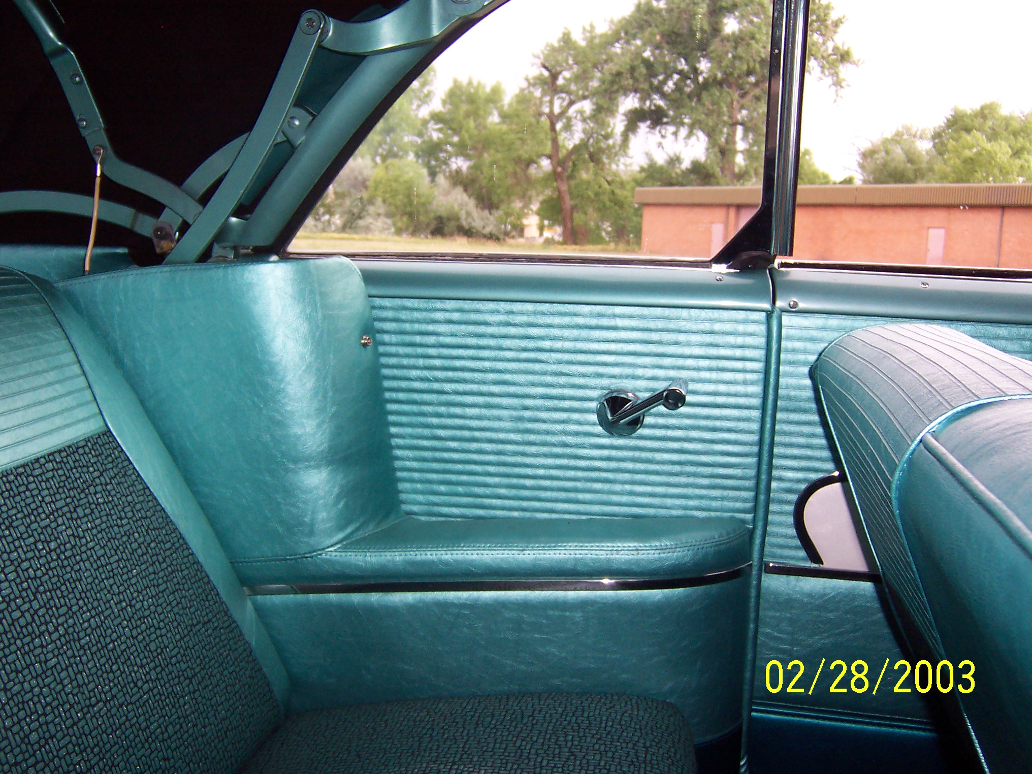

Here is a pic of what Tom's rear panel looks like, mine is configured the same way (just not as nice yet!)
Belvedere rear interior panel-Belvy has a single chrome strip going front to back only on the metal panel, not the cardbord part
Sport Fury rear interior panel This one has no strip, which I believe is correct for a SF vert

Alright, here is a pic of a 58 plymouth rear interior convert quarter window panel for comparison...
Moulding kicks up 90 degrees,
Posts: 2218
Re: INTERIOR PANEL TRIM - 59 BELVIE CONVERTIBLE
Thanks for the info John - Now my search is for either a passenger side curved on like in the 58 or two like in you and Tom's car. ARGGGGJJHH!!! Did I speel that rite.

My best guess is you need the 2 strips like Tom.
Maybe the one you have were used in early 59's but I remember yours is a late 59?

Dick, I will take a look at mine (metal strips) to see if they are similar to any other straight door panel trim that could be used on the rear metal panel. Curving another set of similar moldings would not be a problem to do sicne the bends are slight.
I have see the pictures of early 59's belvy convertible interiors (press car) and it has the molding style that Tom and I have. So don't know about the early or late production panels that may have crossed model years.

Dick, I just found 2 of the Tom Fox version strips here! They are in good condition
Posts: 2218
Unbelievable, who'd of thought there was any left in this world, I want em. The check is in the mail as soon as I find out the amount$. Plus shipping costs. You gotta be the best trim finder there is. Would you take a look see to see if you have the R & L strips that have the prongs on them, they go at the bottom of the door panel and seperate the vinyl from the carpet kick panel. Mine have no prongs.

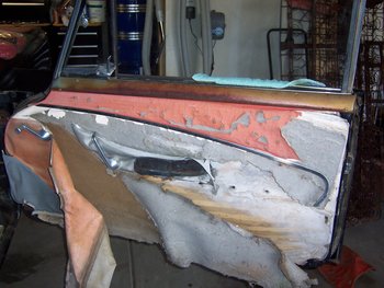

Dick, on the Belvedere door panels there are only two stainless strips. One above and one below the arm rest.Both are curved,one up and one down.
There is no straight strip that seperates the bottom color area at the lower edge of the door. SF's have them but Belvy's don't.
Here is another picture of Tom's car door panel and the original door panel (shot!) of mine.
Tom Fox's door panel
my old ratty one,no strip between the gray and the faded red/orange
