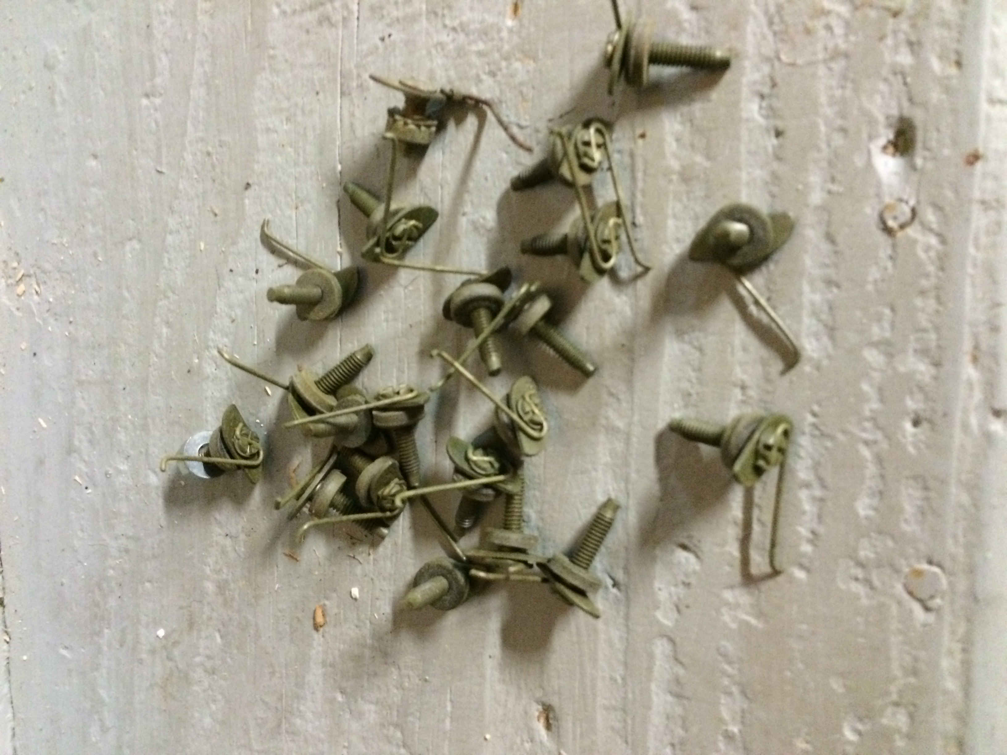

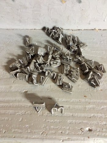

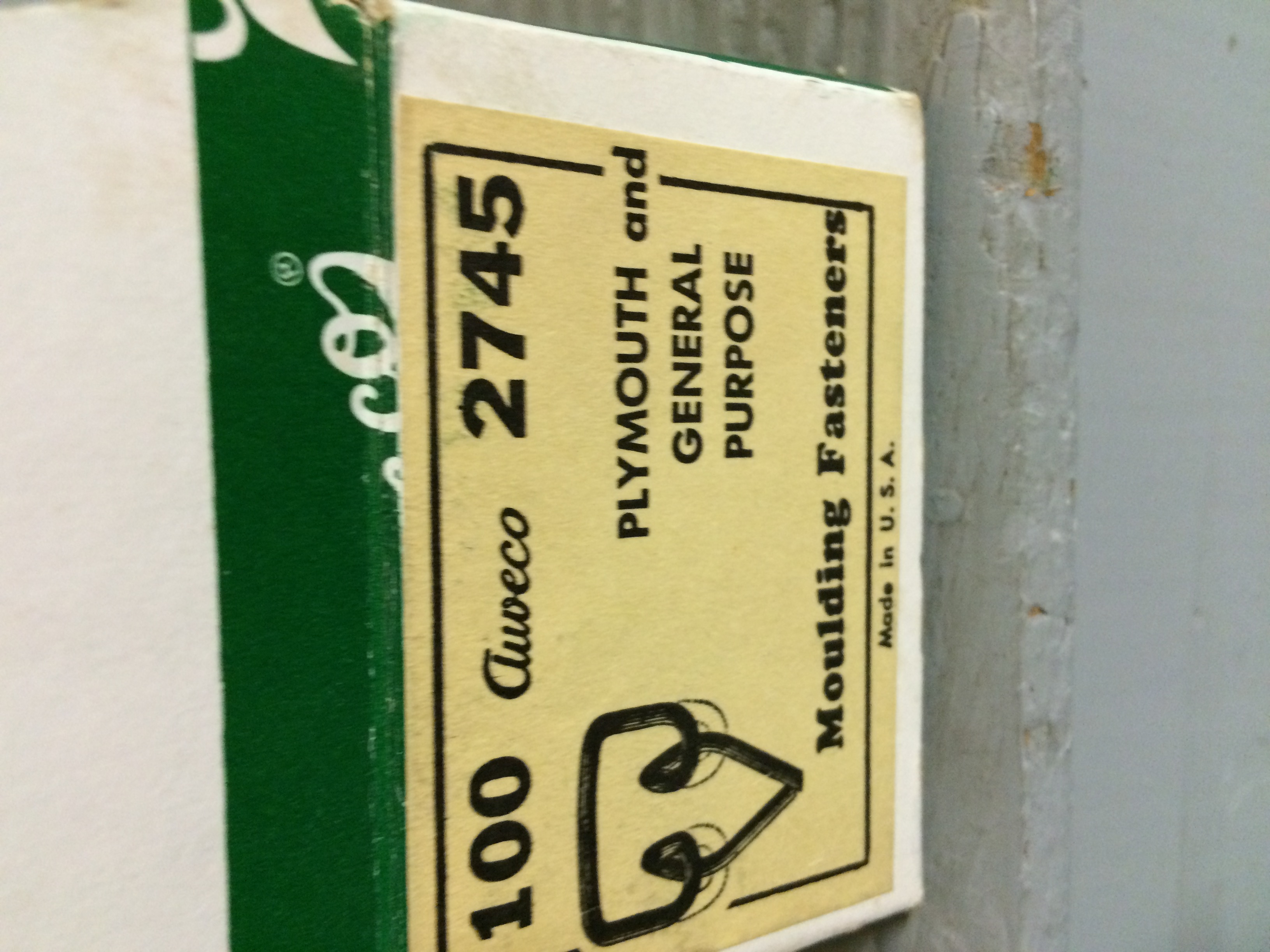

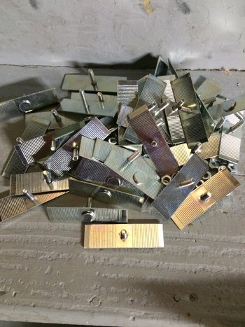

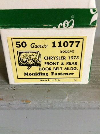

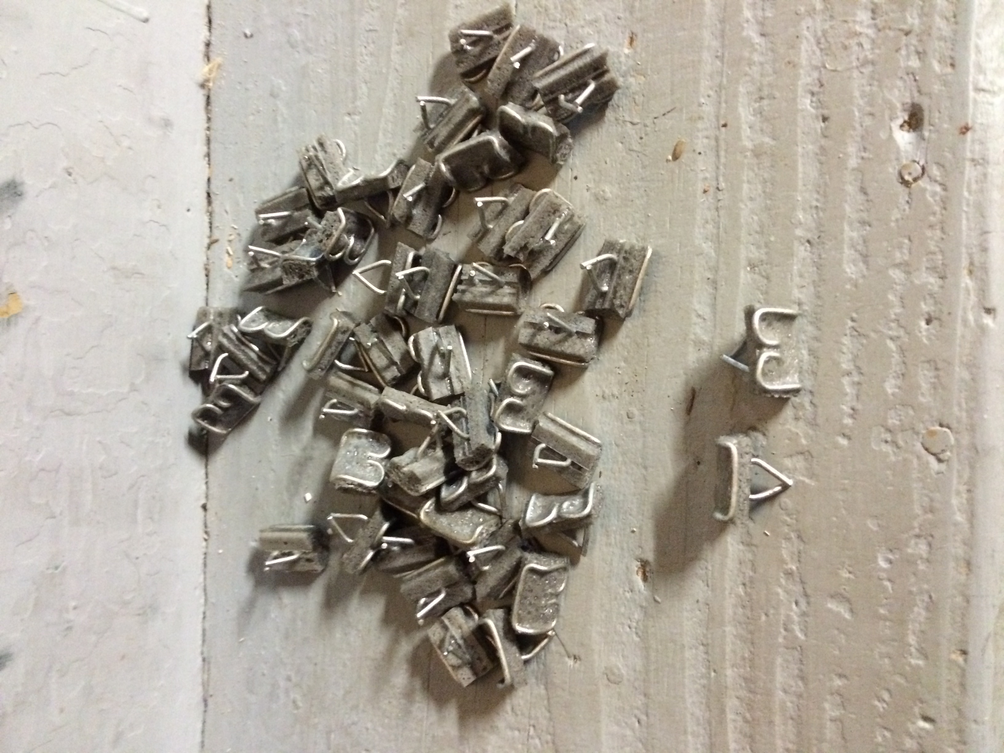

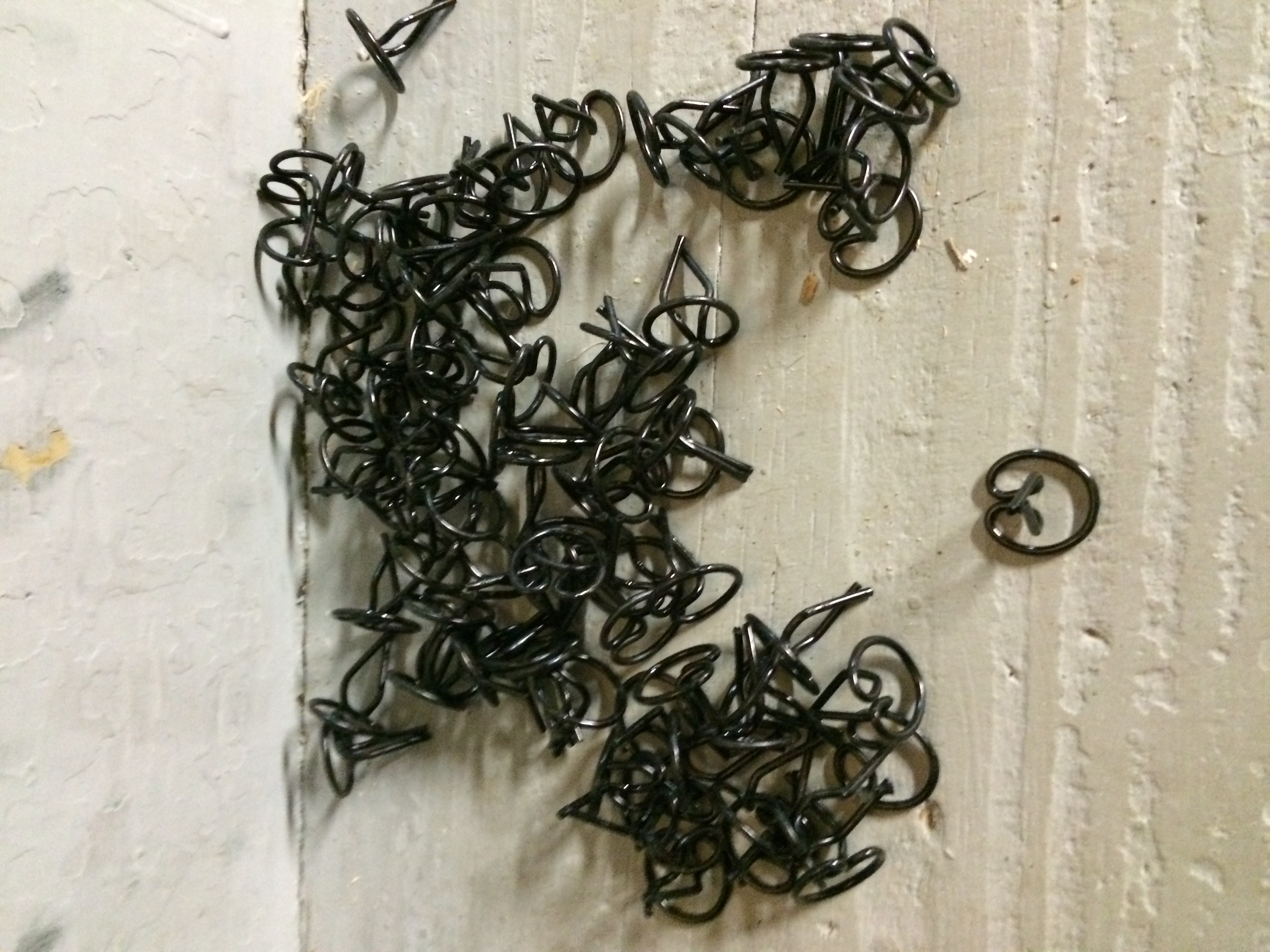

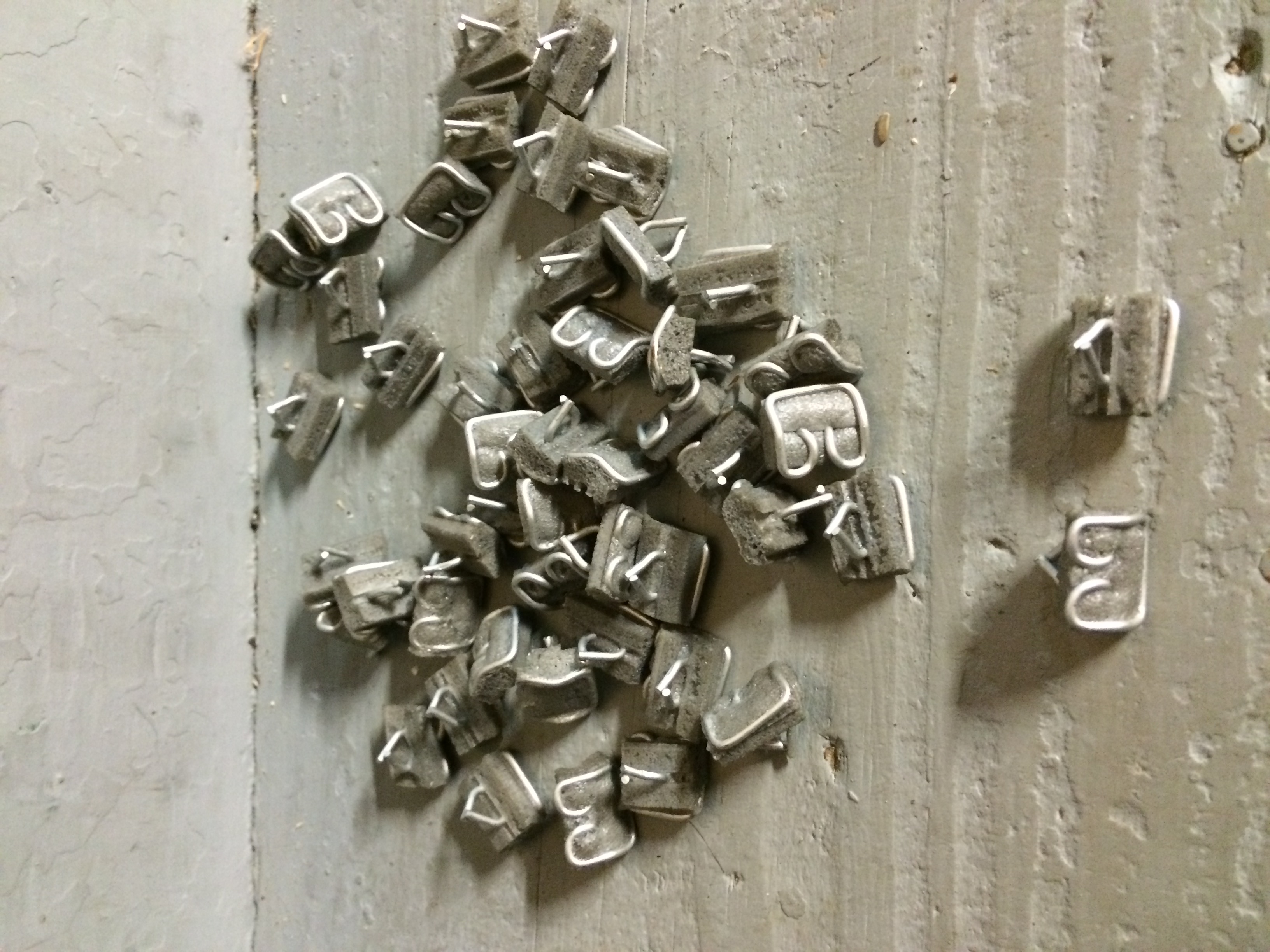

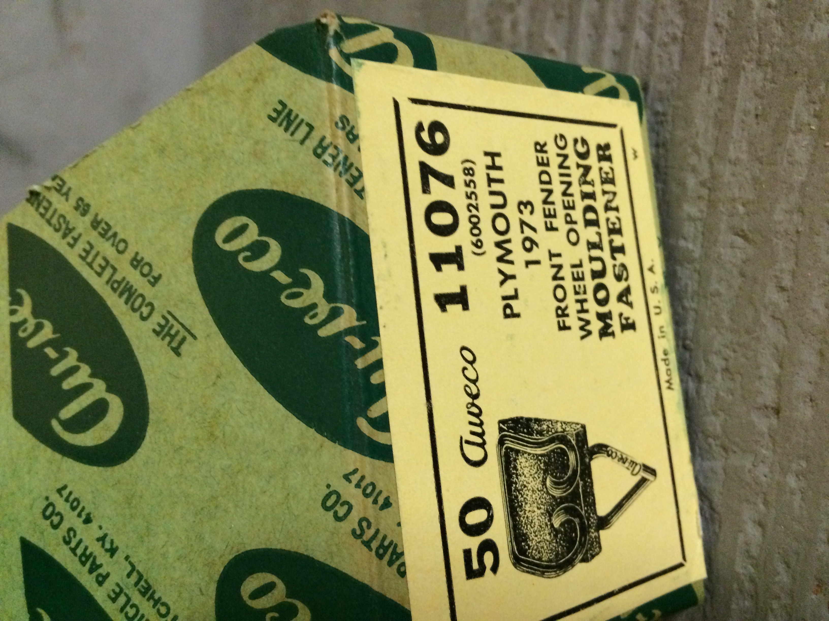

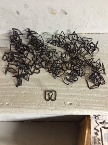

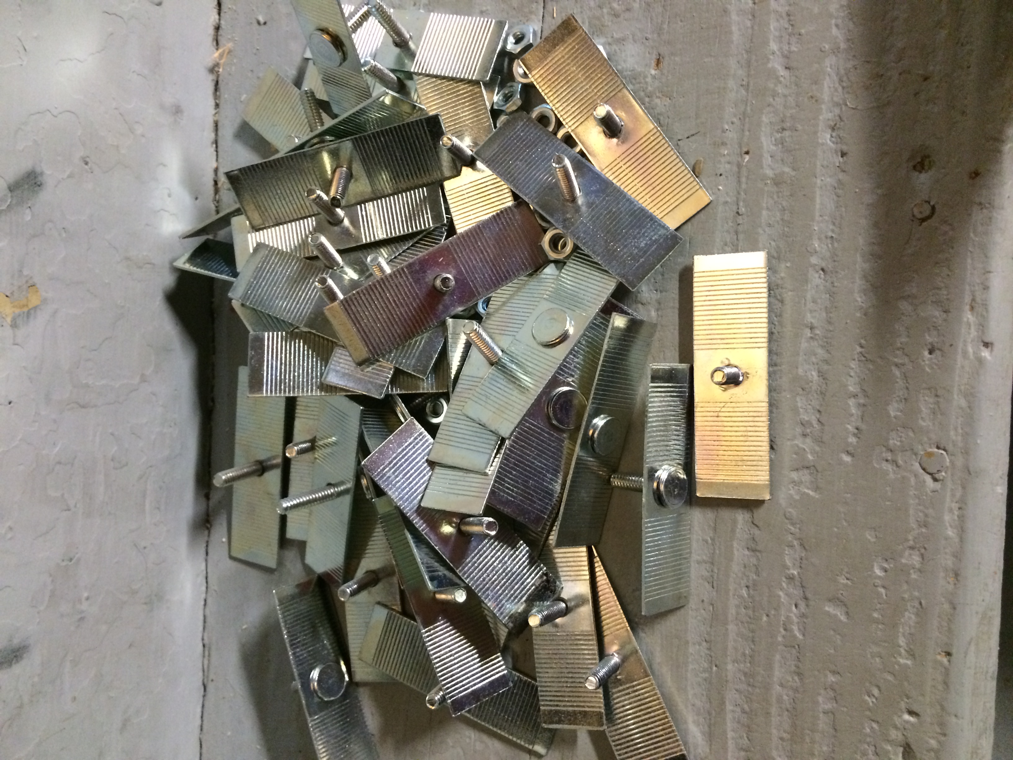

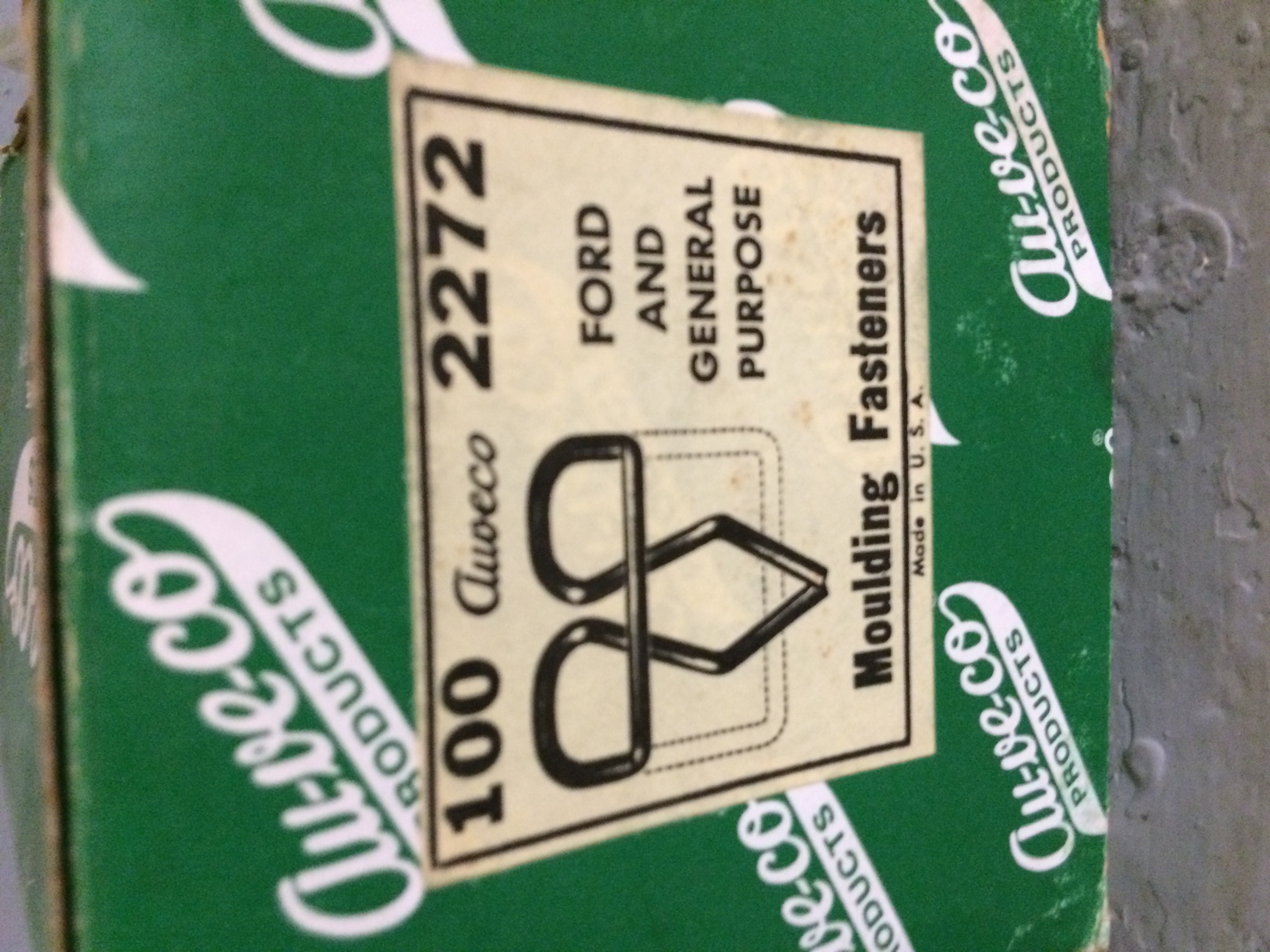

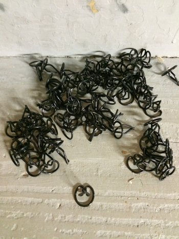

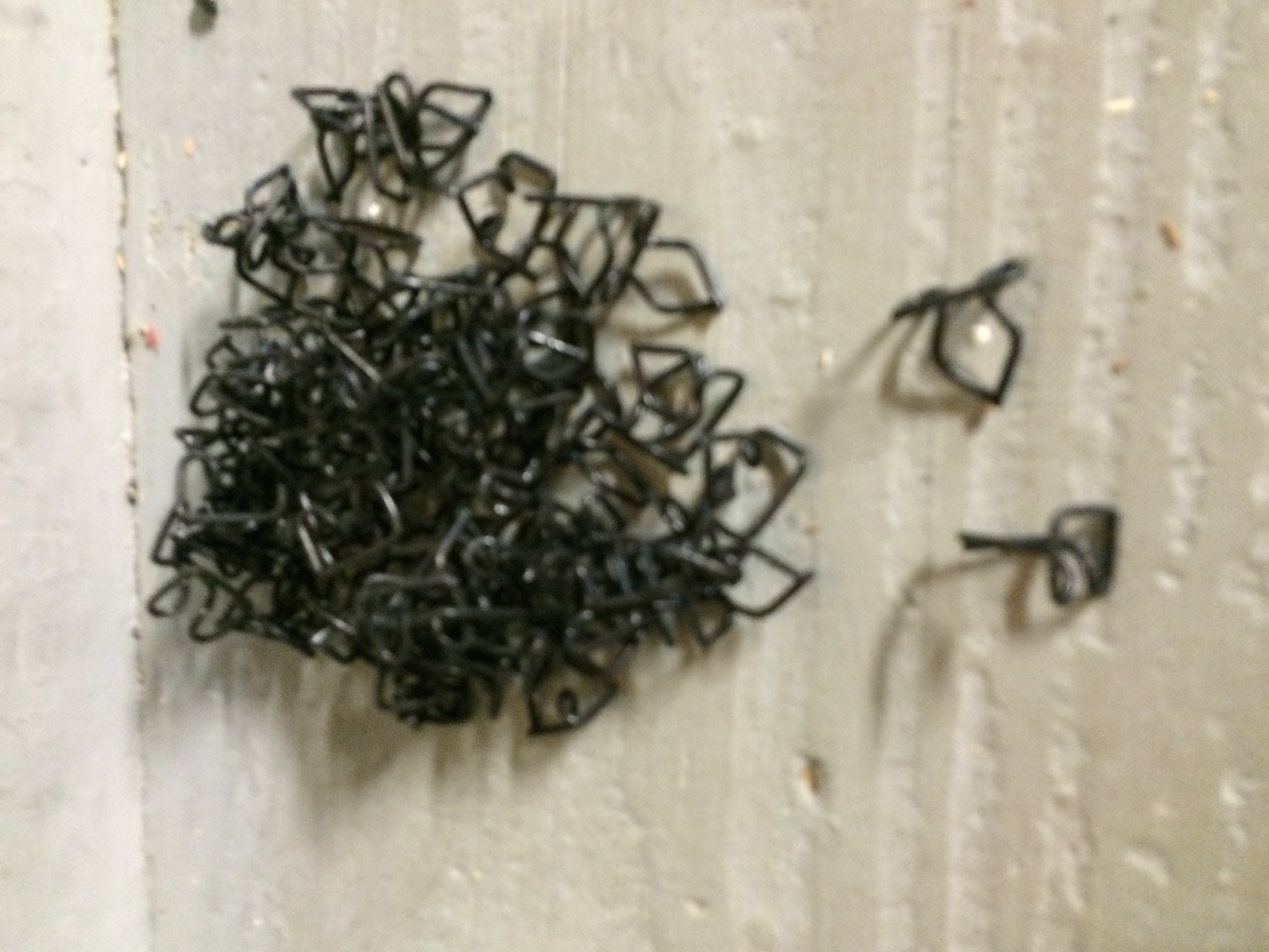

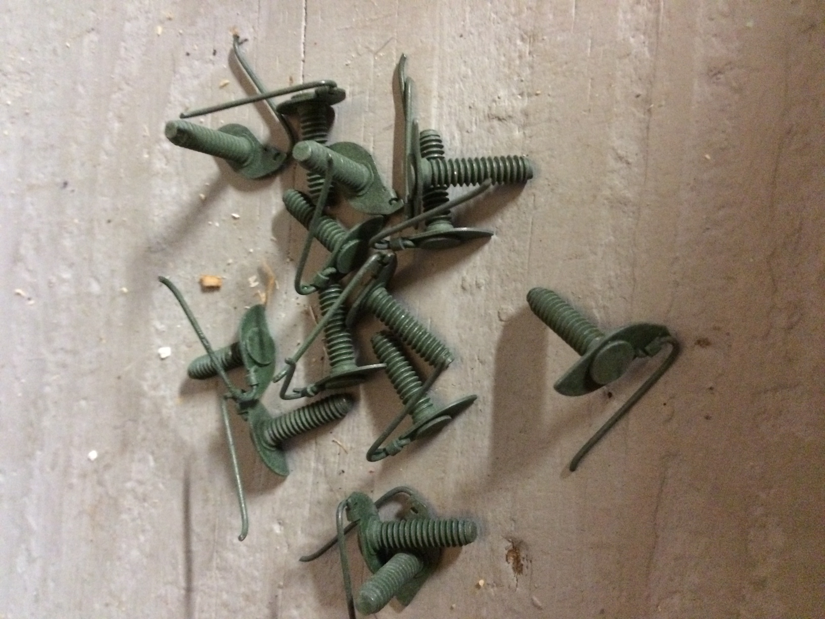

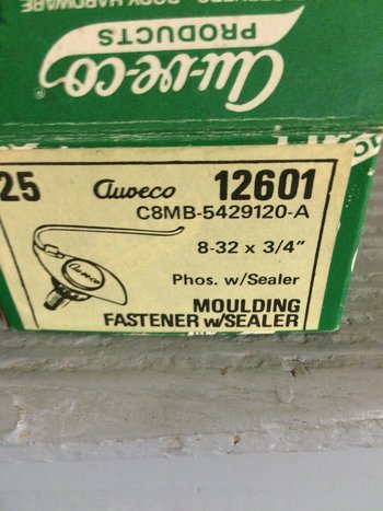

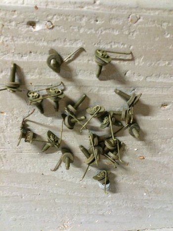

Bill had many clips left over after his restoration, and offered to sell them to me for the mere cost of shipping! A deal I could not refuse. Below is what I have - assuming I'm able to salvage some of the clips I remove, am I in pretty good shape? What will I need, that I don't already have?
Thanks

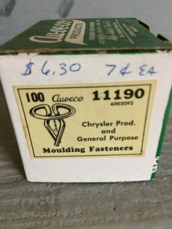

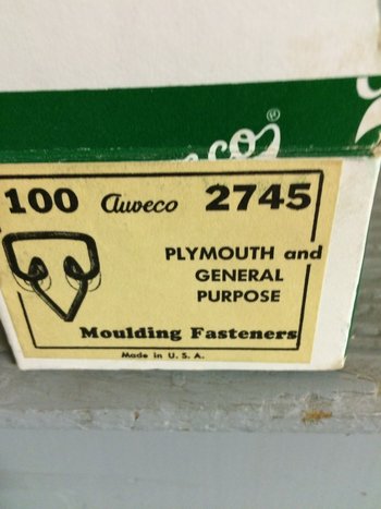

Oops - forgot to take a picture of the box

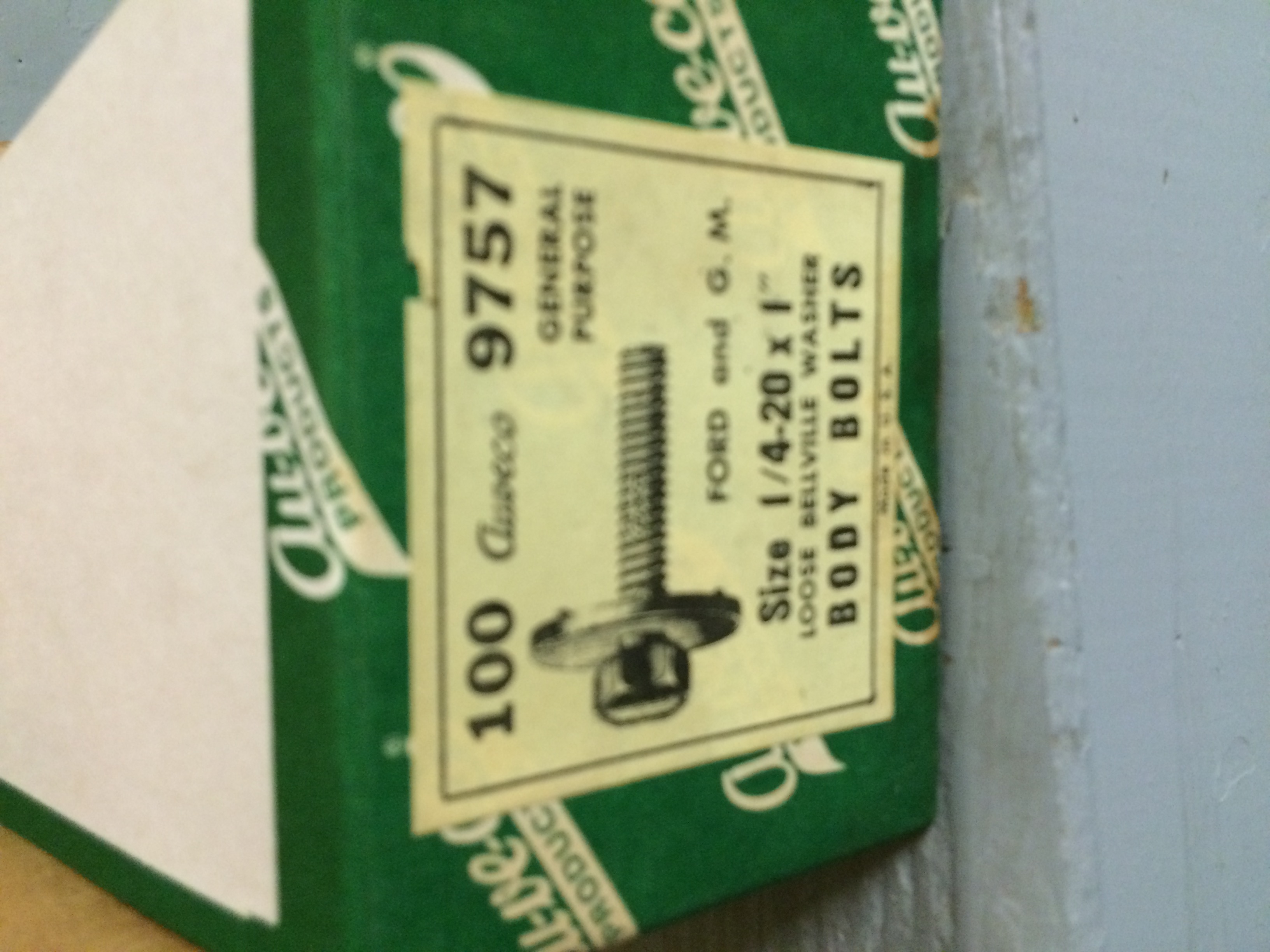

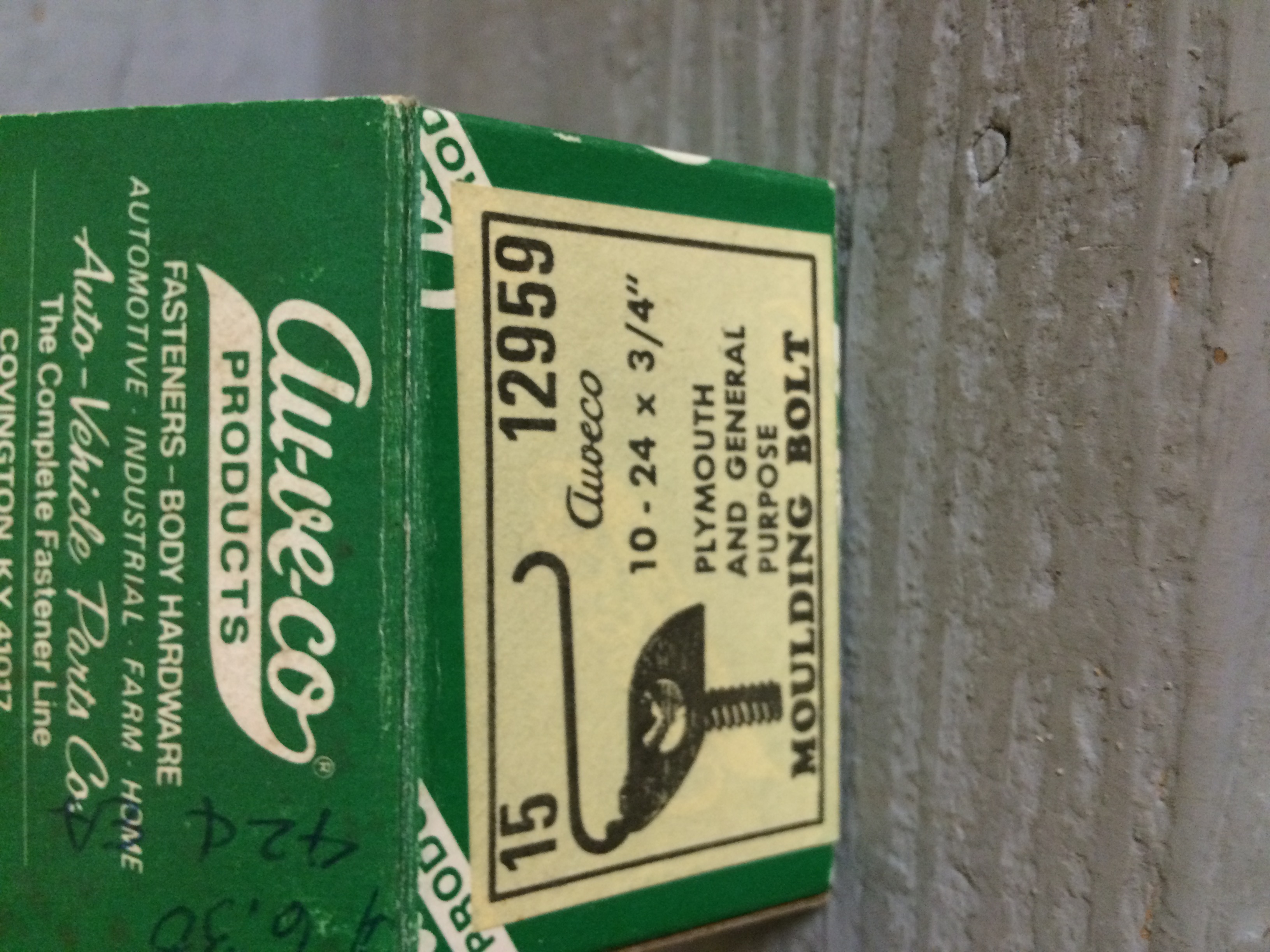

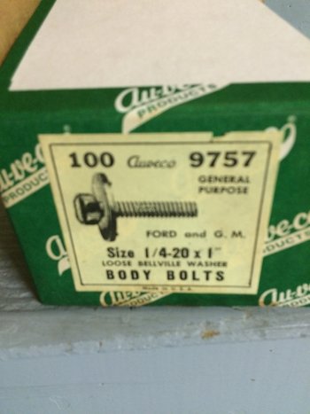

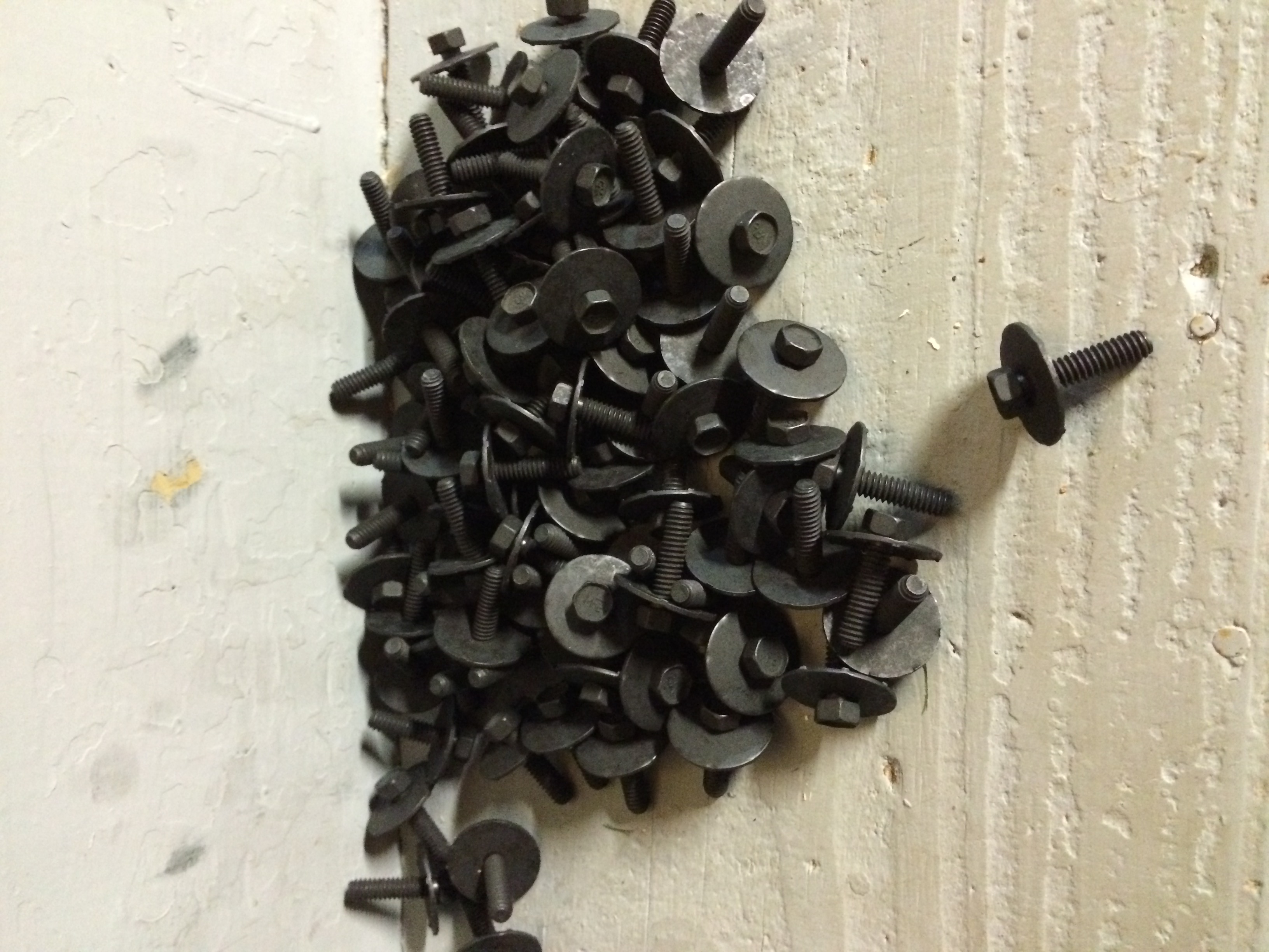

I don't think I'll need these, but not sure. I got a box of chrome bumper bolts too, if anyone needs some

Dan - You are sitting on a Fortune in clips. Lucky guy. Only thing you may need is the clips for the lower windshield and lower backlight trim. You can get those at http://stores.ebay.com/RJL-AUTOMOTIVE-FASTENERS?_rdc=1 and probably anything else you may need. Ace Hardware has a very good selection of automotive clips and stainless steel metal screws and machine bolts. Offer is still good on dent repair and polishing of the trim but it's been so long ago I can't remember the "favorable rate", it's still good though.
Posts: 2218
Re: Faulkner gets a redo
Dan - The front and rear clips for the glass trim are different.
