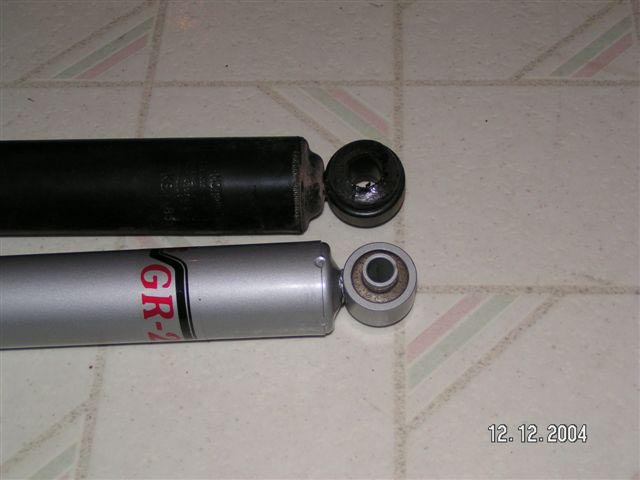

Roger wrote:My car's rear shocks are non-functional. I wnet to the auto parts store and they sold me on a pair of KYB gas shocks...($28/each). Please see pictures attached.
The new shocks have a sleeve/ bushing at the top mount which will not fit over the original frame studs. These sleeves do not appear to be removeable. I guess it is back to the auto parts store...sigh. Again I ask, if anybody out there has replaced their rear shocks, please let me know what fits!

I purchased a set of four shocks from Andy Bernbaum back in 2000. www.oldmoparts.com and they fit and work very well. His price today for our cars is $32.50 each or a set of four $115.

Several months ago I ordered my shocks from Rockauto.com for my 59 Sport Fury. They have an extensive online catalog, click on Plymouth, and then 1959, then chose your model and engine. All of the catagories of parts available for the car and motor will be listed. Under suspension you will find the available shock absorbers. They do not carry front shocks for 59 Plymouths, so I ordered the front shocks that fit my 65 Sport Fury, which still had the same shock tower as the 57-59s. Those shocks are Monroe 5811. You will have to trim the spacer on the bottom of the shock to fit the bracket on the lower control arm of any 57 to 59. For the rear, I ordered Monroe 58496 coil over shocks and they were an exact fit for my 59 Sport Fury; these come in a 2 pack and they include adapters to fit several other Mopars, but toss those. Rockauto.com does have KYB rear shocks for the 59's and you can use the 65 front KYB's.

I've gone ahead and ordered a set of four shocks from Andy Bernbaum.
Total cost was $115. Should arrive in one week. While the rear shocks are off, I tried bouncing the rear of the car...still very little movement. I will get the floor-to-wheel-well measurements and see if the car sits higher than typical..
