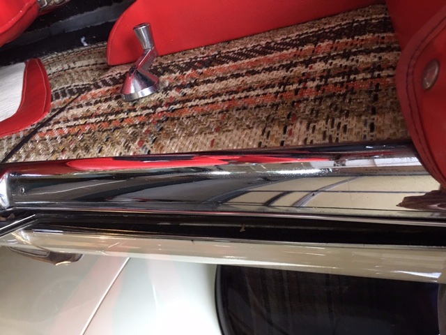

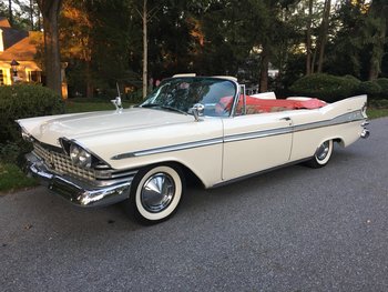

Plenty to do on her but can drive as is while I’m working on it. The plaid has got to go. Need a trunk lock, some issues with horns and turn signals. But a real issue is I can’t get the top to go back up!!! Any suggestions?

She's a beauty! Sounds like just a few minor things and she will be perfect!
