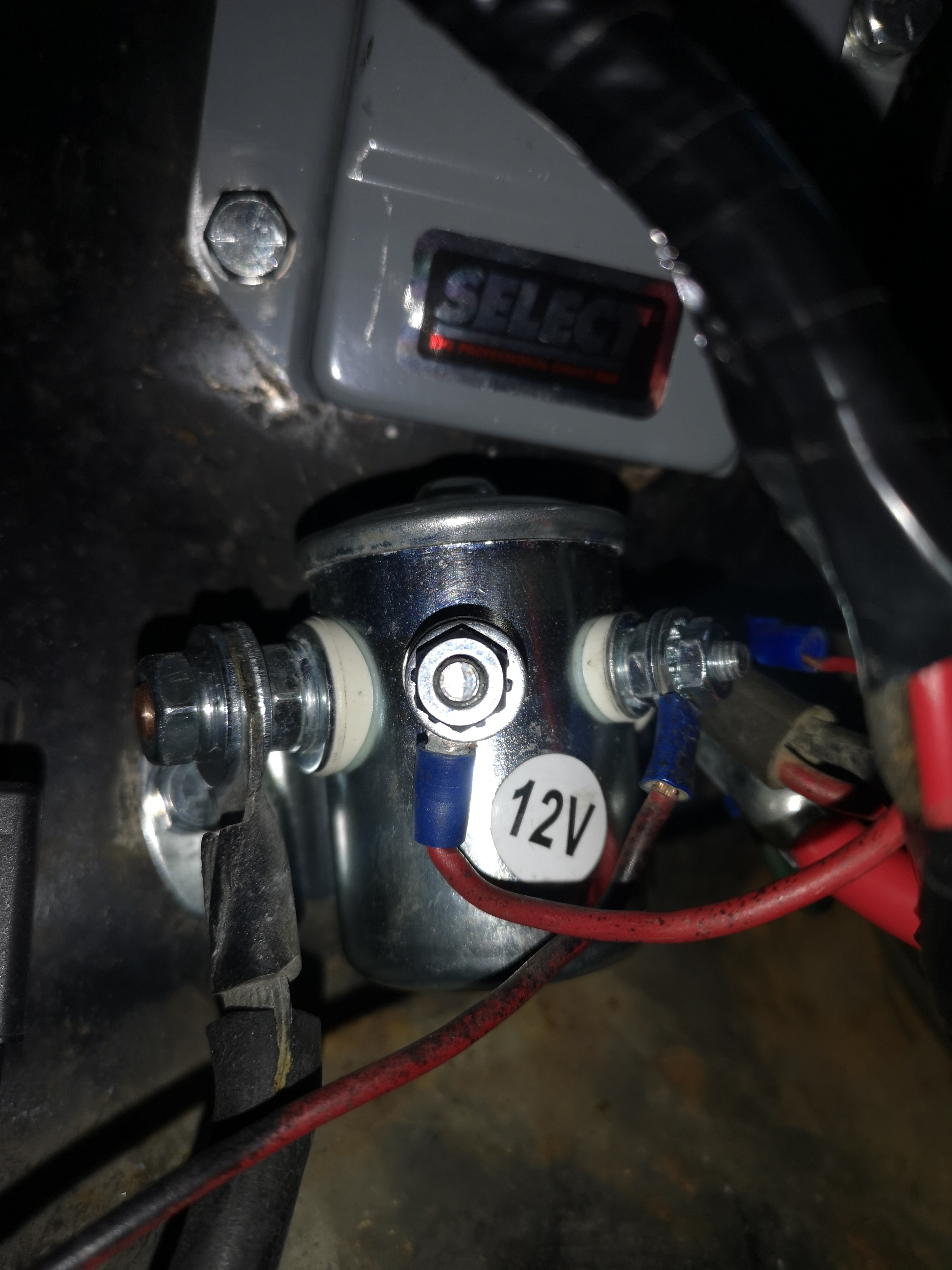

Well we stick with the heavy duty voltage regulator and three wire (batt and 2 field) alternator. I also purchased a new silver 4 post solenoid from Princess Auto.
Next will be to fix up all the wiring from that positive post on the solenoid
I will be doing a fused junction box for all the 12v lines coming of it.
As you can see a nice upgrade from the old solenoid and hard to see but about 7 wires coming off the + post.
