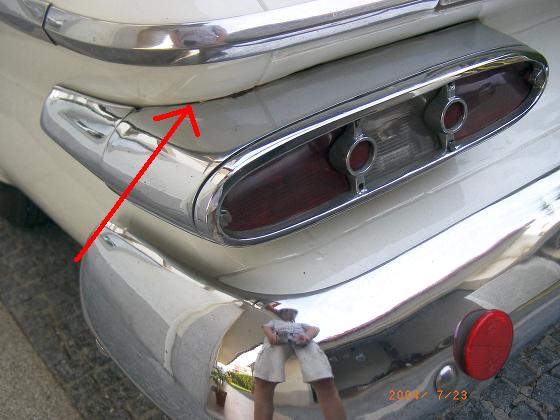

Hello group,
Does anybody know where I can get a new rubber band that goes around the taillights? (between the taillight and the body) I couldn’t find it at Gary Goers.
Thanks
Stefan

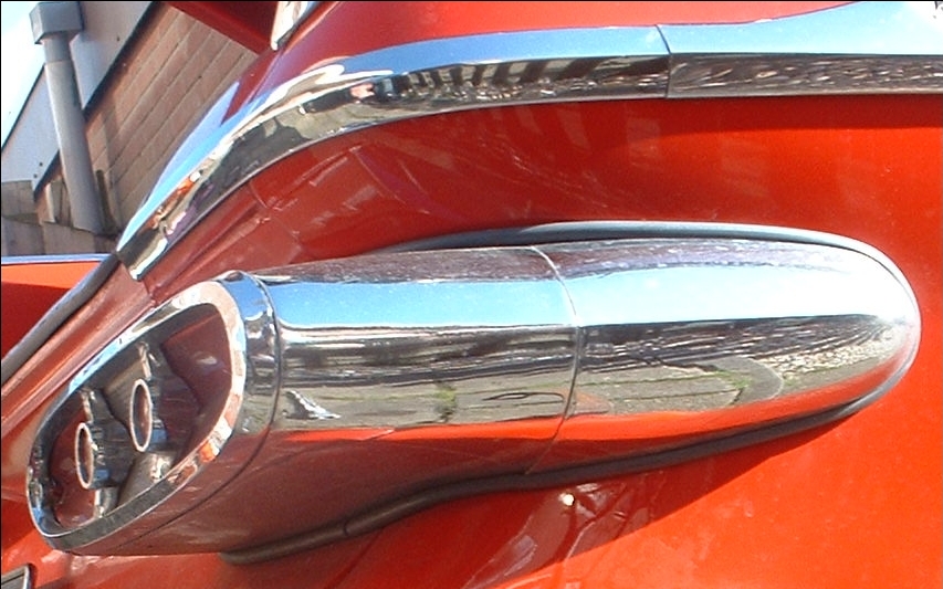

OK Stefan, here's the picture! And the stuff from Gary is really great, I oredered a lot last year and every item I recieved was perfect.

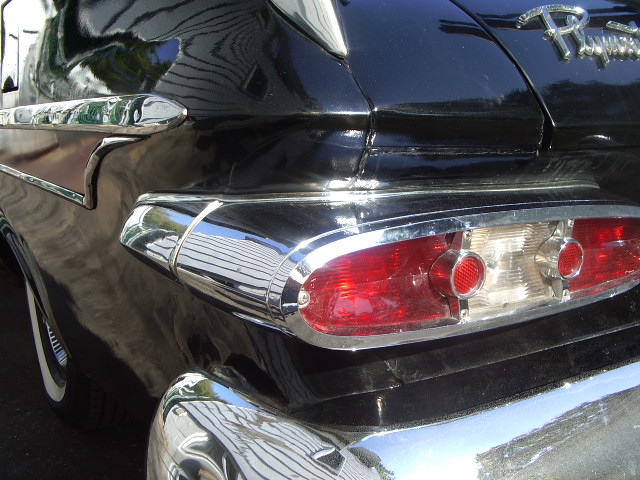

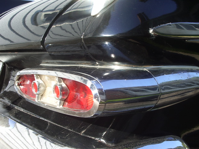

The "rubber band" on my tail lights was never all that great, so i decided to replace it, and i used the chrome door edge guard, its looks really good, will post some pics later!
Bob
Nighthawk
Posts: 454
Location: Toronto Ontario
Post by Nighthawk »
Heres the pics i took of my tailights using the chrome door edge guard
