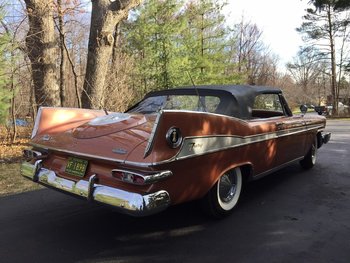

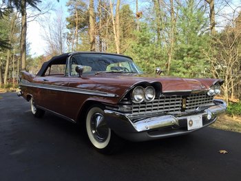

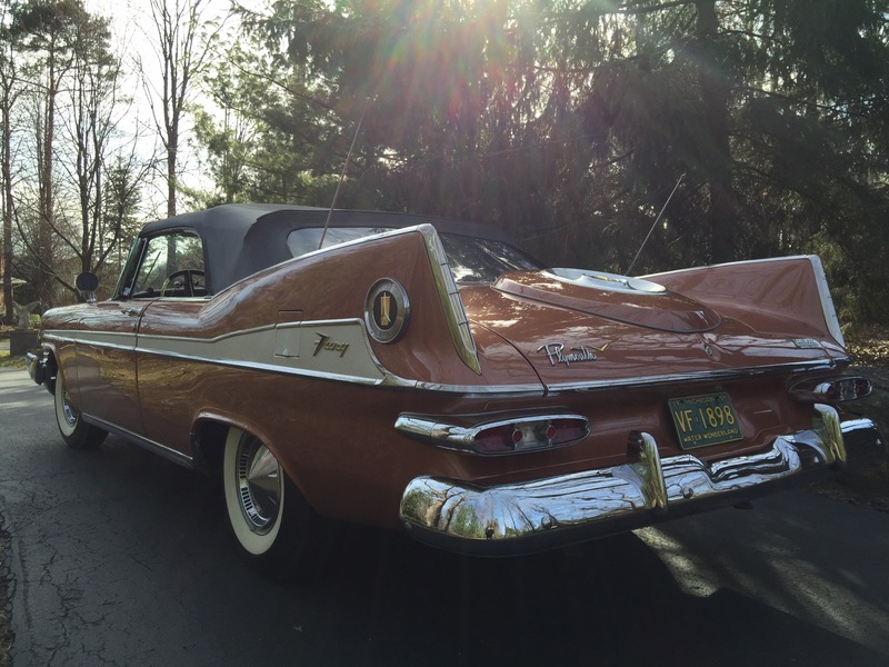

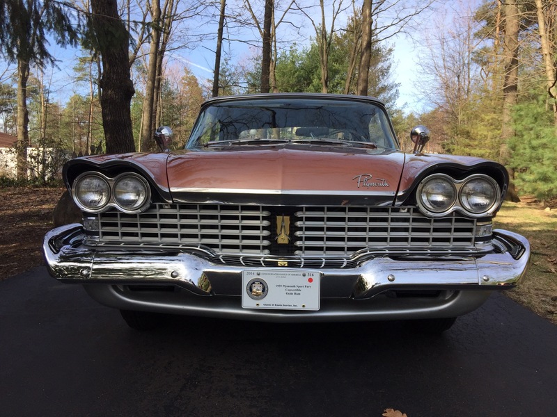

I must say that I see some flaws in a freshly restored car :oops:
Denver 59 Fin Convert
Posts: 2139
Location: Arvada, Colorado
1959 PLYMOUTH SPORT FURY CONVERTIBLE BRONZE METALLIC (COPPER
Theres always some in any restoration, the first one I found was the heater hoses on the firewall are wrong position, but in the older pic's they were in the correct position. Oh well..Easily fixed by the new owner.
I will have to look closer to see some of the other oopps that were made that Matthew spotted. The trunk does not count as that is all wrong with the carpet but the spare tire is neat with the period ribs on the side wall.
Matthew ,Please list all that you see wrong so the rest of us can see if our cars have the same faults so we can correct them. If we can fine tune our own cars it just makes them better with detailing points.
I just found two more issues, the VIN tag should not be painted body color, There is a strip of rubber at the top of the cowl that I have never seen on any other car before..
Posts: 5038
Re: 1959 PLYMOUTH SPORT FURY CONVERTIBLE BRONZE METALLIC (CO
Denver 59 Fin Convert wrote:There is a strip of rubber at the top of the cowl that I have never seen on any other car before..
I don't have one either - although, I believe it's in the Goers catalog...
duggar
Posts: 89
Joined: Tue Jul 11, 2006 4:48 pm
Re: 1959 Plymouth Sport Fury Convertible Bronze Metallic (Copper
Post by duggar »

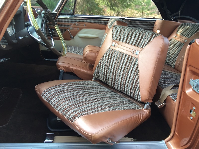

The dash pad should be dark brown not copper color.
Matthew Keij
Posts: 1407
Post by Matthew Keij »
I will have to look at the pics again for all the things.
From a quick look at the pics posted here:
As mentioned the dash pad color
The rubber strip on the cowl should be in the hood
Heater hoses are connected wrong
Interior is correct but ALOT of wrinkles
The boot where the top lowers in should be black
